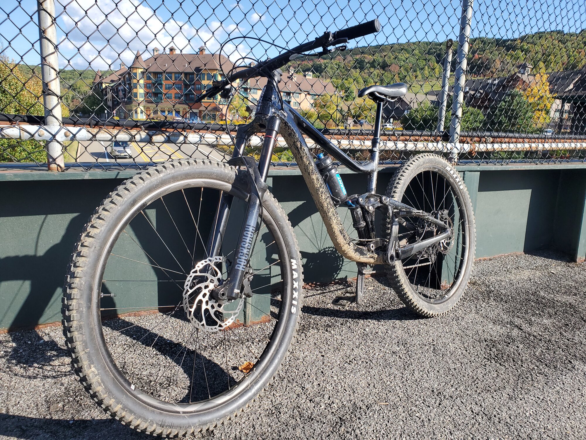

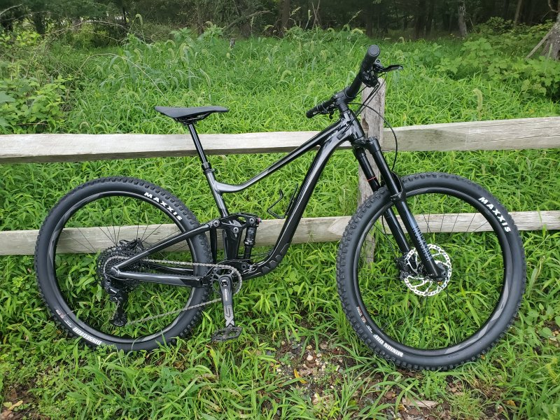

Then I got to thinking - why not just convert one of my acoustic bikes to electric?
So, that's what I'm planning to do with my 2021 Giant Trance X 29
This bike has a BB92 bottom bracket (press fit). Planning to go with the CYC X1 Pro Gen 2 OR the X1 Stealth motor, as they have great fitment options for this bottom bracket size, and it will keep the chain line straight.
More than likely going to mount the battery (52v) on the top tube, as there isn't enough room inside the triangle based on the templates. I might be able to mount the battery on the bottom of the down tube, but don't want to risk any rocks being kicked up and damaging the casing, although I've heard they are pretty tough.
