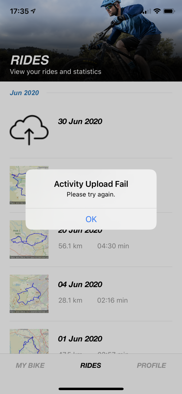

A new app problem for me “Activity Upload Fail” after a ride today. Giant App also kept crashing (iPhone) when I tried to open previous rides.

I got that same message on my Android phone on Sunday's ride. Also use Map my Ride, so will stick to that for now

Other than that, sorry, but I can't help with the uploading of rides... I don't use that at all. The usual advice is to reboot the iPhone and restart the app. And if that doesn't work, then make sure you have the latest version of the app.

Hmmm...I got the 'can't upload try again' error as well. Maybe their servers are down, or full, or whatever. Geesh.

I have had this happen as well. Just waiting a little bit or making sure I have a good WiFi signal has allowed me to download. This isn’t a tech smart answer but it seems to work. 🚴‍♀️
I like your answer @Browneye... perhaps that is it. My WiFi and cellular at my location is sketchy so I just assumed download failure was due to that. 🚴‍♀️
Upload is not the same as download. After failing to upload several times, my ride just disappeared :mad:.
Now fixed thanks - I switched on the bike and connected it to the app, then tried download again, and it worked this time. Could be coincidence, but maybe it prefers the connection to the bike in order to work properly!
Yes, you need a login account for the app, and it has to connect to a ebike. Or it doesn't work. 👍
