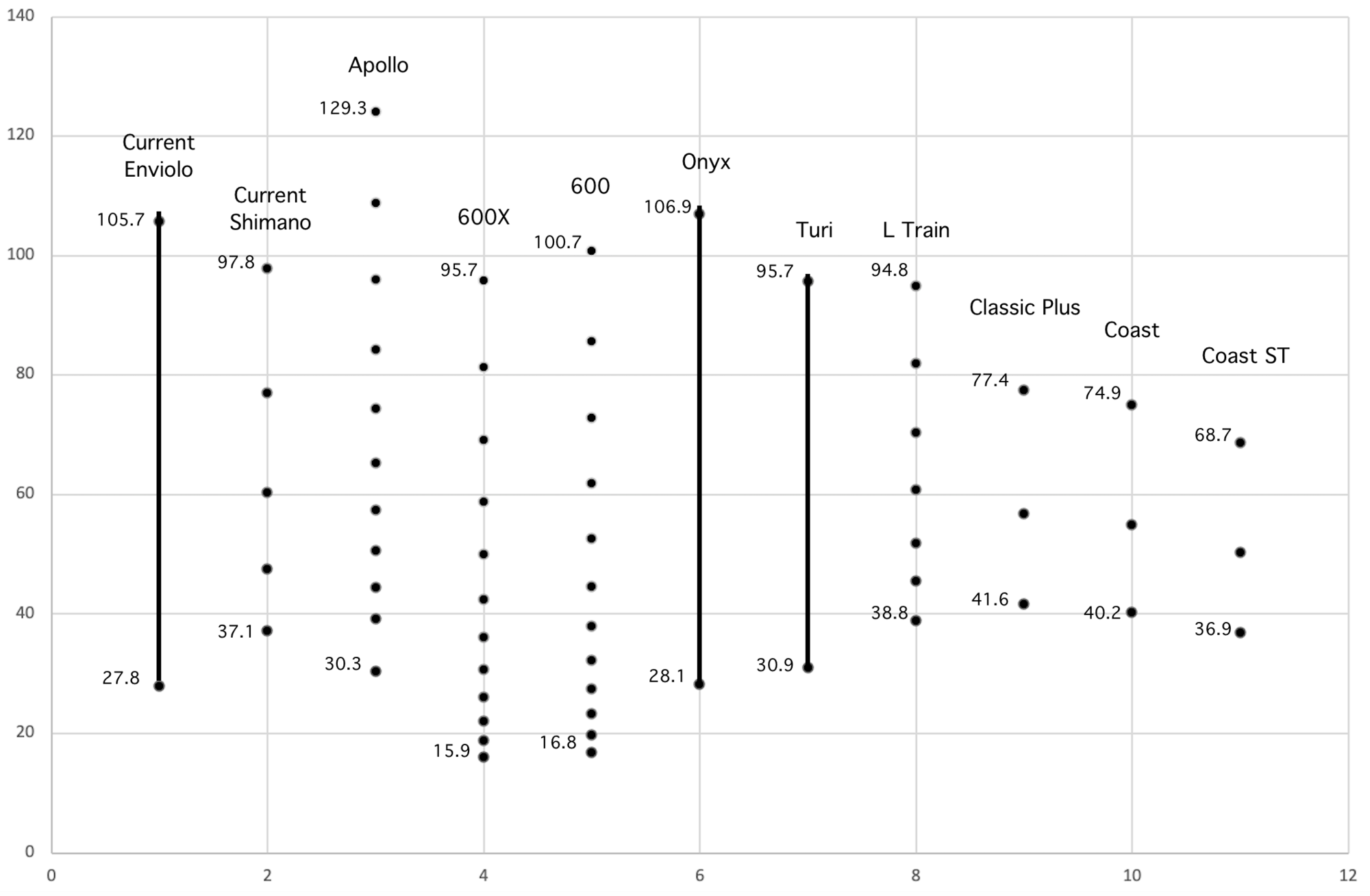

Thanks for posting the link to the Gear inch range chart... very useful information. ;)
I think this chart is in error WRT the Enviolo hub. The Current with this hub has a 55/22 gear set (2.5:1). The hub specs out at 0.5:1 full underdrive and 1.9:1 max overdrive. 2.5*0.5=1.25 wheel rotations for one crank rotation. With a 27 inch dia wheel then the gear inches is 27*1.25=33.75 gear inches minimum. 2.5*1.9=4.75 times 27=128.25 gear inches in full overdrive. (or I don't understand gear inches). It will be interesting to see what people get with the Shimano hub (the gear ratios are known but not the gearset).

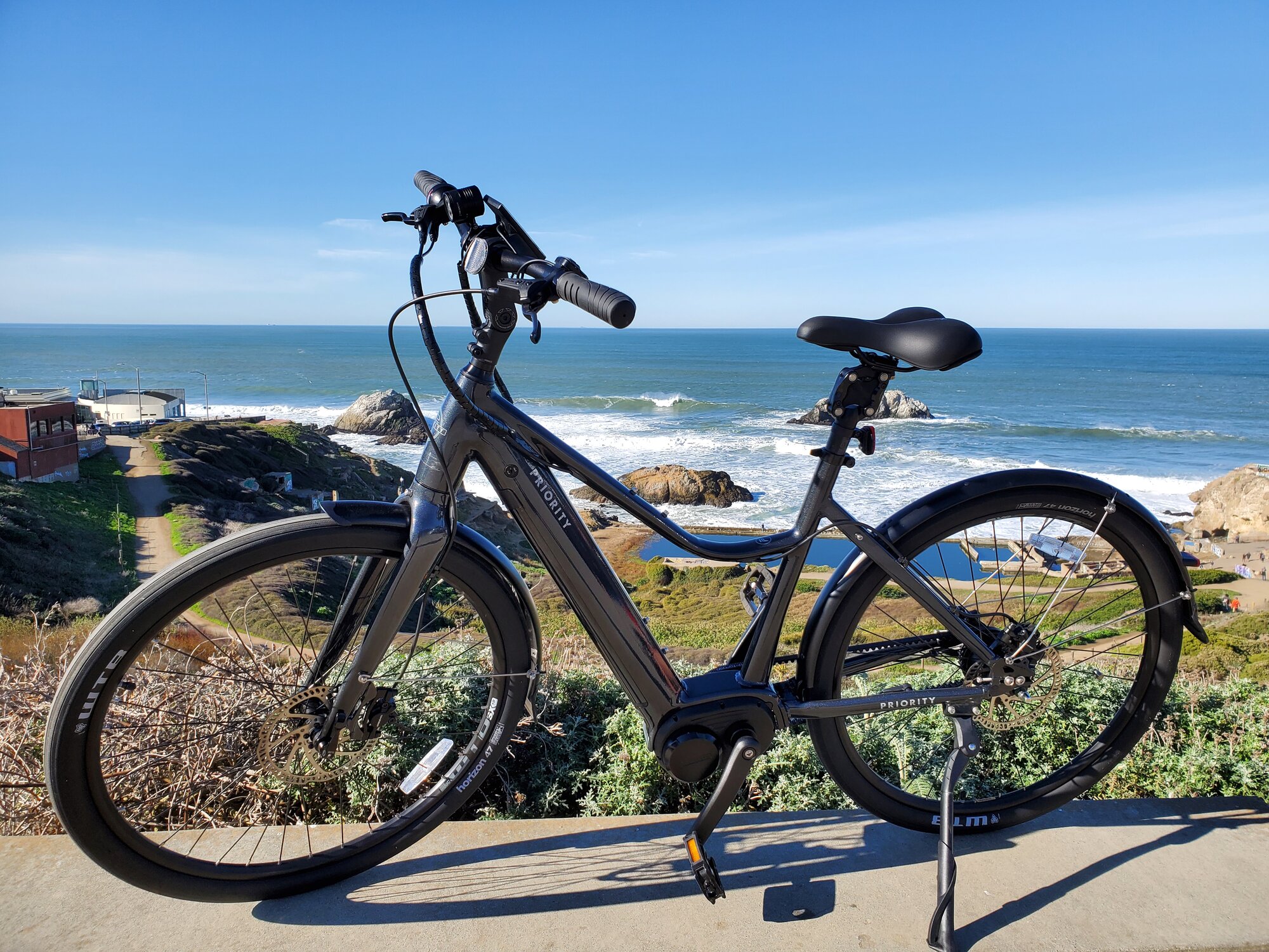

Bonus Current pic:
I am into my 9th month as a Priority Current owner. The Current shares ride time with an Aventon Pace 500 & AVenture. Riding the current is a seamless experience because of the belt drive and Enviolo shifter. More than the other two, it is a bike with pedal assist. I have “0” zero maintenance problems. If I have one criticism, it is the range. The battery consistently gets 30 miles between charges in hilly Lancaster, PA. If I use it in coastal New Jersey, I can get 40-45. So, I got a second battery.
