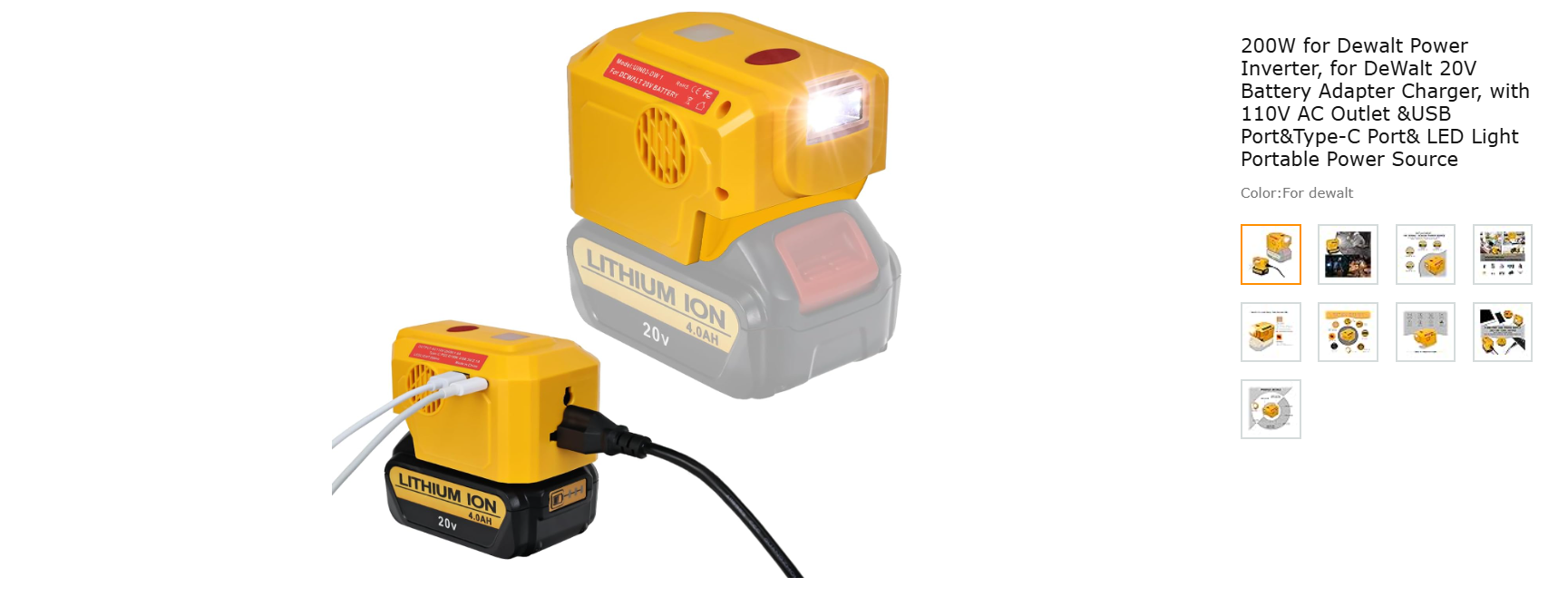

Why not spend the money on a cordless tool battery instead of a power bank? You could use one of these to convert to AC for your charger. A tool battery will provide enough current without overloading anything.

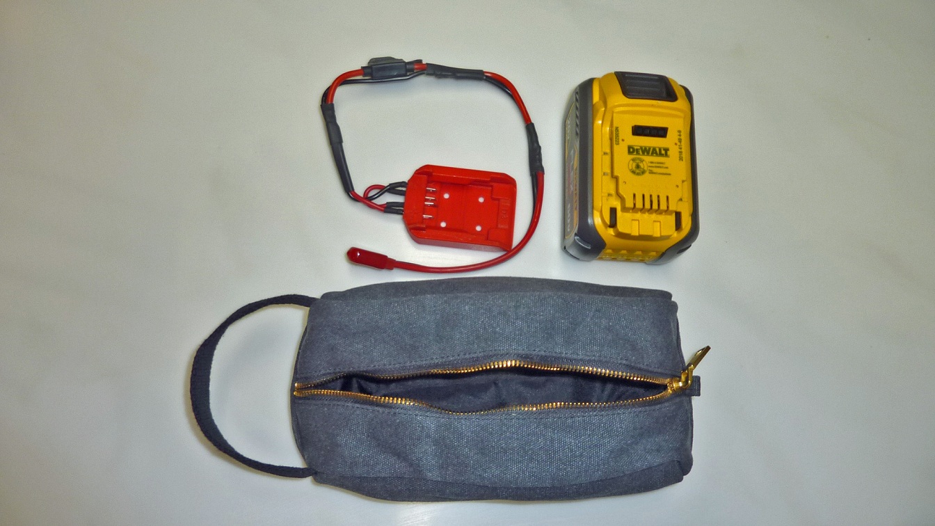

Or, a more efficient way would be to use one of these, and direct wire the DC tool battery to the bike:
I use DeWalt batteries for my tools, so I always have them around. Similar adapters are available for other battery brands as well.
This way, you don't have to wait for the charger to charge the bike battery, or even carry the charger at all..

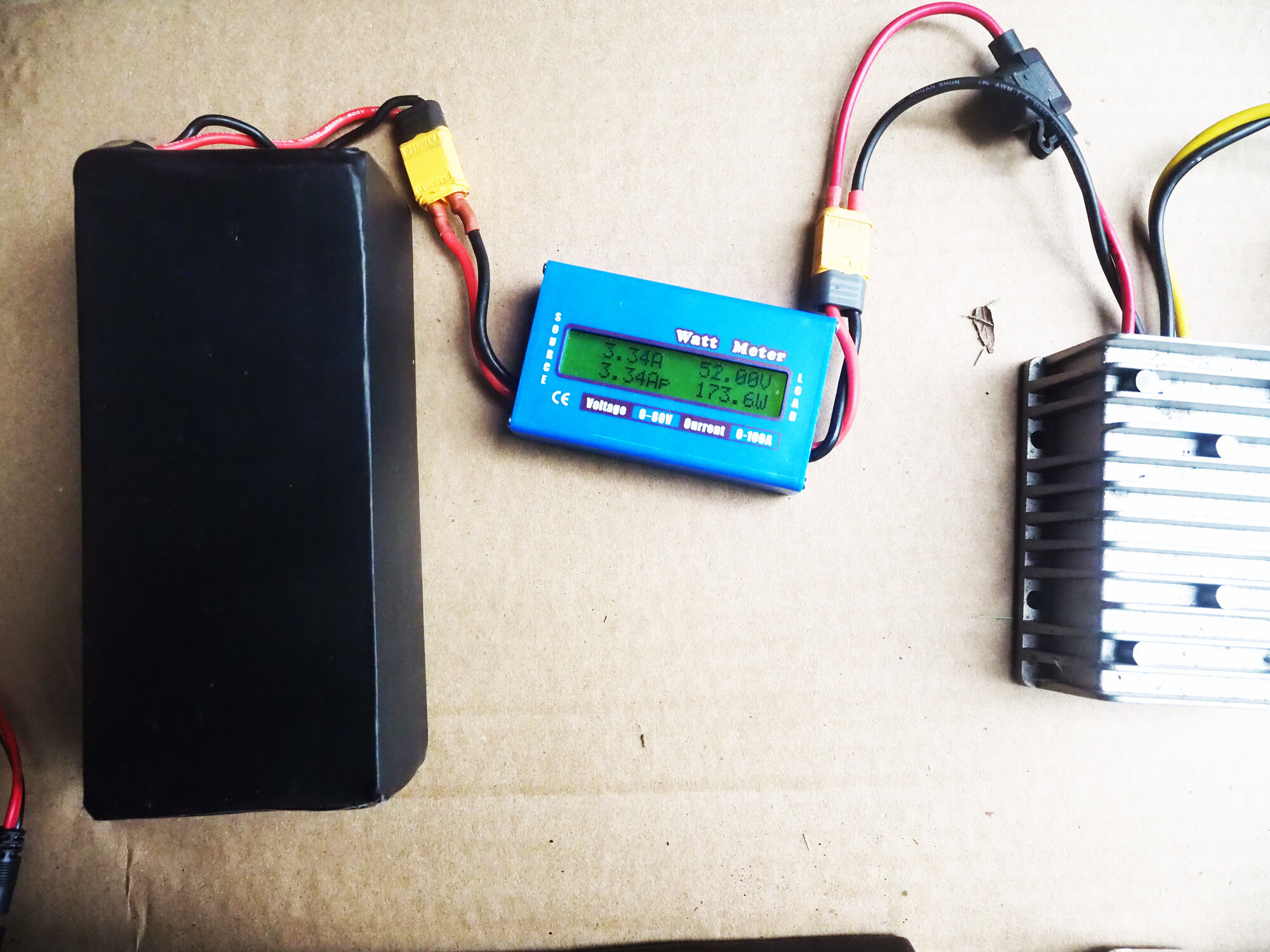

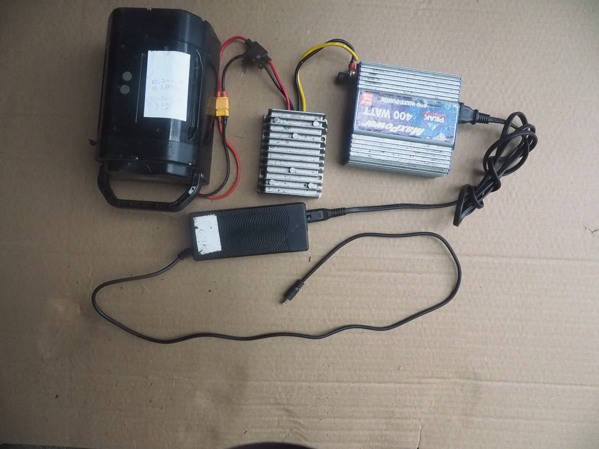

Here's my version of a powerbank. You got an ebike battery on the left, powering a 48V-12V golf cart converter in the middle. On the right is a 12V-110VAC inverter. On the bottom is an ebike charger plugged into the inverter,
The charger puts out 2.5A at 48V. In this subsequent picture, I put a wattmeter after the battery. I found it measures 3.3 amps out of the battery at 50V.
To a rough approximation then, the efficiency is 25/33 or 75%, better than I expected. Perhaps an active EE can find something in my experiment that I forgot. I'm just a retired one.
... the efficiency is 25/33 or 75%, better than I expected. Perhaps an active EE can find something in my experiment that I forgot. I'm just a retired one.
cool experiment. and essentially exactly the efficiency that i predicted based on the most common transformers out there!
In my case, I get around 19 miles from a 4AH, 60V tool battery.
Direct wiring the DC tool battery to the bike sounds like the best way to go-- I love saving weight, love it, love it!
But to make it safe, I think I'd want to solder a the appropriate female cable adapter to the cables and rig some kind of harness for the tool battery and adapter. The move, I guess, would be to unlock the primary battery when it was dead, throw it into a small backpack, and then strap the tool battery/adapter somewhere secure before plugging it in to give me juice for those last few miles home. Great stuff, guys! NOW it's time to bring in @PedalUma, and see if he thinks it's possible to rig this kind of cable adapter for the TSDZ2.

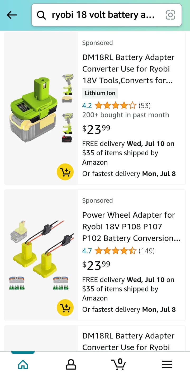

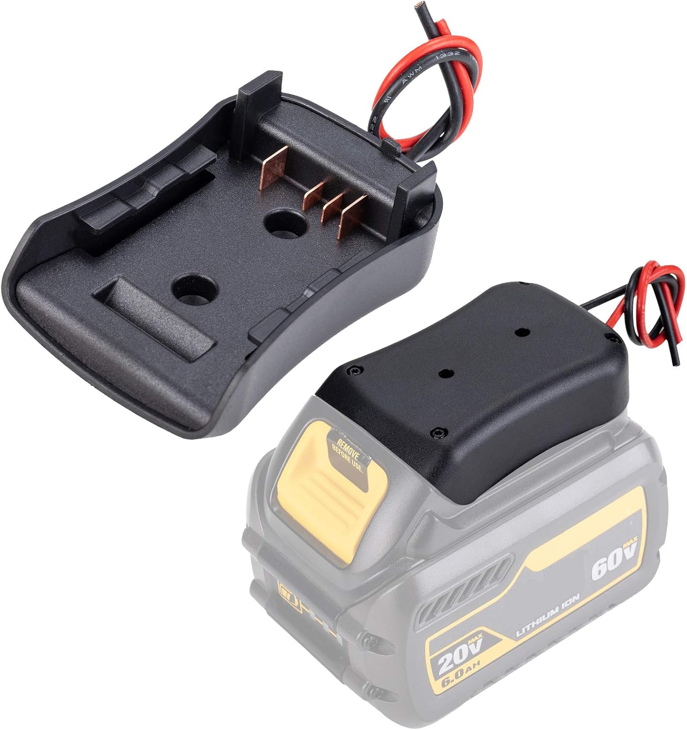

Thanks for your post !!!
I've been struggling to make a connector to plug my tool batteries into.
I thought I had to sacrifice a tool to scavenge the socket from it.
I just found these on Amazon,..

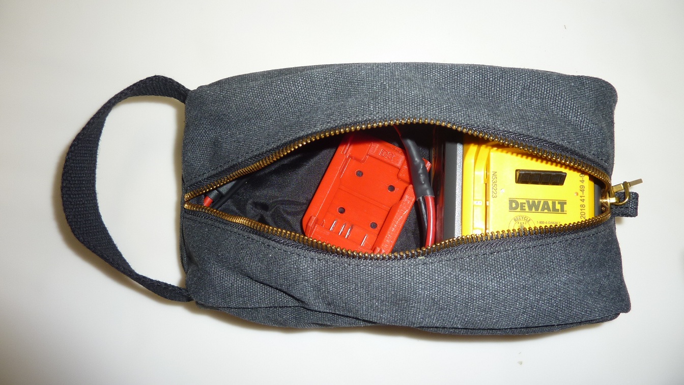

Many of my bikes use Anderson connectors so I made up a jumper cable to use the tool battery. Something similar can be done with almost any connector. The parts fit neatly in a canvas tool bag for a bit of protection. The whole kit weighs less than 3 pounds.
Tool batteries are built for rough handling so I'm not worried about damage. I just throw it in my rear rack bag, pannier or hang it on the frame somewhere on rides where I think I may need it:

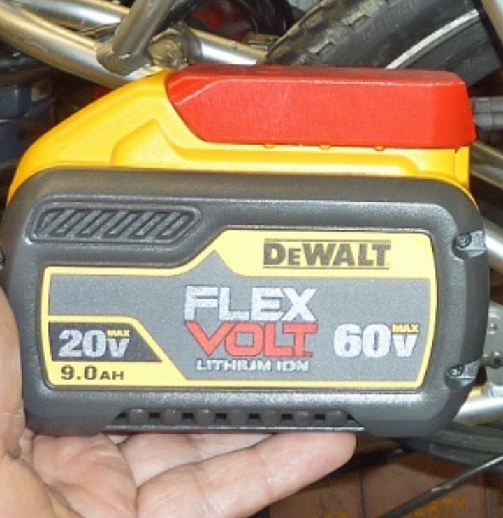

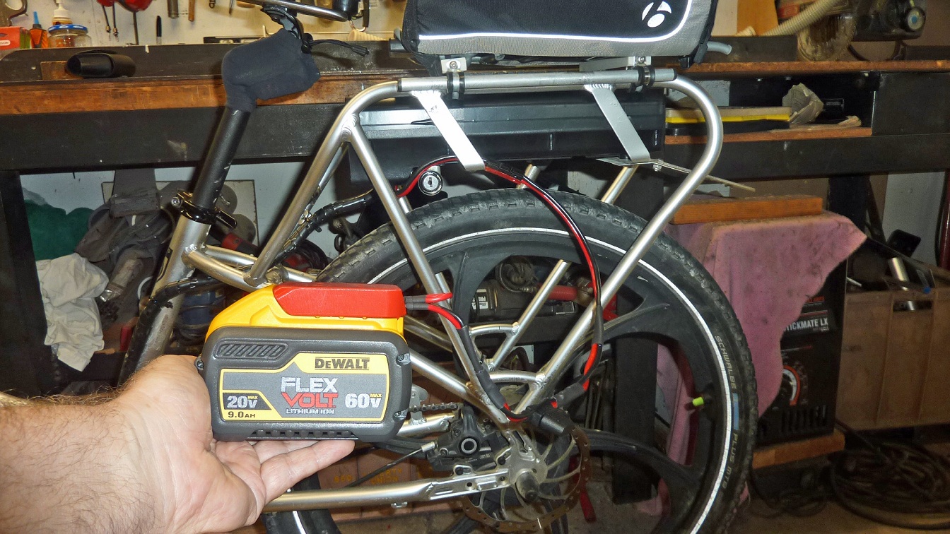

What have you got here??
Does that battery flip between series and parallel to provide two different voltages ??
Yes, it's one of the DeWalt Flex Volt batteries that will switch between 20V and 60V. The 9AH rating applies to the 20V configuration. It's just 3AH at 60V.
There is a newer 15AH version which will supply 5AH at 60V.
Quite pricey but It does dual duty with my collection of DeWalt tools though.
