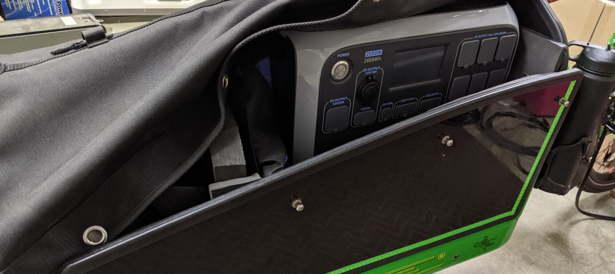

Here is my 2000wh SoGen in the cargo hold of my Bullitt. This 60+ lb monster was there only to be transported home after Amazon delivered it to my office. Its battery is smaller than the one built into the bike and the SoGen as a package weighs like triple that battery. One of its uses IS to charge up my trails bike from a campsite (along with folding solar panels... that weigh 14lbs x 3) but I sure don't ever intend on carrying it along with me ever again.
