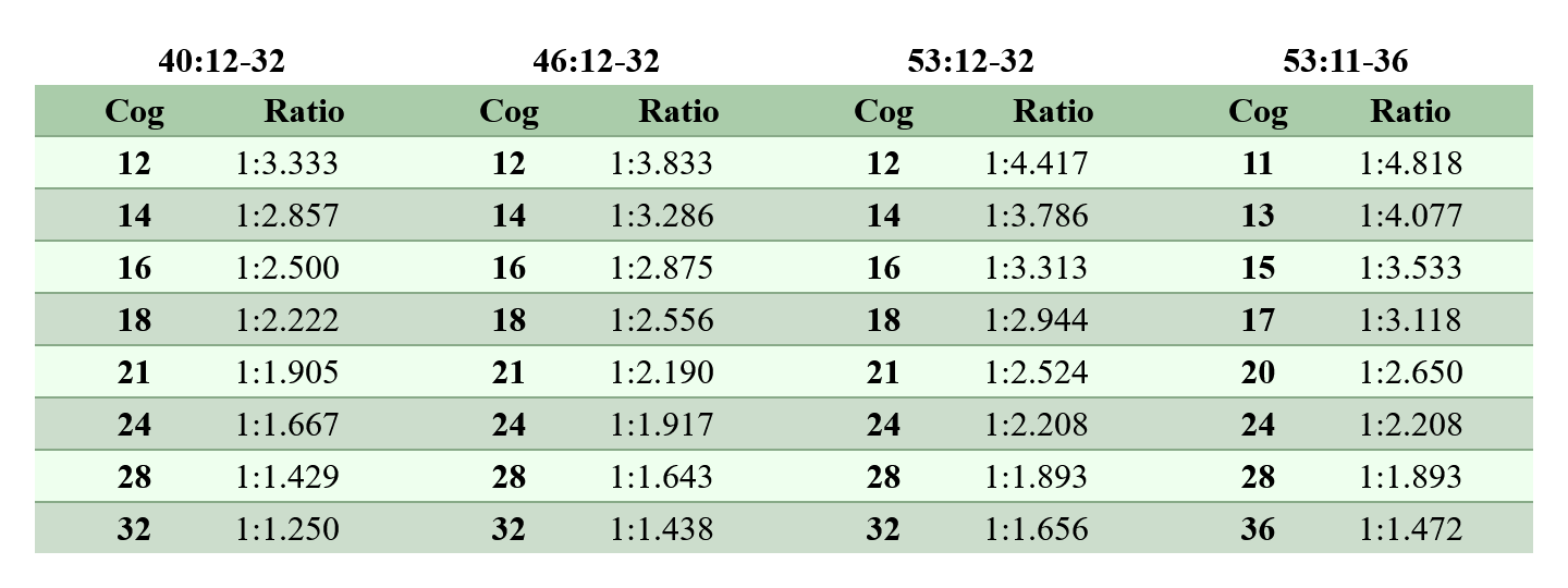

When I got my Aventure one of the first things I noticed was the highest gear was weaksauce, and the lowest felt way WAY too low for me. The proverbial feet going like crazy to give my ass a ride.
So I put the largest cheap chainring I could find that fit around the chainstays, a great big old 53 tooth.
It confirmed a suspicion, and the past few months has proven me wrong on another.
The confirmed suspicion is that the highest gear ratio was indeed too weak. 46:12 on a 750 watt motor came up short which is why my feet were going like crazy at the top speed instead of a more comfortable rate. 53:12 was better, but it felt like there was still a hair more wiggle room.
Where I was wrong was on the low end. And I discovered this the most painful way -- accidentally running the battery out because I got lost on a path I don't normally take. Unpowered -- something I really hadn't done with it to that point, 53:32 is not conducive to an enjoyable ride on a 70 pound bike with the drag of the motor on it.
So I grabbed a cheap 11:36 cassette.

The biggest hurdle was that the Acera is only really rated up to 34 tooth cogs, but the extra diameter was easy enough to get working by simply inserting the B screw the whole way. I have a couple derailleur hanger extensions in my parts bin, but I didn't want to resort to that if I didn't have to as that too seems a bit... sketchy... Just more possible points of failure. I also think my swapping the large 13 tooth plastic cogs on the derailleur for 11 tooth aluminum ones gave enough extra spacing for the larger cog.

I ran it up to top speed -- a nice clean 35mph -- and I still wasn't really struggling, but at least it still felt like there was tension on the cranks meaning I was going more muscle than motor. Which honestly is to me what an e-bike should be, even in the highest assist. It's called assist after all.
I also test rode it a quarter mile power off, and 53:36 is way better than 53:32. I could do that for miles if I had to. Which is good since I'm thinking on building a camper trailer and going a wee bit further out into the world.

Overall it pedals smoother than it ever has -- that's probably just dialing in the limits and index -- and so far at least the gear range feels more natural and fits my riding style better. And since the second highest gear is 32T, in PAS 3 I can do the nice leisurely 18-20mph I had gotten into the habit of when trying to go longer distances.
