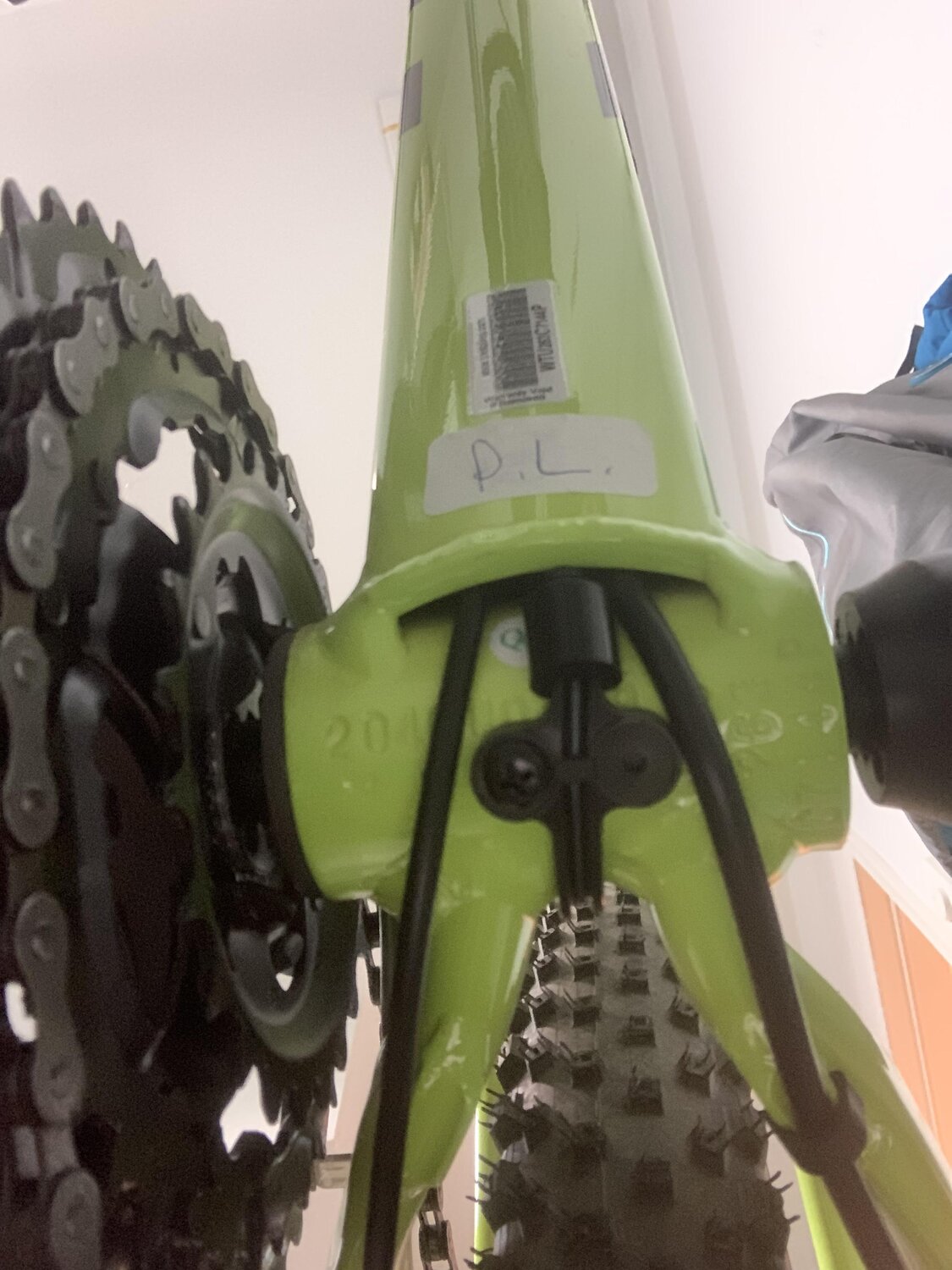

Taking just a quick look I see that there is an option of motor cut off brake levers or stick on inhibitors. If you have hydraulic brakes or even mechanical disc brakes but want to keep your stock levers the stick on inhibitors are the ones to consider requesting. Since you don't have experience working on bikes and there is no reason to hurry their "less than 1 hour" installation is optimistic, especially if you have bike specific issues like interference from a cable guide on the bottom of the bottom bracket which could interfere and need modification. Otherwise it is a reasonable time estimate if you don't hit any installation snags, or at least it was for the Tongsheng mid drive.

Not sure if this is applicable to the Bafang but when installing the Tongsheng on my Dahon Jack it hung up on a burr in the bottom bracket (where there is a tapped hole for a support when the bike is folded). Even though this hole is specific to the Jack I think this hanging up is fairly commonly reported, especially with aluminum bottom brackets. I used a half rounded file to remove the burr, careful to not damage the threads at the ends of the bottom bracket. Then the motor slid right in.

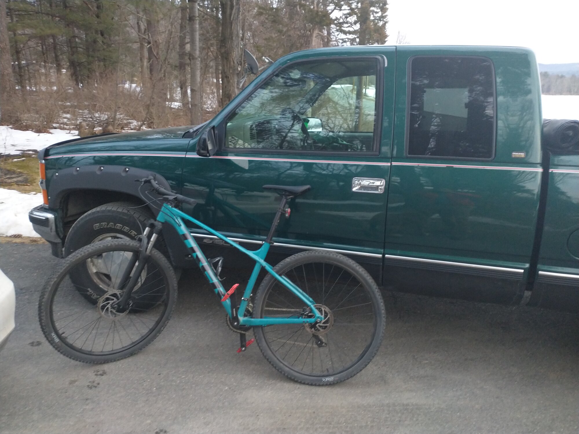

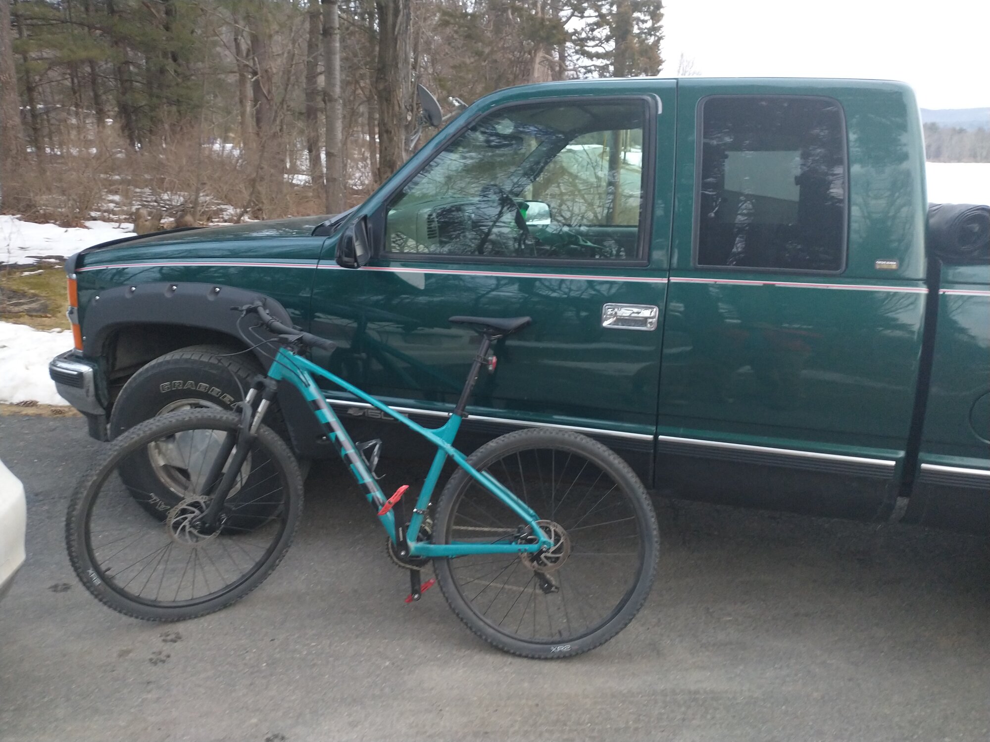

How did this build end up turning out? I happen to have ordered a Marlin 5 as well, which I plan to put a BBSHD kit on. Anything I should look out or prepare for?
Best advice, Google “ Marlin 5 bbshd “ Often DIY mid drive fans post build threads. And share any trouble spots and issues. I did and you’re golden.
That's exactly how I ended up here :D. I did a bunch of research - loads of converted Marlins out there indeed. Thanks!
There's been a lot of hiccups, but the build ended up fine. I needed some spacers for the chainring to keep it from rubbing into the frame. I have both of these spacers on it:
I think that there are different spacers for the BBSHD than the BBS02, so make sure you get the right ones.
I got the Lekkie Bling Ring 42T chainring as well.
Make sure your rear derailleur is set up really well. Have a local bike shop check it out if necessary. I took a private bike maintenance lesson at a local bike shop with the ebike this past week, and once we nailed the rear derailleur setup it was so much better.
