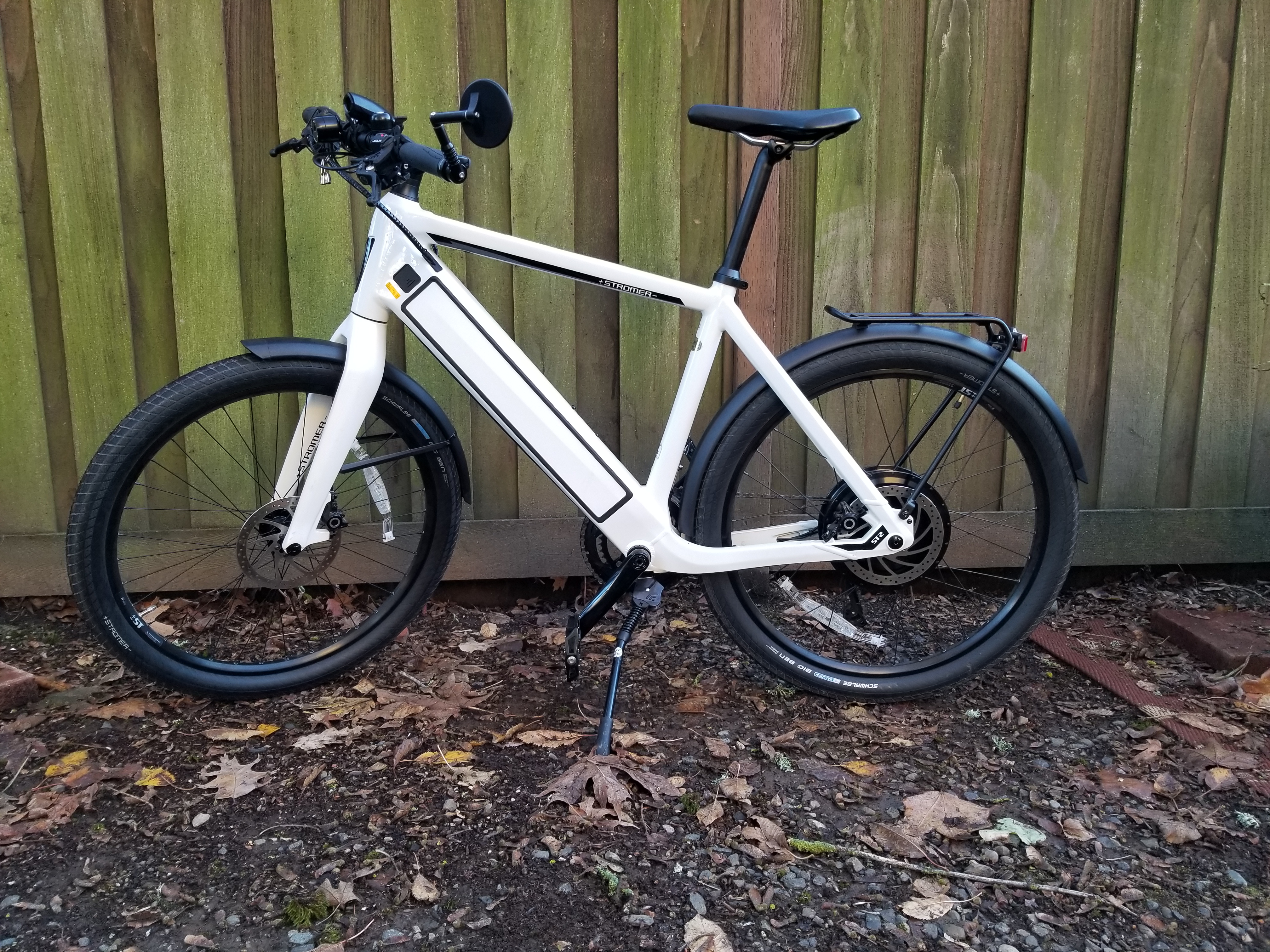

I have been looking around for an electric bike for months to help me cover my 17 mile commute over the West Hills of Portland, OR. I have been on a road bike for years but my 50 year old knees starting begging for mercy and I wanted to speed up the hour commute a bit as well.
Rode a Turbo Vado 6.0 for a week but the 604 Wh battery did not have quite enough juice to do the entire 35 miles round trip. Then tried the Bulls Lacuba Evo 45 with a 650 WH battery. It was able to handle the round trip commute but I was not as impressed with the fit and finish and I also prefer a slightly more aggressive riding stance and the Bulls is a very upright ride.
Started looking at the Stromer especially because they allow you to upgrade to a larger battery. (Why don't other bike manufacturers have this option? I likely would have stayed with the Turbo Vado if I could have purchased a larger battery.) First looked at the ST1x which was in the same price range as the TV6 (approx. $5000). A bit more research and I liked some of the upgrades available with the ST2 (carbon fork, SYNO Drive, better components, lighting, larger std. battery, etc). I was ready to order one when I came across a 2018 end of year sale on one from a local dealer. They were offering the Stromer ST2 with the upgrade from the 814 Wh battery to the massive 984 Wh battery for $4899 which is $2100 off MSRP. Could not pass it up.
First ride into work this morning and my battery still has over 80% left. That is another 'shout out' to Stromer...thanks for putting the battery percentage rather than just a bar. Too hard to know how much life left when each bar represents 20% of the battery life.
Looking forward to many miles of fun.

You should be able to do that nonchalantly without any range anxiety. SYNO drive has a lot of oomph compared to most mid-drives.
If it rains a lot, you may install some mud flaps.
Enjoy your commute ?
Sounds like you got just the right bike for your needs, and at a great price, too! I hope we get to see some pics of your favorite rides.
It was a bit rainy yesterday when I brought it home. I'll try to get some better photos tomorrow.
First work commute today and I covered over 30 miles and still have over 50% battery and that was using the battery liberally. I was in 2 or 3 nearly the entire ride. I could definitely be more judicious and I have a few pretty steep descents where I could recoup some Wh as well.
This bike is a blast!

Welcome @OregonN8V! I also bought a stromer st2 due to the west hills and the rainy weather. My commute is only 5 miles from ~ skyline to the river front but some days just want to get home quick as possible and it’s cut my ride back home in 1/2 from ~45 minutes to 22minutes riding through Washington park. That’s sounds like a great deal you got esp with the upgraded battery. I got mine earlier in the year so it’s a 2017 but only the 814wh battery ordered online for ~4600 including shipping. Now I’ll keep an eye out for an stromer! :)
All you need is a BodyFloat suspension seatpost and then its perfect!
If I didn’t already have my ST2, definitely would be interested in the ST2S that a local shop here in Portland has posted on their site for ~5399.
