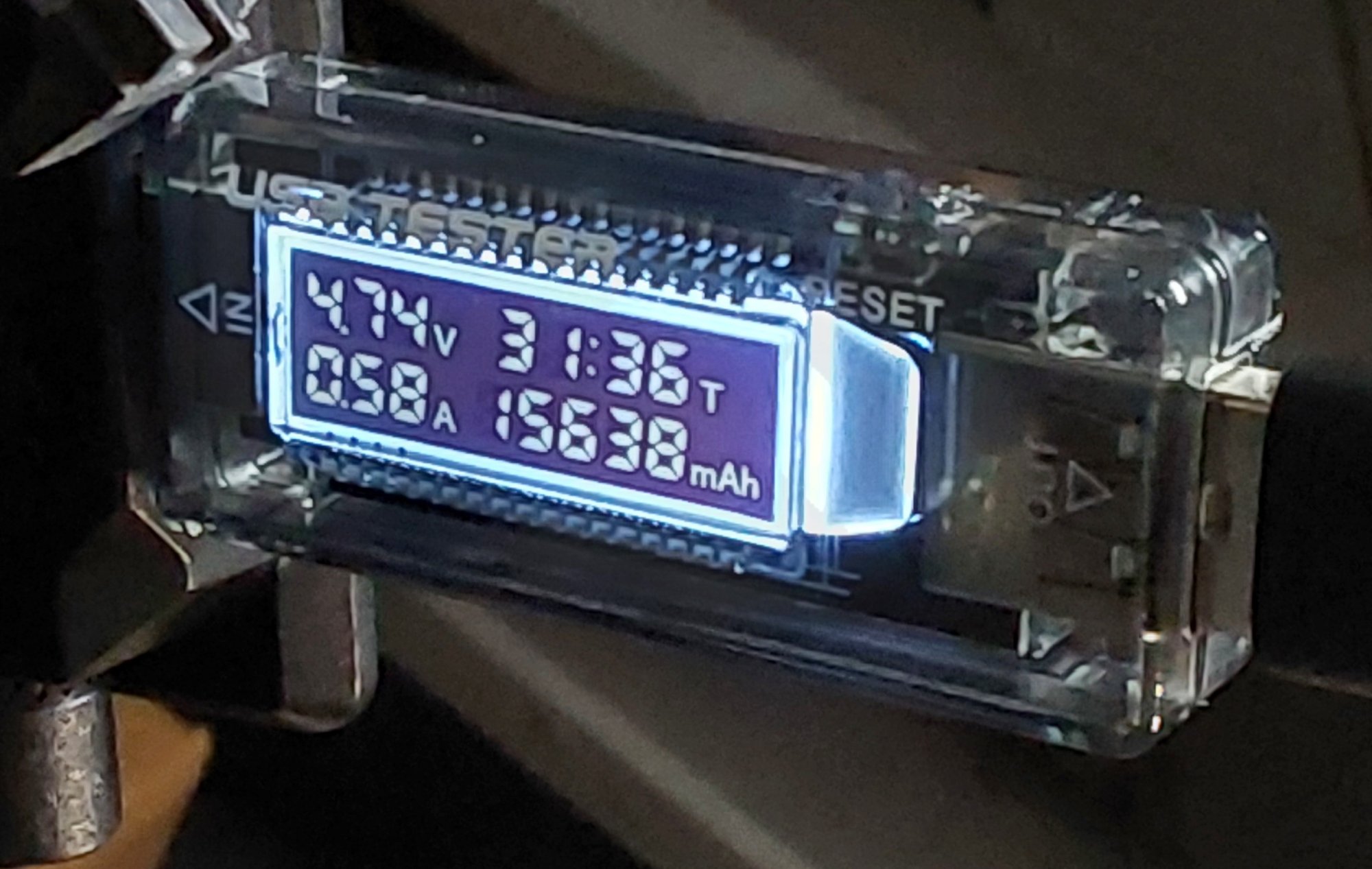

edit: If you want to know for sure what's going on... You can... get yourself something like this.

I have a much older version that I've had for years. Makes troubleshooting a breeze.
If you search around there's many a version... but you really don't need anything sophisticated.

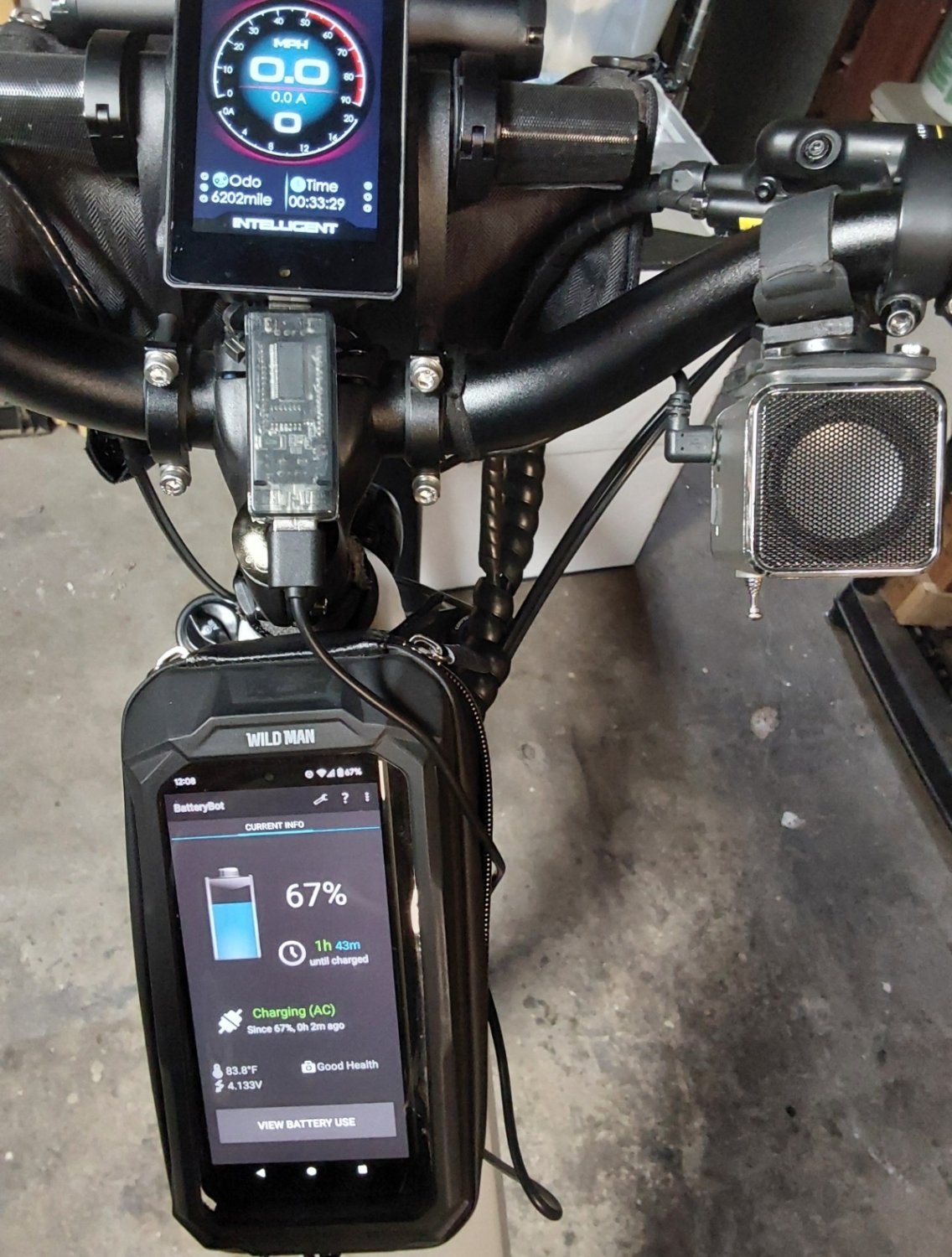

Ok for giggles I checked mine, and it did work.
Though I never used it for my Pixel 6, I do use it to charge the mp3 speaker you see on the handlebars
Bafang 860c display USB port rated at 5v/0.5a
