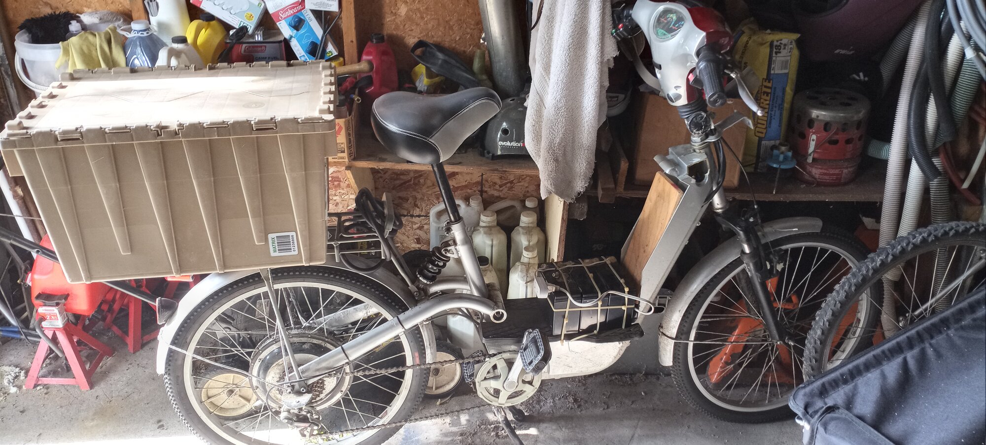

I use my old ebike for groceries and errands in the winter but it has SLA batteries and an automatic charger that keeps the battery topped up so it doesn't freeze.
I don't ride my other ebikes in the winter but I would if I didn't have my old e-bike.
