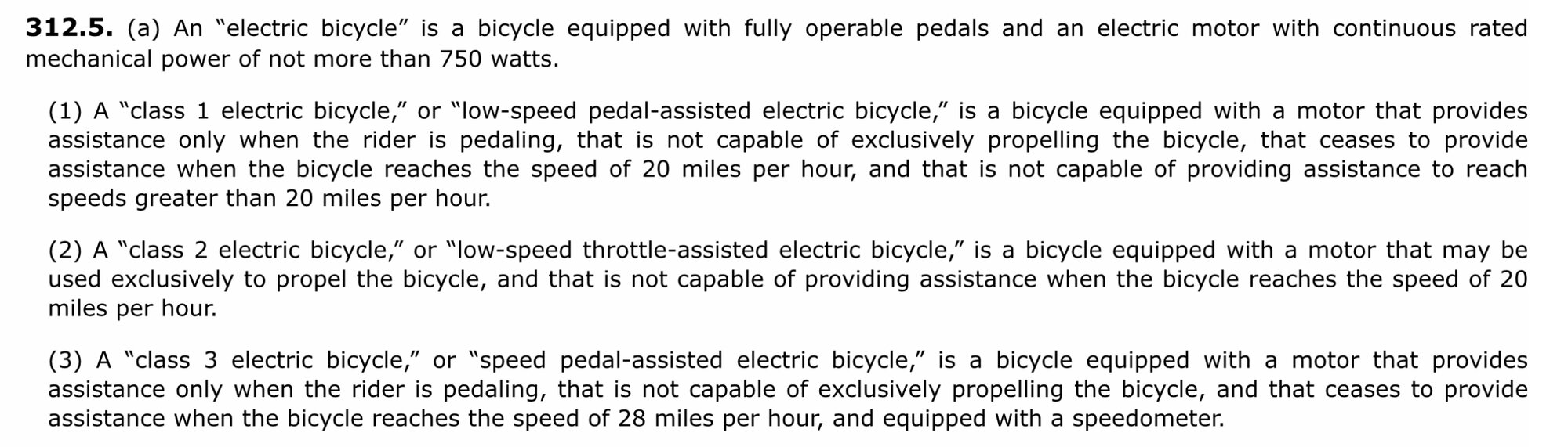

I did not say that. The point Matt is making is how the bill wording appears to impose a hard peak power limit of 750w for an Ebike to be considered an electric bicycle in California after January 2025 but most Class 1-3 e-bikes sold in the US exceed that peak power limit. The implications are most e-bikes currently owned in California would be reclassified into the moped category with all the accompanying retrograde baleful implications for rider safety.I do not understand what you mean by current ebikes will no longer be ebikes? Can you help me undertsand that? Thanks

You have to read that section of the bill. @Dewey linked it in Post 225.2) could you clarify what you mean by "no longer ebikes-- see 312.5(d)(2).?
312.5(a) establishes the hard top limit of 750w output so that wipes out most of the ebikes sold in CA and the USA.
312.5(d) lists what is NOT an electric bicycle
312.5(d)(2) closes its sentence with an 'or' that expressly cites and excludes any bicycle whose power exceeds 750w
And to reiterate: The layman generally does not understand that volts times amps equals watts, so almost much EVERY ebike has power that exceeds 750w. That is not a hot rodded ebike. They all do that. 750w was never a set peak maximum amount. By way of example an ebike with a 48v battery (extremely common) and a 13a peak controller (which is weaker than almost every ebike sold today by anyone) is legal. But one with a 14a controller is illegal. Typical mainstream ebike controllers even from the big name brands are in the 20-25a range.
The legislator who drafted the bill didn't understand these technical underpinnings when they decided to make 750w a hard limit. Only the federal CPSC-sourced limit did this by making 750w a grey area on purpose.
Interesting to note that sometime between June and when the bill got sent to the governor, they removed 'continuous mechanical' from the 750w language in the bill. I thought you were overreacting until I read the final version - the older drafts made much more sense, leaving room for higher peak and electrical power.Yes but you will have to google for it. The CA government has a web site that lists all pending legislation routinely. It is not going to provide Cliff's Notes though. You will have to dig thru it or just become generally aware of the legislative climate by staying current with industry sources who produce content in the industry..
Yes. As has been noted above, this bill originally was all about mandating ebike battery safety. It got rewritten and added-to later on to become the monster that it now is. The industry and bike-lobby support it got was back when it was a battery safety bill.Interesting to note that sometime between June and when the bill got sent to the governor, they removed 'continuous mechanical' from the 750w language in the bill. I thought you were overreacting until I read the final version - the older drafts made much more sense, leaving room for higher peak and electrical power.
No stats. But I am very familiar with the subject and the industry. I know how ebikes work, what makes them tick at the fundamental level as a builder and as someone who closely watches the products and the industry. Its like knowing cars need gasoline. Duh you would say because you have enough background knowledge accumulated over time to know that. The power requirements and what you find in commercially produced bikes are similarly basic fundamentals....Curious as to where you get stats on current CA sales? Or is that just based on observation? ( which is reasonable)
It wasn't originally. As @BlackHand noted above, the bill changed over time to become something completely different than it was originally intended to be. When that hard 750w limit was introduced, it did garner some industry press which was where I first heard about it.I don't believe this was the intention of the bill's writers.
Yes I think industry will be surprised by the revised wording. At least one brand recently blogged about a continuous power rating rather than a peak power limit
