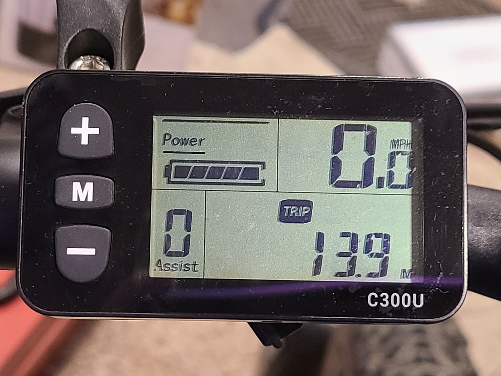

The displays are the same model number but look slightly different. This one is on the Element. Note the "M" for the power/mode button.

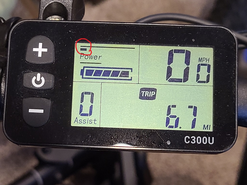

This one is from the Avenue. Note the "Power" button for the mode/power button. Also note the power display already shows one bar of power whereas the one on the Element shows no power bars.
The motors are definitely different between the two models. I'm not sure how much this has to do with the wheel size difference and how much has to do with being different internally.
