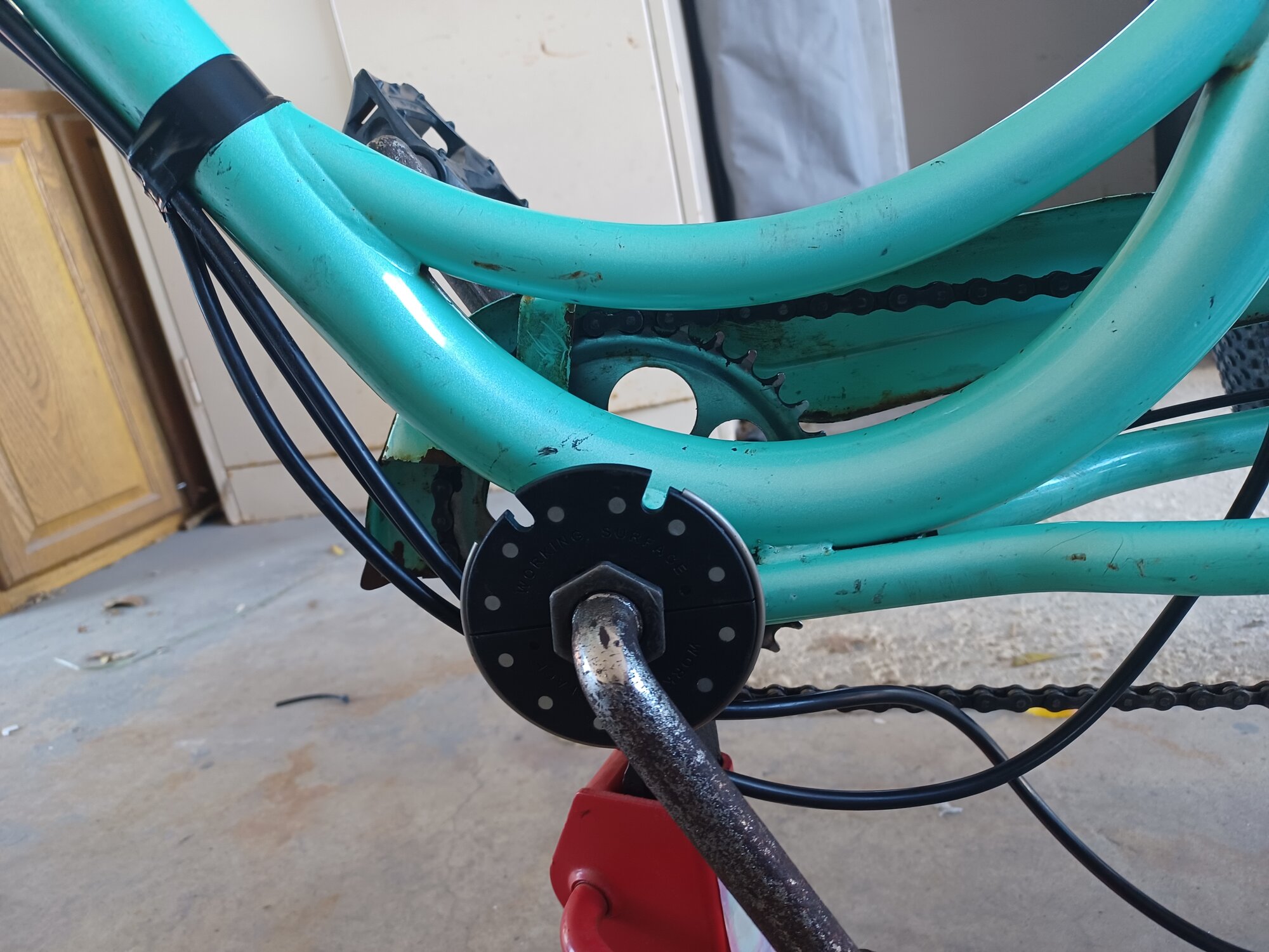

I am installing a Ebikeling front hub motor kit. I'm having issues mounting sensor where it will continuously work. We have throttle working fine but PAS works intermittently & finding a mounting solution where it works consistently is my problem.
Here are a couple of shots.
The pickup need to be the thickness of a nickel away from the magnet wheel. You may need to improvise a bracket. PVC is easy to cut with a saw and to file. It is also easy to drill and will shape with a heat gun.
