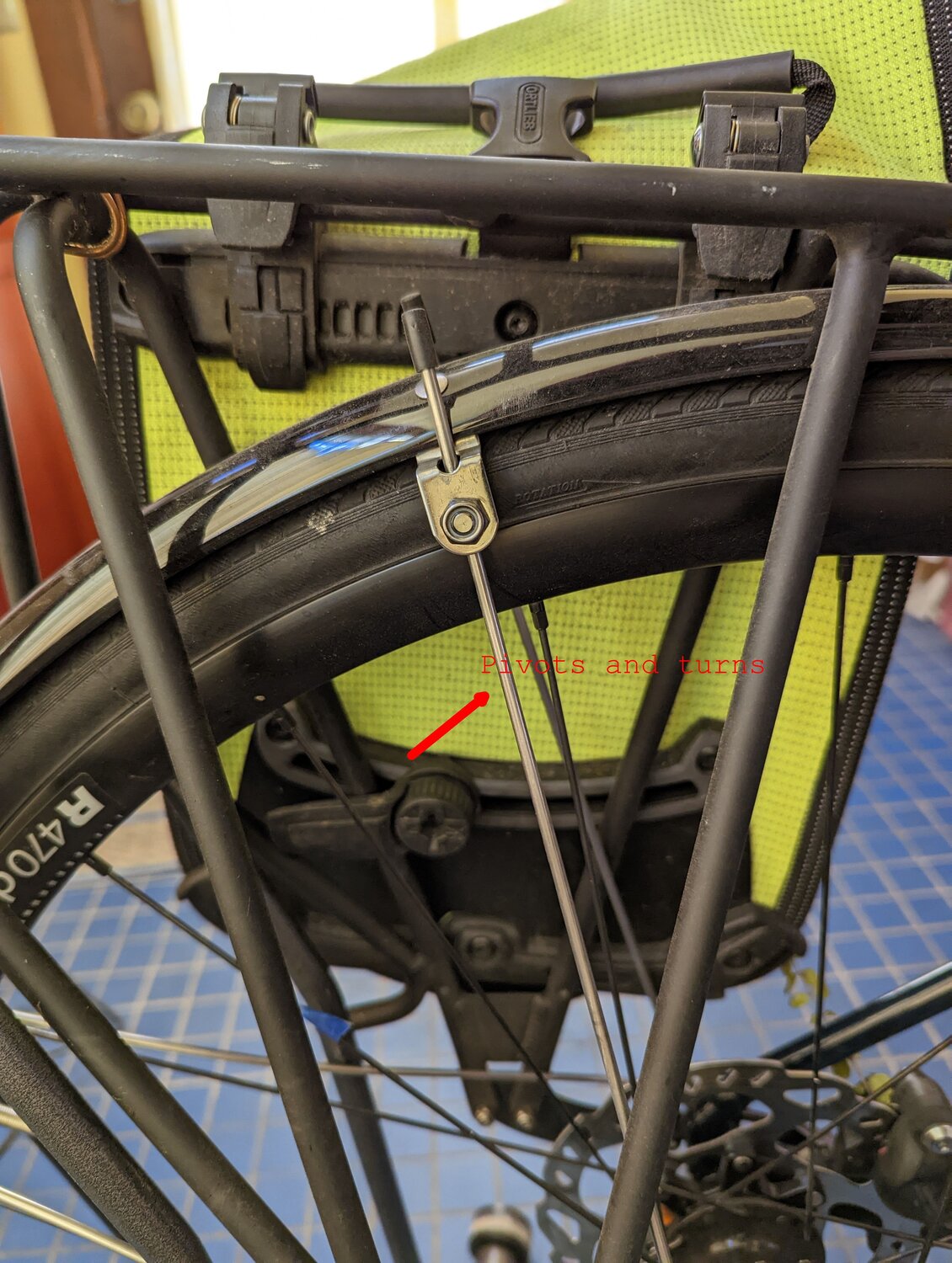

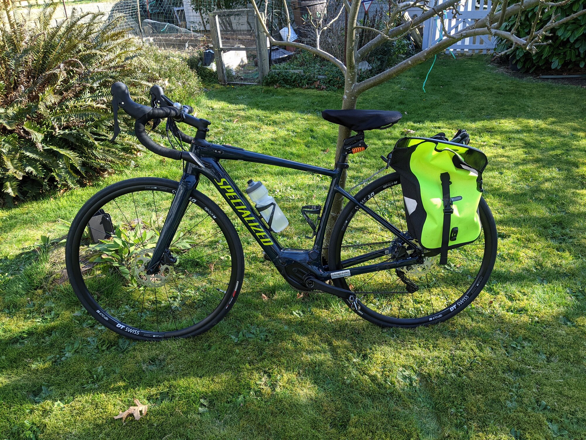

I am using the Ortlieb "front" roller panniers (bright yellow) on the rear of my Creo. There are a lot of adjustment points that can be angled and rotated to grab racks in all sorts of ways. The rollup avoids the zippers and the yellow is far from khaki!!!

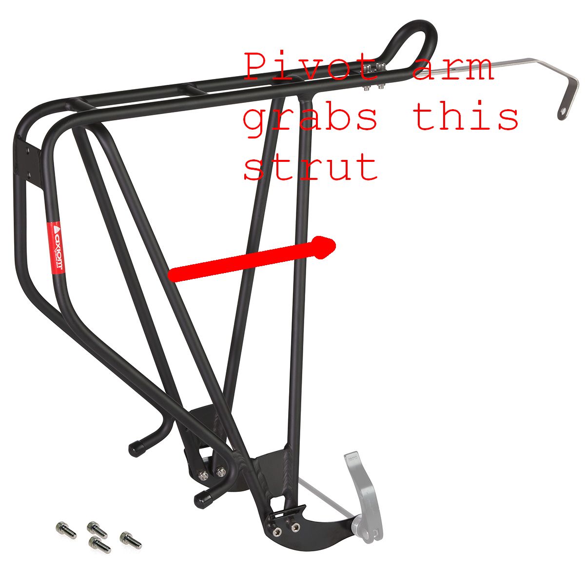

The pannier does not clip to the bottom but rather has an adjustable arm on a swinging pivot that engages the rack's rear "vertical" strut. The pannier is about 10 inches from to back and when folded/rolled to be level with the top of the rack, about 14 inches.

No, as my pictures show - it is a third party rack. I was just trying to show how it attaches and give some dimensions. I guess I would hope that folks can purchase whatever panniers they want to try from a place that accepts returns. That way that can try them to see if they would work in their circumstances.

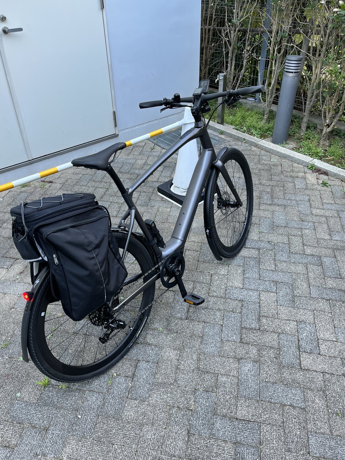

To give me another option other than always using a backpack, I got the Racktime Odin for the Vado SL. Not a touring pannier (unless you travel very very light) but good for light grocery shopping and commuting. The main compartment holds up to 13L and each side pocket when folded down 5L each.
The bag comes with snap it adapter ready-fitted and goes on easily. A couple of reviews complained of cheap plastic zips (not sure if they addressed that but they are metal now. And sagging, it’s better if you balance out stuff between the 2 panniers but the bag is solidly connected to the rack.
It’s a relief to free my back during these hot sweaty months.
