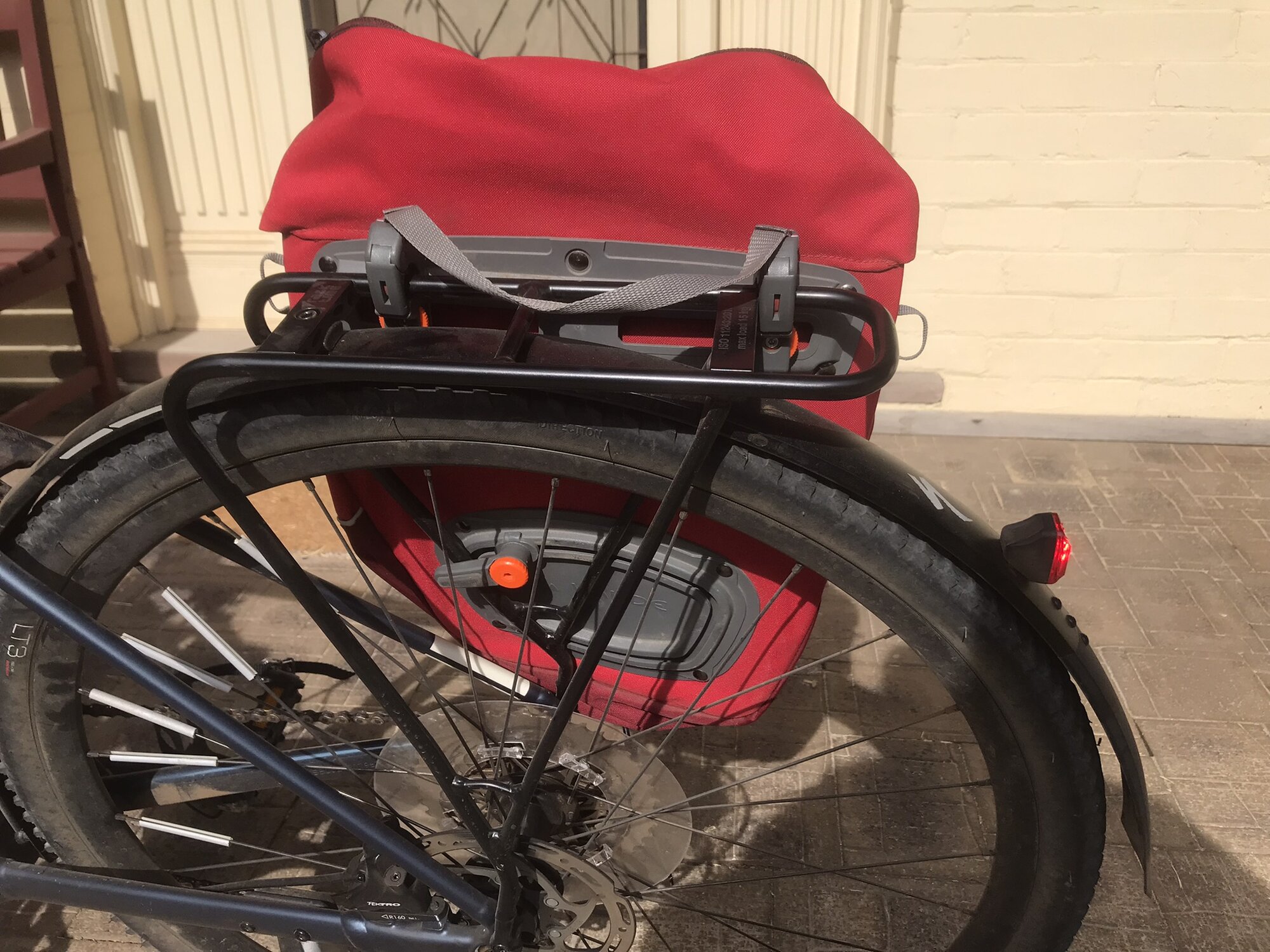

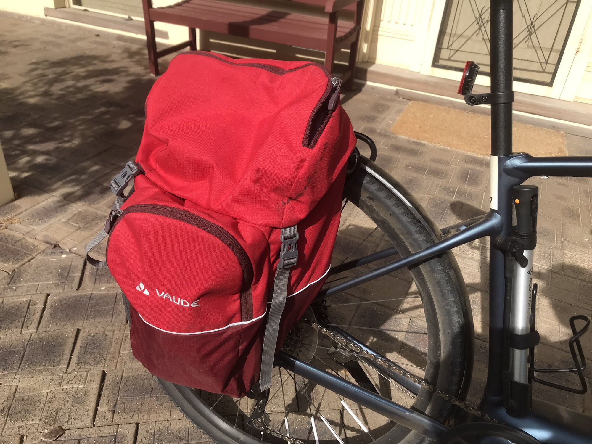

Vaude touring panniers fit securely.

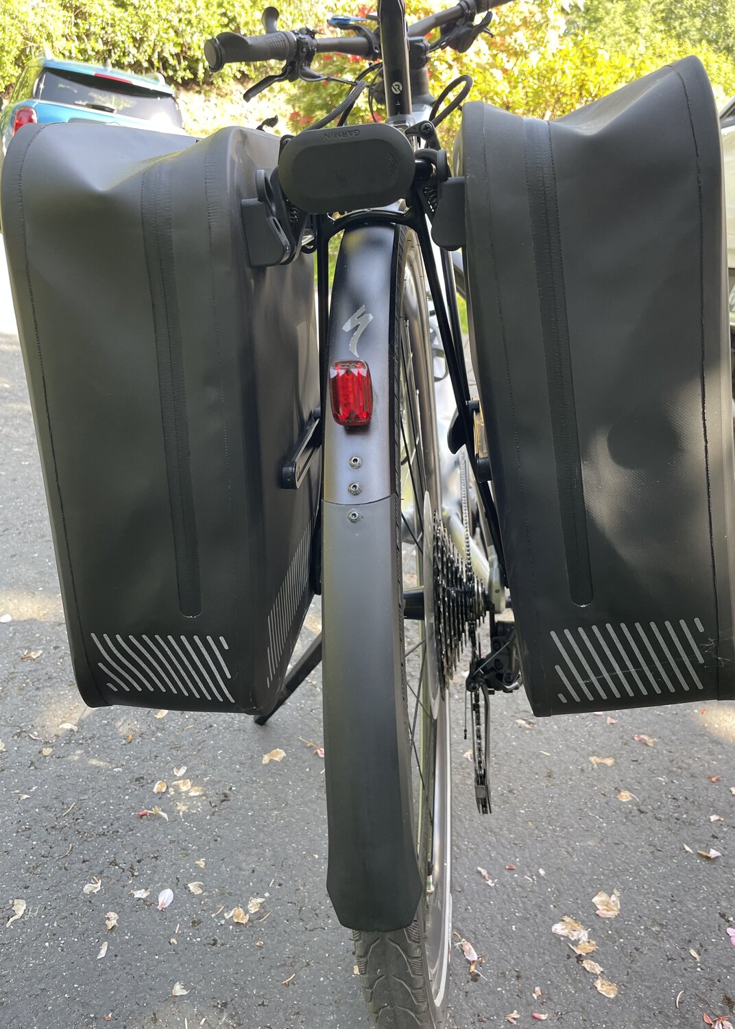

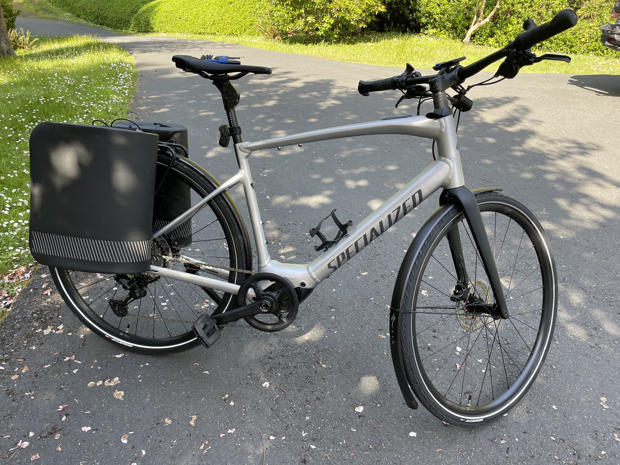

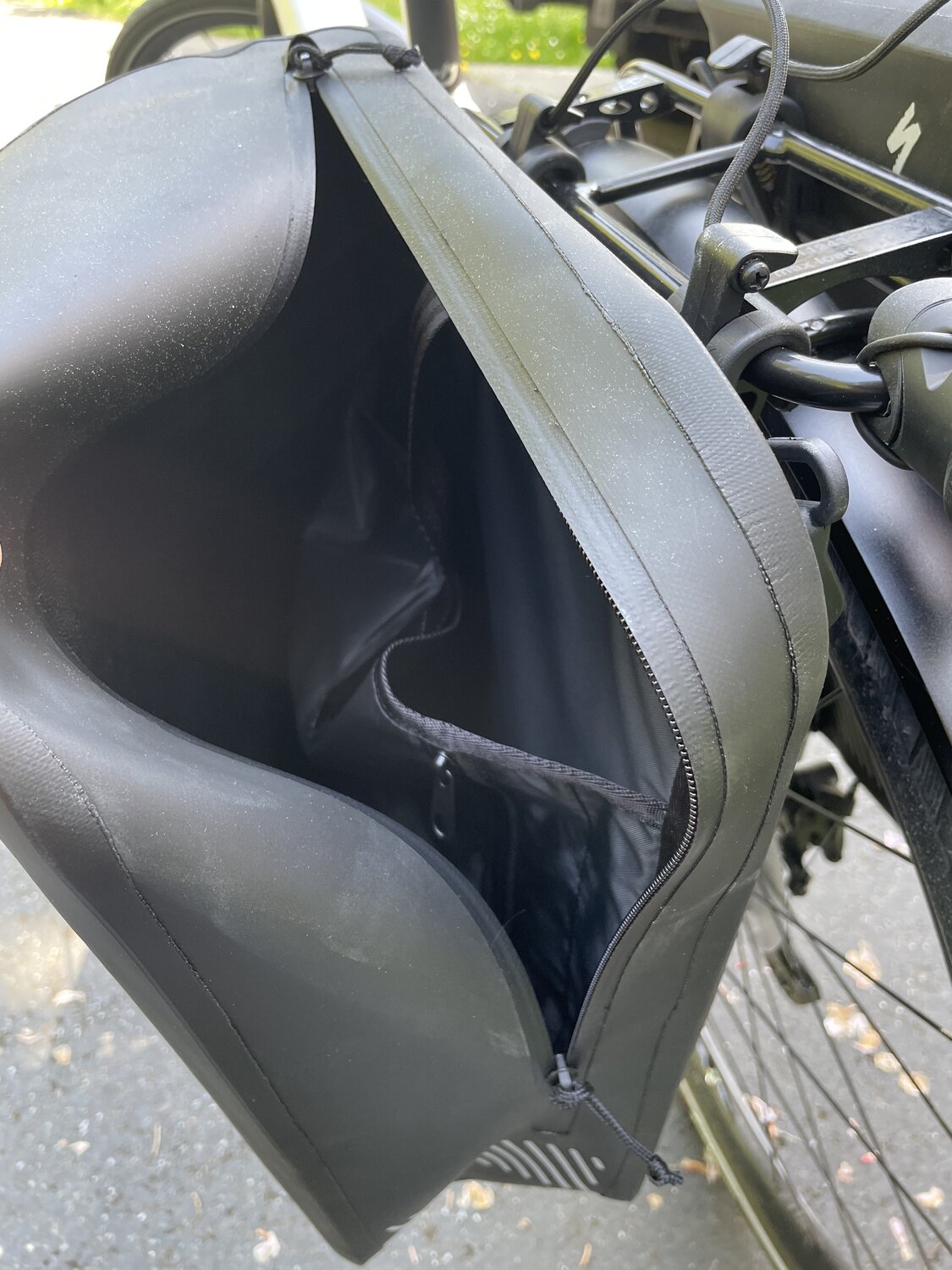

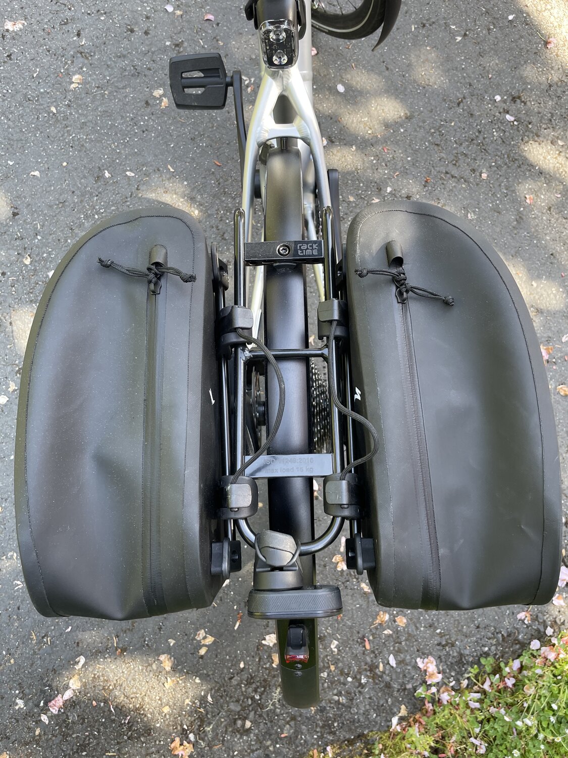

Specialized Tailwind Panniers - Works for what I need them for. 😊

Specialized Tailwind or Ortlieb Vario. The Tailwind fits the VSL rack very well. The Vario is of dual role: a pannier/backpack and it takes no bottom hook but it is still very stable. Ortlieb panniers with the bottom hook don't fit the VSL rack.

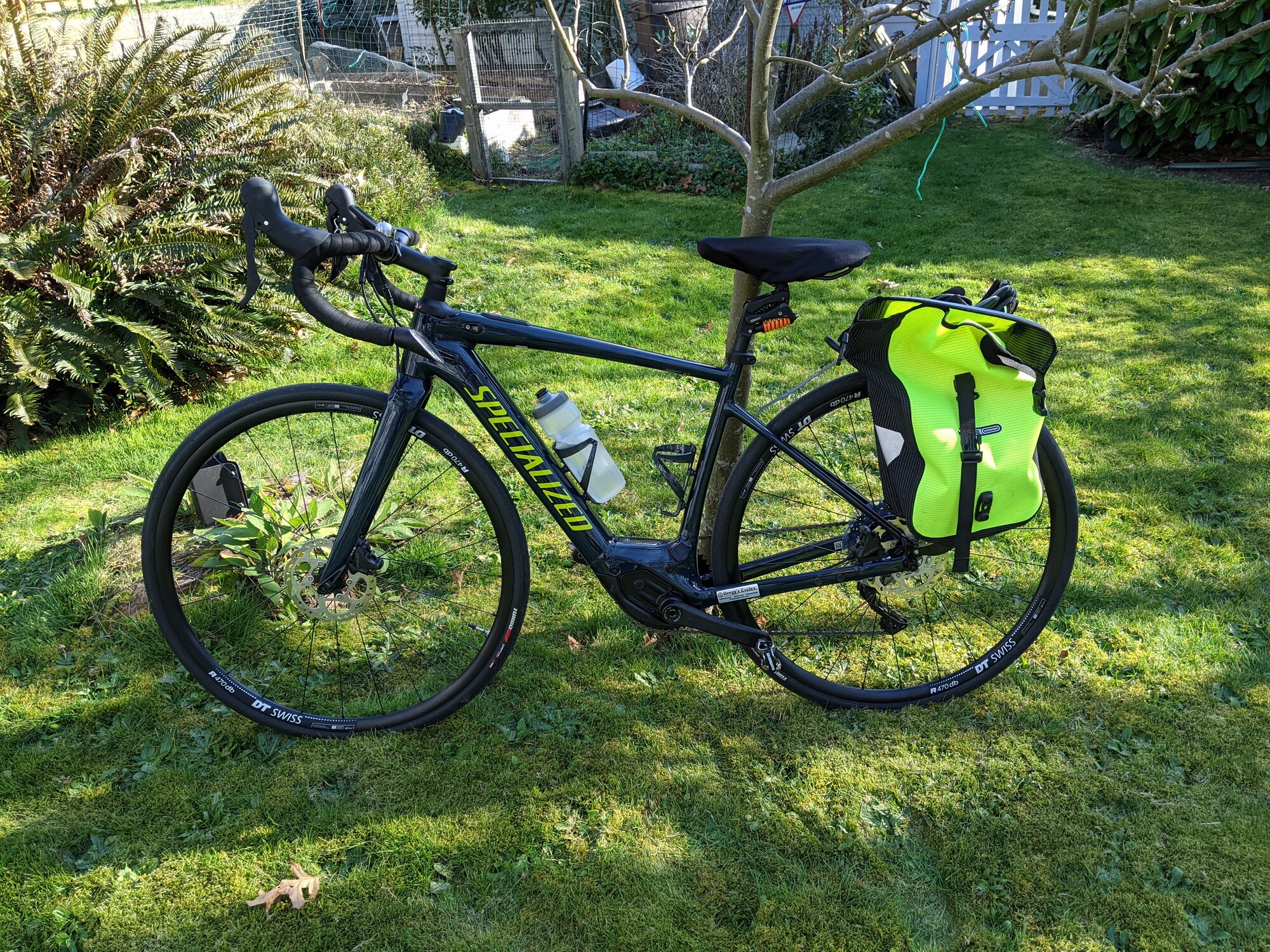

I am using the Ortlieb "front" roller panniers (bright yellow) on the rear of my Creo. There are a lot of adjustment points that can be angled and rotated to grab racks in all sorts of ways. The rollup avoids the zippers and the yellow is far from khaki!!!
