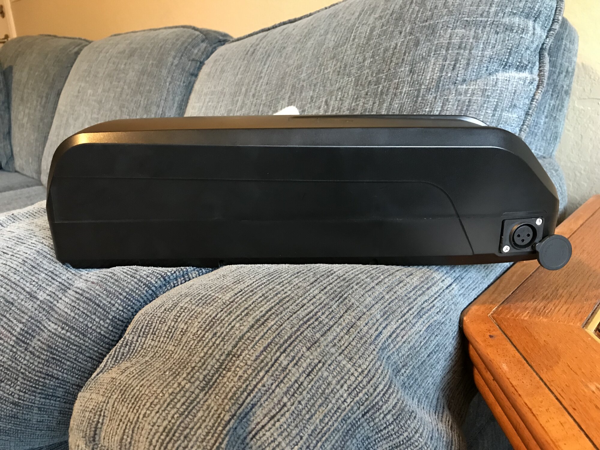

2. Can't find a back up battery so I can go 100+ miles at higher speed.(see photos attached)

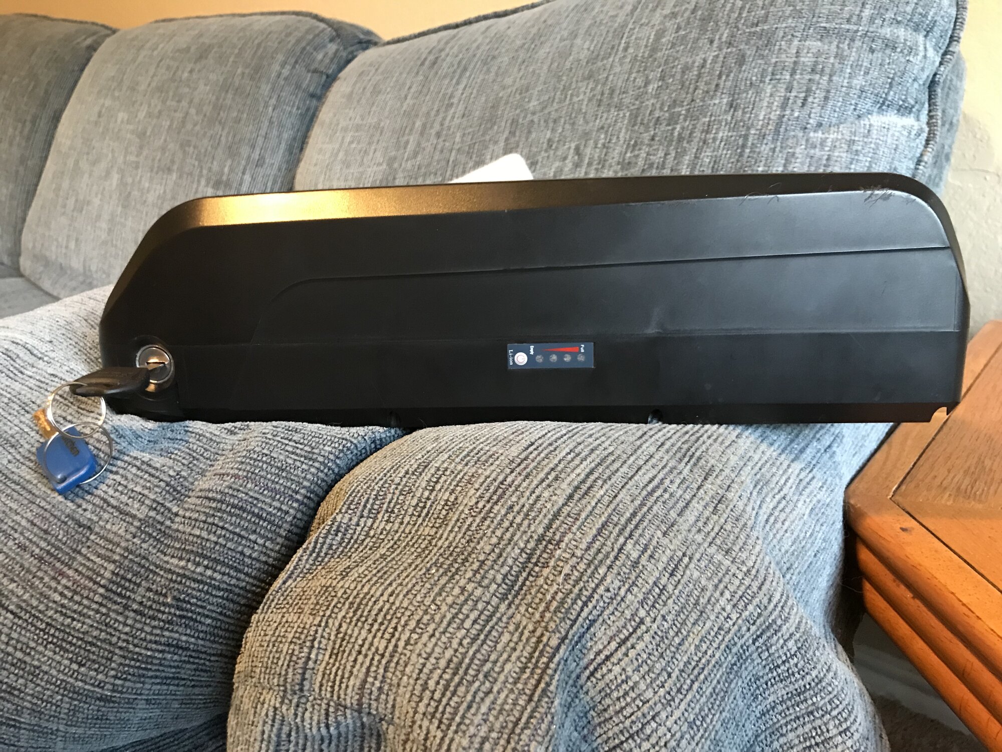

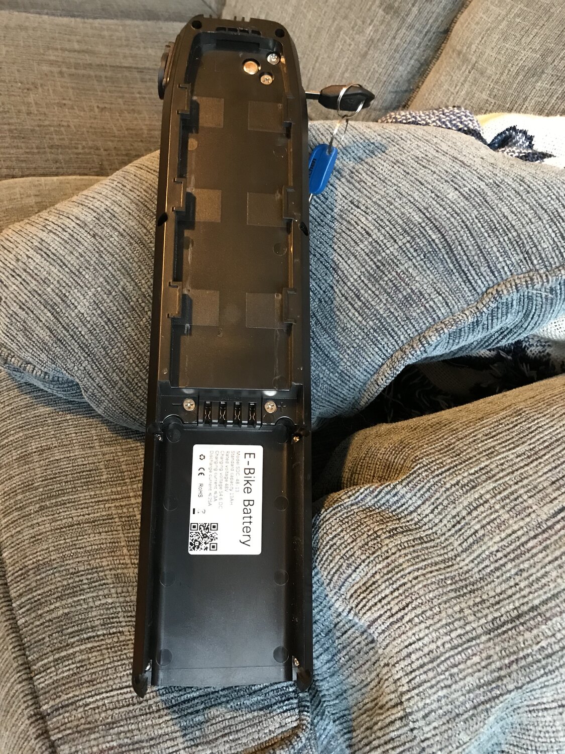

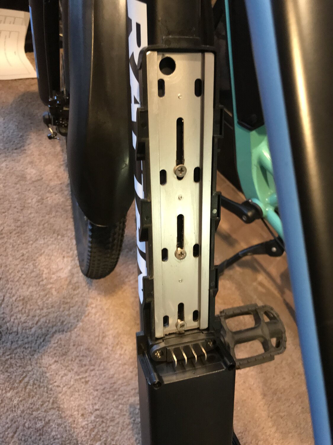

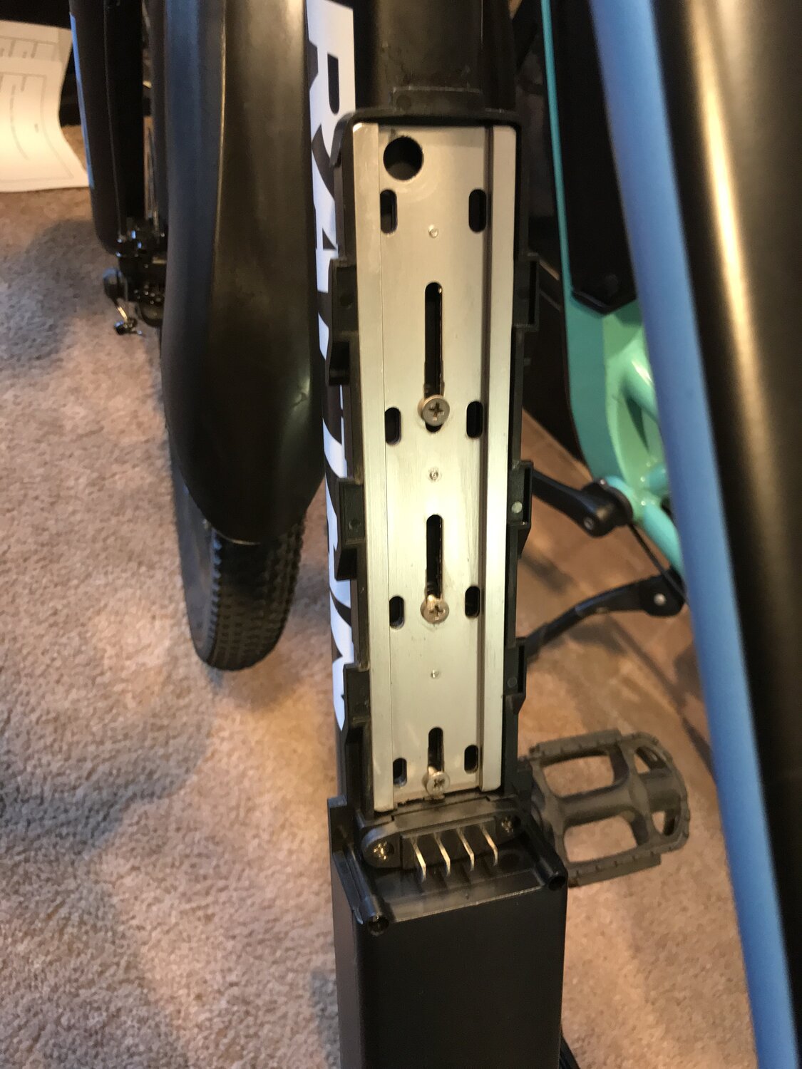

I am just looking for a battery I can carry with me on very long rides so I wont run out of juice. But it looks like the type of bracket I have is no longer being used by anyone, or at least I cannot find an equivalent battery that would plug in. Definitely no parallel connection, just switch out the spent battery with one fully charged, probably with its own separate key. I am trying to find out what kind of discharge connector I have. Did you get the photos? I will attach the bracket photo below.
I have been thinking a possible alternative is to mount the backup battery on the back rack and run and extension cable to it. This would mean breaking out the cable feeds into the back of the old bracket and install either a switch and/or extension to the new battery. Do you think that is possible? Anyway this would be cool since once the old battery drops to say, a single bar, I could reach down and switch the cable to the new one. I wonder if anyone has tried this. It is just hard to believe that I just bought this bike in Feb. 2022 and already the battery is obsolete.

It is probably a halong-2 case but all the brackets seem to have 5 prongs instead of 4 which mine has. Of course, there is absolutely no help from Rattan ebikes. Rattan has this I-Pas regeneration technology, and it does work. I have been down to 4 bars and then descended a very steep, long incline, and it came up to 5 bars. I am going to try this 77 mile ride again, the last 35 miles descend about a 1000 ft. so I might be able to regenerate enough with 4 bars to make it. If so, my need for the extra battery goes away. If one tried a cross USA ride on an e-bike, though, an extra battery would be absolutely essential.

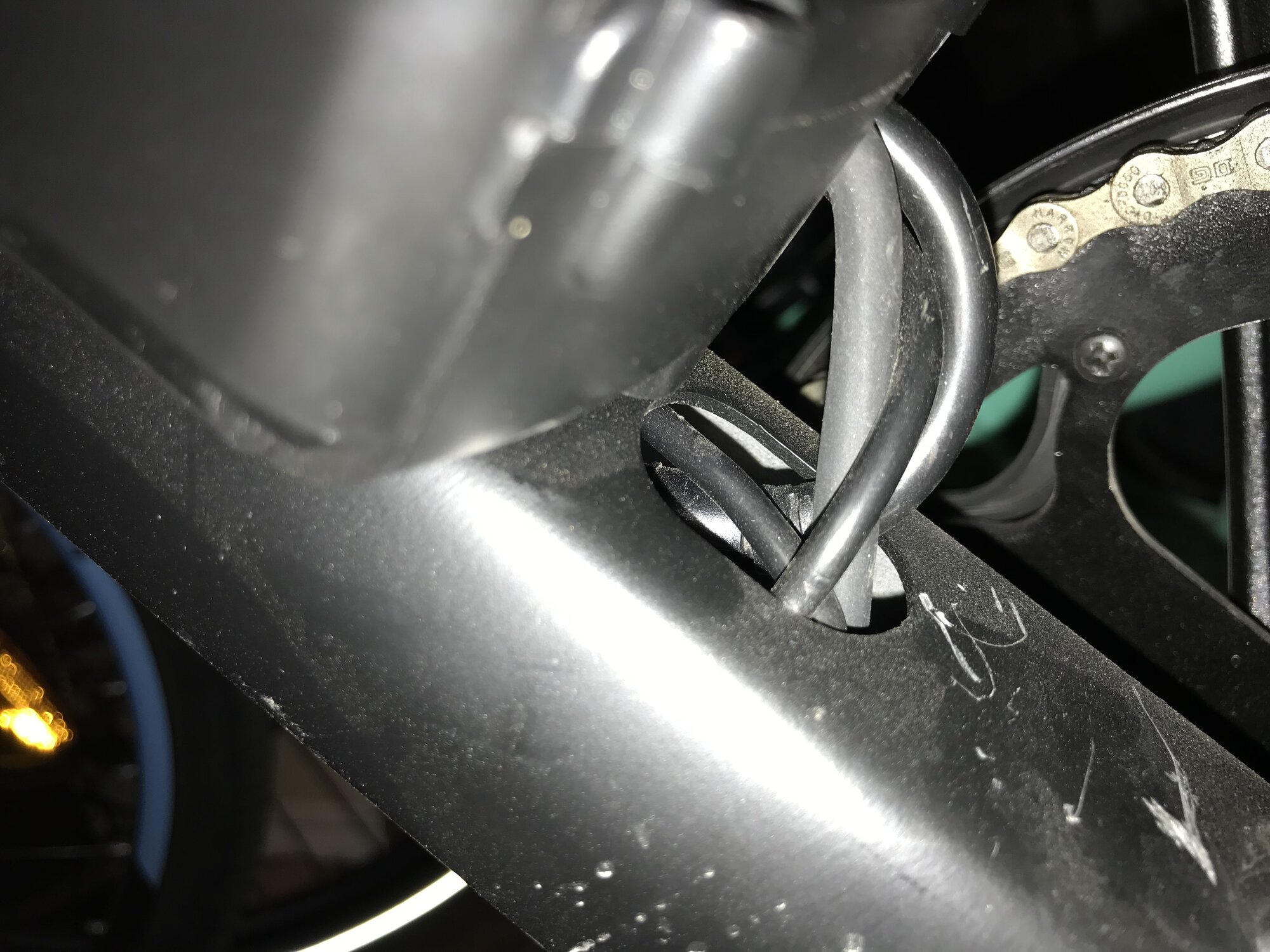

One battery manufacturer, Ankloss, says that the majority of discharge connectors are either an Anderson or XT60, but the latter is probably soldered in. It looks like I can remove a plate attached by two bolts and see the connection more clearly, then could go from there.
If anyone knows which of the two connectors it might be, that is, if one of those two, let me know.
