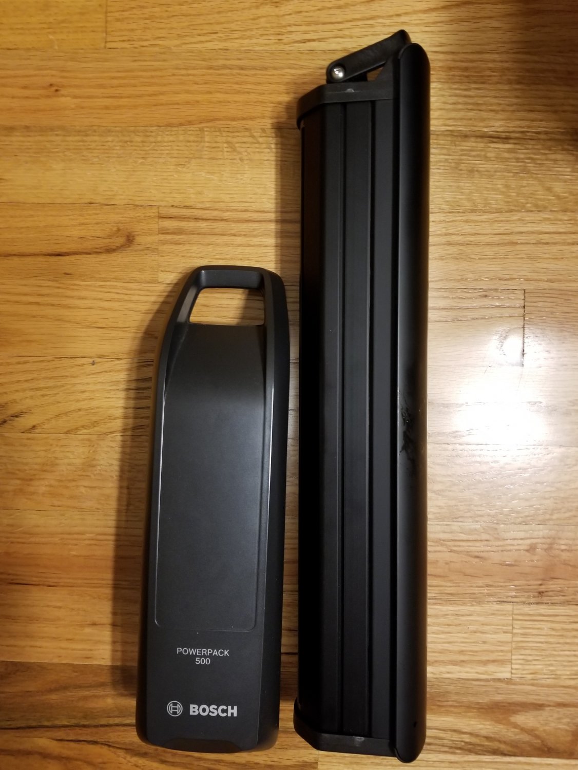

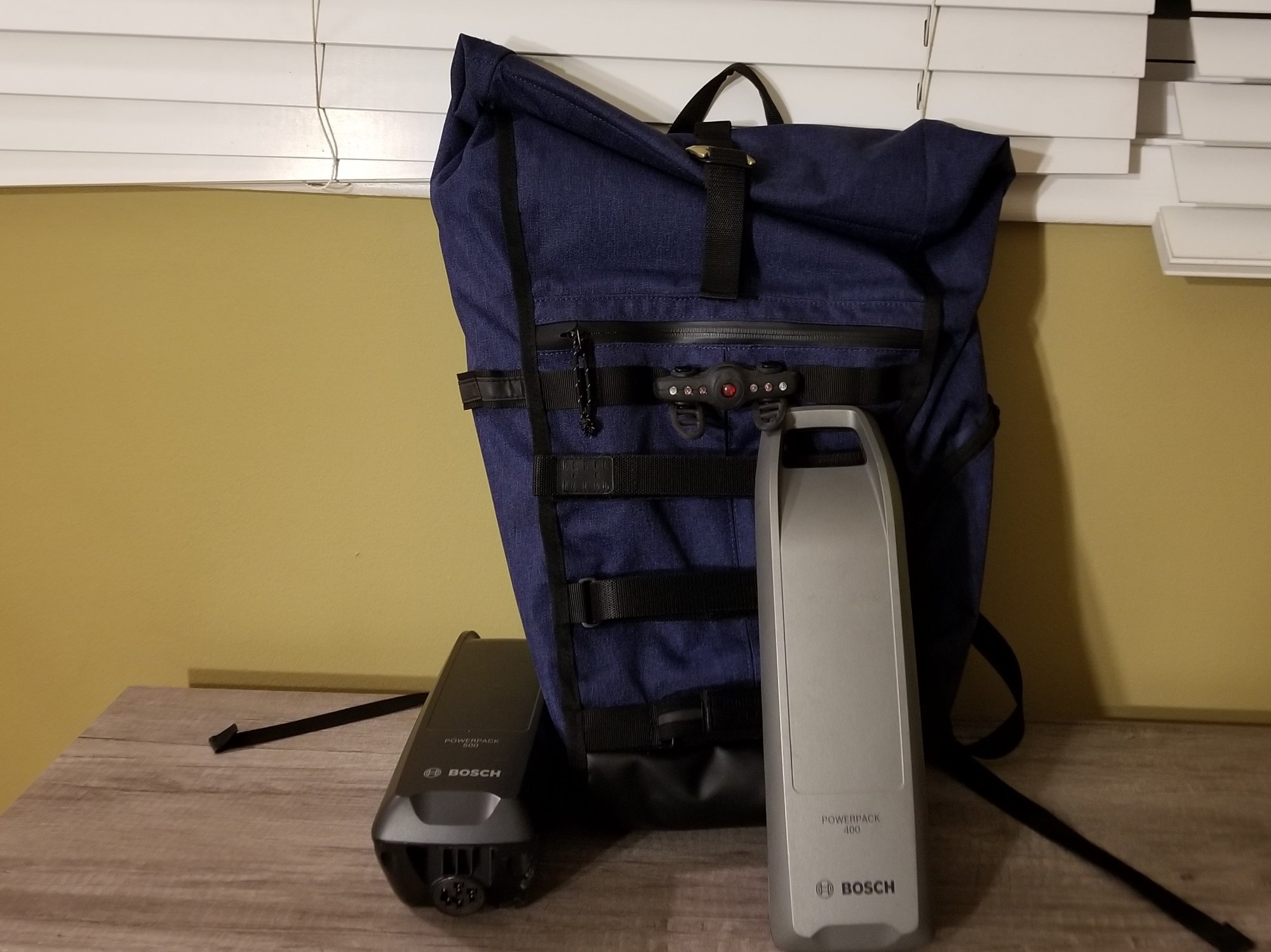

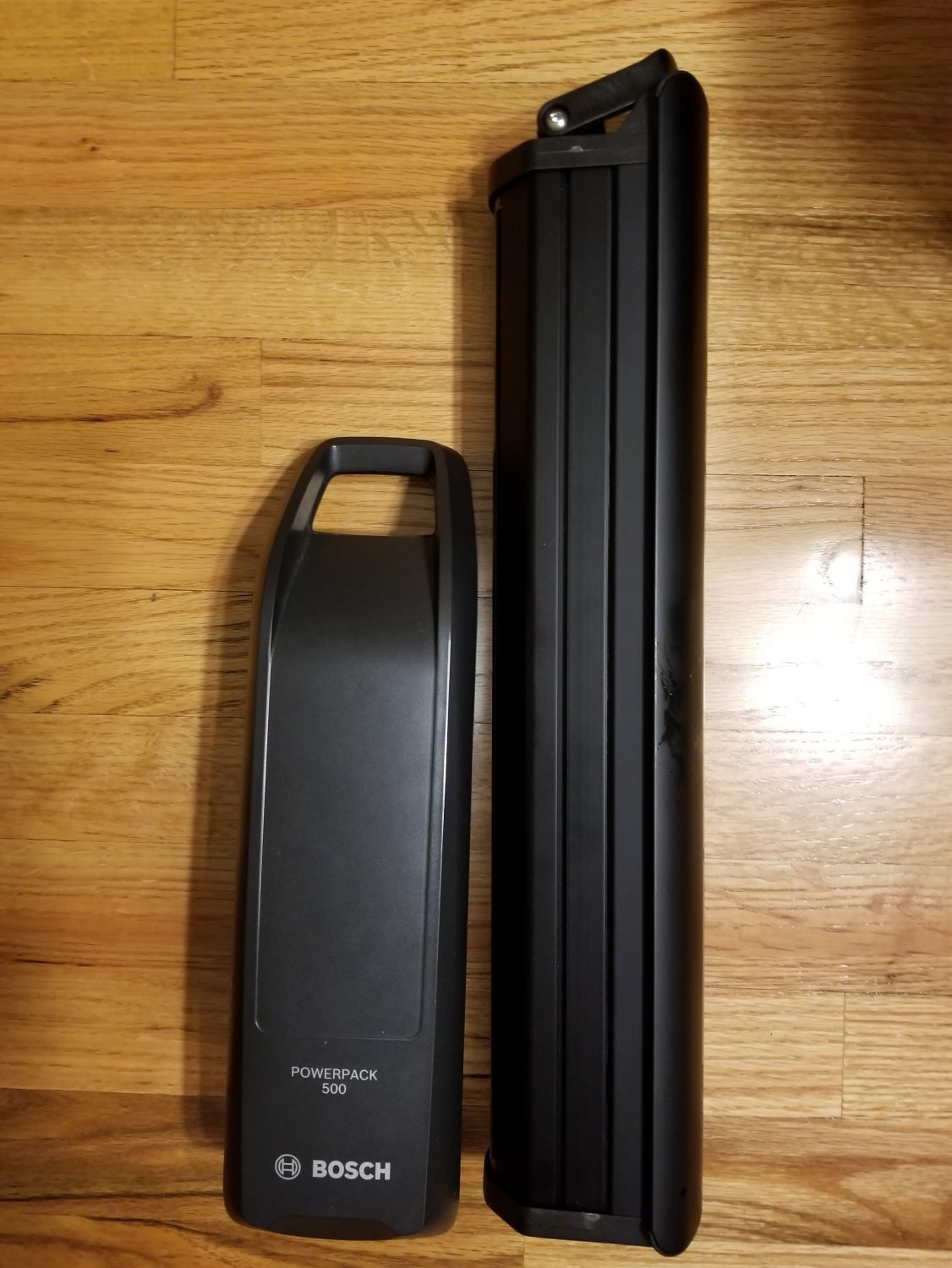

Beautiful bike indeed. Over50's power pack comment has me thinking though. The intube battery is nice and I can certainly use 625Wh given my terrain & weight, but how practical is it to take out of its housing?
Taking it out isn't an issue (does take 2 hands to insert and remove) but it doesn't fit in my panniers and barely fits in my backpack. I've attached a couple of photos for you. My backpack is a 17L Shimano commuter - so fairly small. It fits but the roll top barely closes. Obviously I could solve that with a larger/taller backpack. My panniers tend to run smaller than 17L (Ortlieb Sport Packers and a Bontrager something or other).
