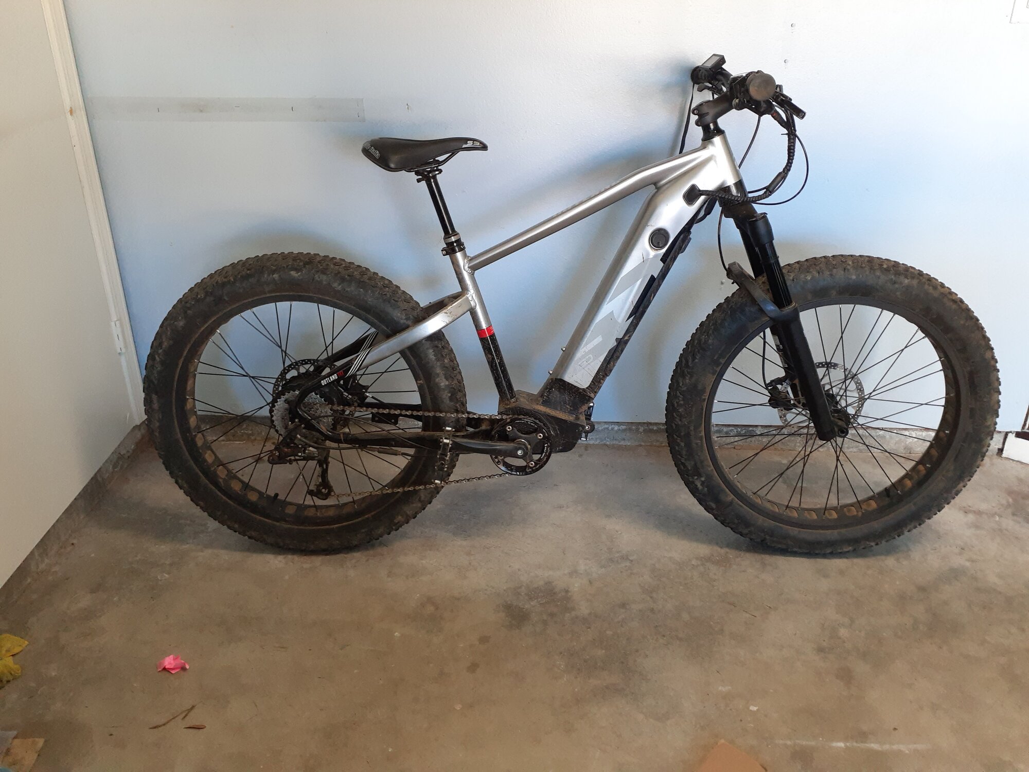

The iGo Outland Oka fits the bill. Hub drive with torque sensor, a good dealer network, established bike company, $2800. Its much more a mountain bike than the others you have mentioned. Here's mine, I went a little nuts. It's been upgraded with a Mastadon fork, bigger brakes, a dropper suspension seat post, and a smaller chainring to make it climb better.
