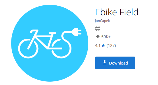

You cannot control the e-bike parameters by Garmin, only read them. Unfortunately, Garmin computers cannot interpret the LEV Travel Mode (the assistance mode name) providing numbers (such as yours 1, 4 and 7) instead. There is a workaround, though.
There is a data field by name Ebike Field by Jan Capek in Garmin Connect IQ Store.
If you read the documentation, you'll find there is a configuration file for Ebike Field. You can edit a data map there, something like:
  • 0 - OFF
  • 1 - ECO
  • 4 - SPORT
  • 7 - TURBO
(The above is only a rough example: the actual format is different and explained in the Ebike Field documentation when you install the Data Field).
I don't own a Garmin now but when I had it, I could do the map file for my e-bike. Also try googling "how to set lev travel mode name garmin Ebike field".
