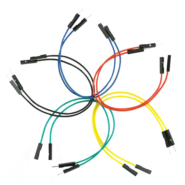

If that doesn't work, you can jumper the BBS0X cable with the dis[lay removed. It will run with throttle and one PAS level if the controller isn't damaged. If you own the programming cable, plug it but don't connect to PC. Otherwise, you need one jumper with female ends.
More info. If the bike runs, then you know the display has water in it. Some people like to run w/o display. I wouldn't mention the link, but I know the technique works on my BBS02B.
