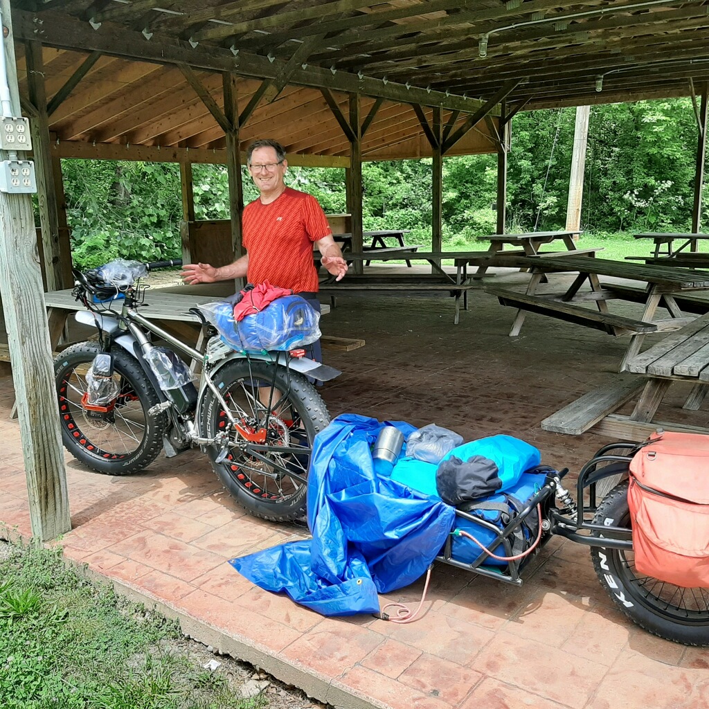

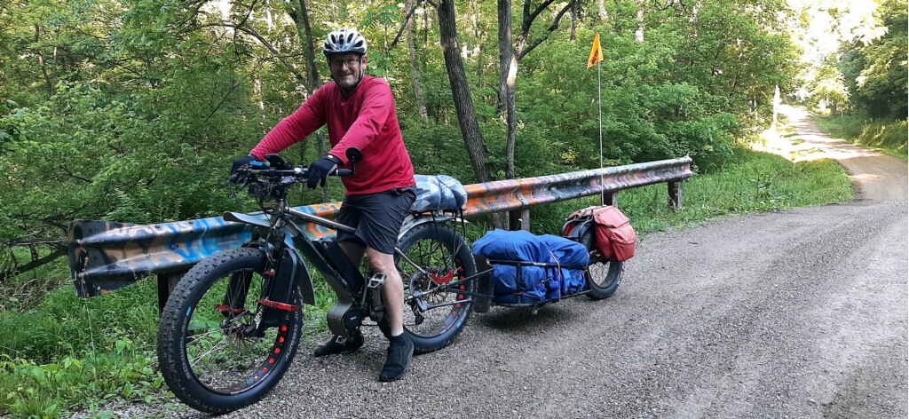

Explorer-1, like you I have found the biggest problem with a long distance DIY E bike is that it's a damned bicycle, therefore limited for weight carrying capacity and still have an enjoyable to ride low maintenance bike. I have done a fair number of bike packing tours and my conclusion is to limit the weight as much as possible and charge the batteries fast. The most reliable charging points are park pavilions and Gazebos.
Here is the heavy rig trying, 27 watt hours per mile with grades up to 34%. Charging at park pavilion

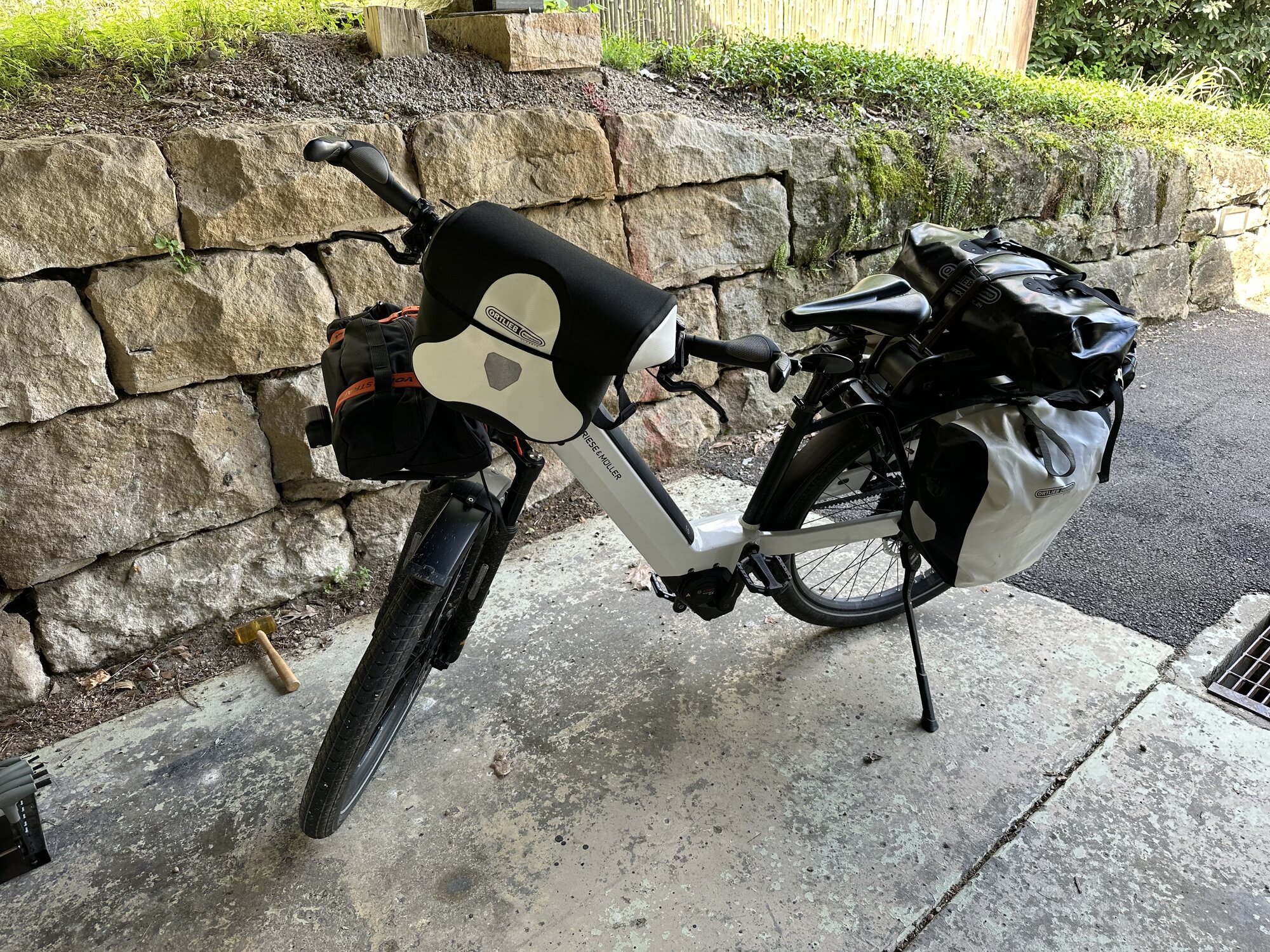

The Riese and Muller Superdelite with a Rohloff IGH and a front rack might met your needs. I use a dual battery Nevo with a Rohloff for bike touring on gravel roads. Loaded with camping gear on gravel roads and 3,000 feet of elevation gain I’ve gone 75 miles and had 40% of battery remaining. You would want the CX motor not the speed motor for the stronger low end torque. If you need to go faster derestrict the motor.

I have concluded that the big rig/trailer set up above is not really the way to go. That rig as shown tops 400lb and off road I am looking for a plug in at 70 miles with a 2.5KwH battery.

Then the really hard stuff started. I had not camped in 40+ years. I vowed to buy nice equipment but not before I could get over using expletives in front of all the gear words when thinking about it or describing the gear. I put it all on the bike and the bike handled like a pig. Maybe that is normal but I was coming from a Specialized S Works StumpJumper. I worked and solved it with a trailer, the trailer would haul more as well but overloading produced poor handling there as well.
Bottom line: What you see in the photos above of my heavy rig has no less than a cooler with ice, drinks and beer in that trailer as well as the camping gear, I also has a 10 lb repair kit with everything conceivable to repair anything in the field.
