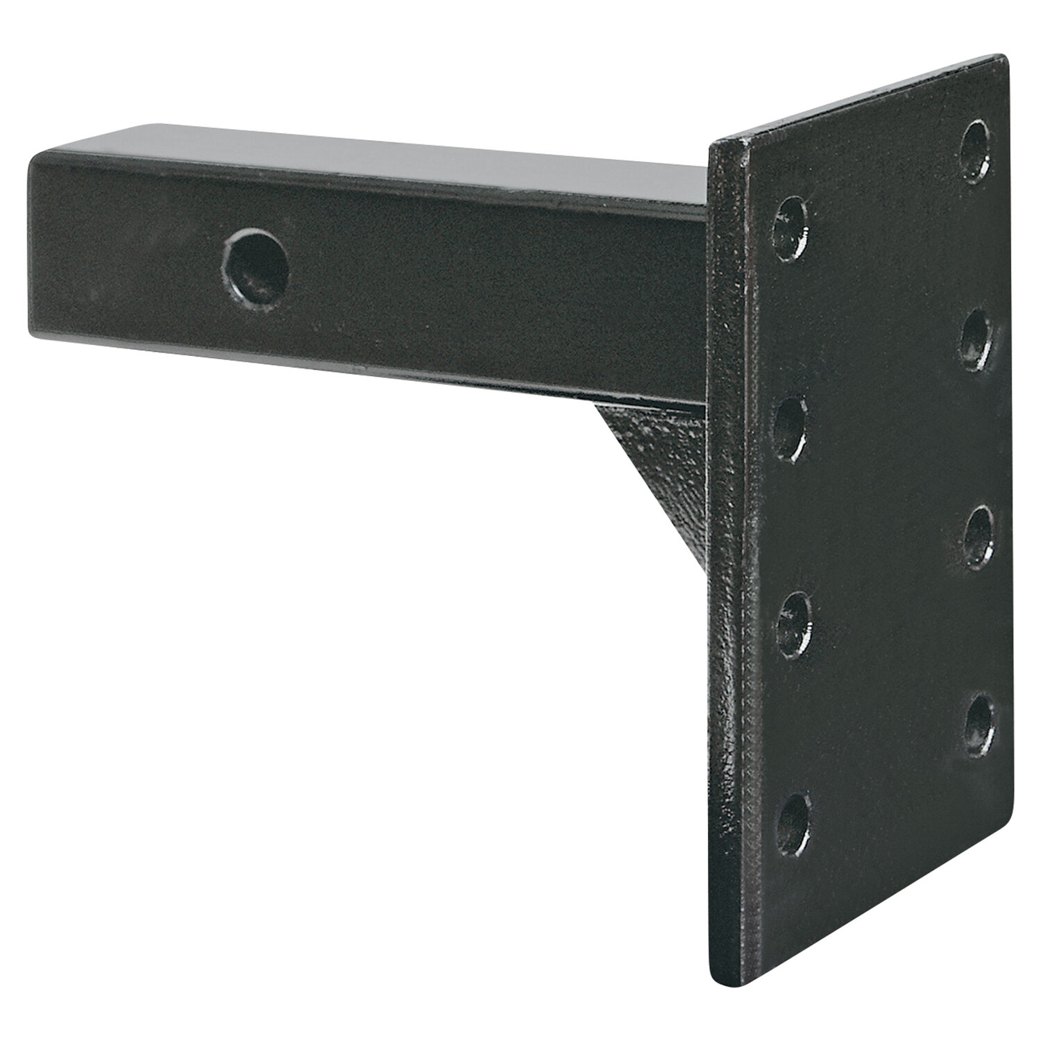

I used this Pintle hitch adapter:
I bolted a 36" piece of 2x8 to the adapter (you can use whatever length you want to get the desired height)

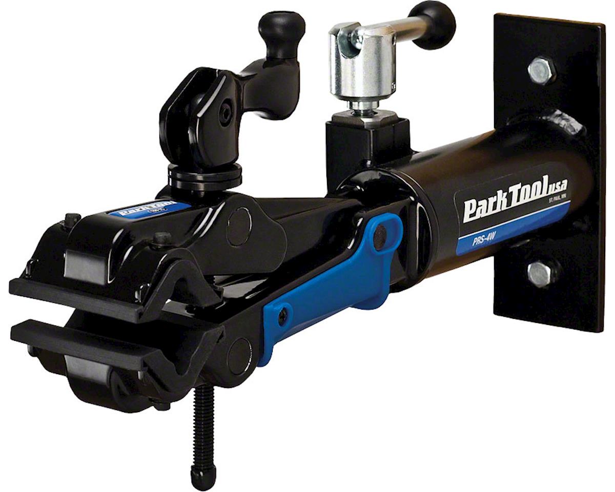

I then bolted my Park PRS- 4W to the 2x8. I normally use it in the shop but take it on the road when I travel.
The Park is a nice stand but a bit pricey. Any wall mount stand will work though.
