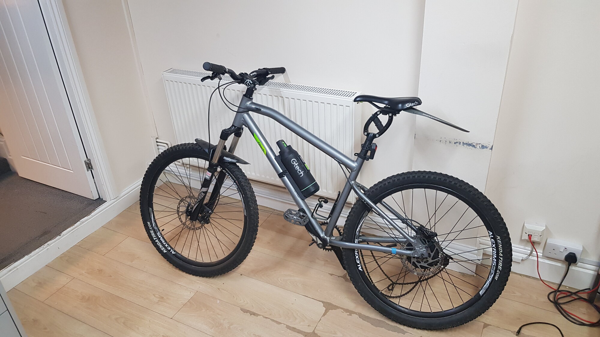

This is a G-Tech eScent electric mountain bike. Owned by my friend and maintained for a good couple of years. As such, the bike works both mechanically and electrically. However, upon my friend demoing newer ebikes (to which he was almost going to buy one of mine off me), I asked the question, "what's wrong with your ebike?".
We got talking and ultimately he expressed concern for the following:-
1. Future proof - The bike (by design), can only use the bottle styled batteries which by nower days standards, lacks in capacity. Ultimately, to get the range, he would need to take 3 additional batteries which ultimately each battery retails for near £300 (x3=£900 for a 36v 7amp battery).
2. Power - this, is pretty much straightforward. The bike uses a Bafang hub motor capable of 500w. Here is the thing, his batteries would never allow him to achieve 500w so technically, my friend has never experienced the motor at peak output.
Versatility - What can I say, I'm a hardtail fan #hardtailforlife . The point being (subject to your requirements), it is very easy to modify aspects of a hardtail more easily than full suspension without worrying about rear tyre/rear triangle interfering with a pannier rack for example. In my friend's case, he wants something like a weekday touring/commuter & weekend warrior.
4. Using the newest products - I'll be honest with you all, I've managed to secure components from brands who they have generously donated for this project. More will be revealed soon.

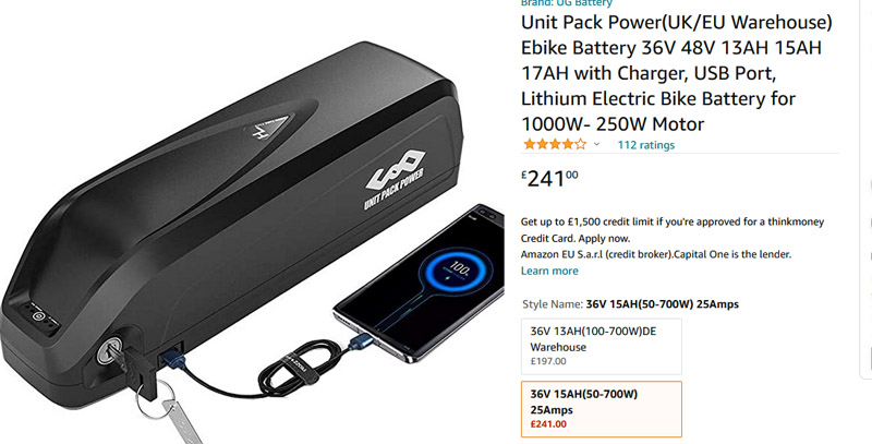

For $241USD or £177, your friend could go to 17Ah. Or he could go up to 48V, depending on what his controller can do. I believe these ship with cradle and charger.
I've already sourced the new battery and controller @harryS, but many thanks for your recommendation 👍🏿.

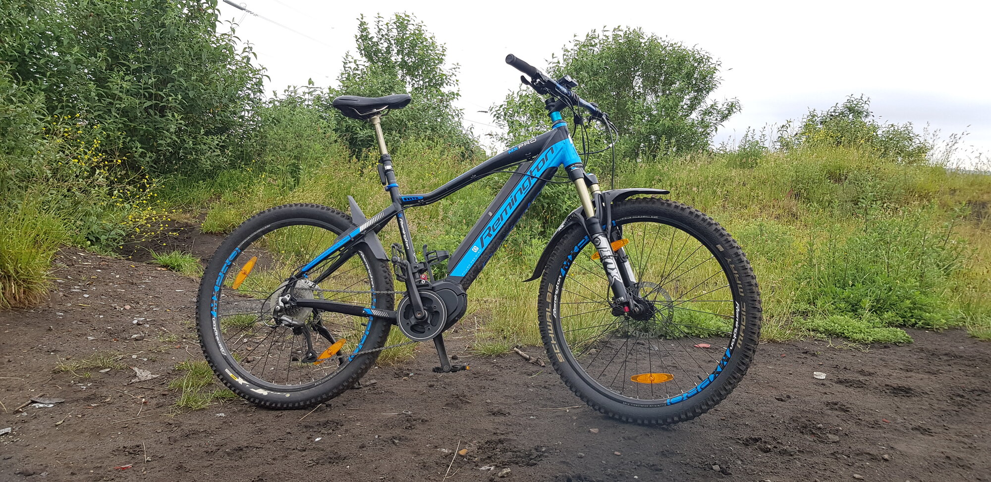

This is me on my Remington MXPro taken March 30th 2019 (although I think I brought the bike back in 2018).
I still have it and it gets used by family members nowadays.
Here's what the bike looks like now
Still works, still going strong and yes, 'old, not obsolete'.

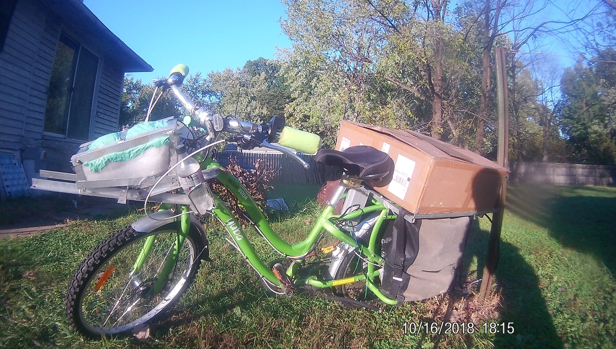

Here is the bike I'm riding now, in green. This is in 2018 when I still had the rear DD hub motor on the back. See the battery hung off the front, and the controller mounted under the seat to keep off rain. There are more wires wrapped to the upper bar to the front now, with the motor up front. The avatar and the thumb functions cut off the battery, but if you click on the green bike pic you can see the whole battery mount.

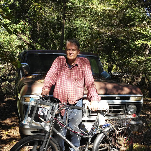

Here is the cruiser I converted in 2017 with a 18 lb 17.5 AH battery mounted between the front fork and the handlebars. It was not a success, partially because both LIfePO4 batteries I bought were garbage. Neither would supply even 5 amps before the voltage collapsed. Also steering a 18 lb battery on my rutted grass driveway out at the summer camp was too difficult. The green bodaboda has bosses in the frame to hang a front basket without steering. I made an aluminum frame to hang up there to carry the Luna LiIon 17.5 ah battery. The ASI controller that burnt the pins, I had to mount it under the battery because the harness was too short to reach under the seat. Rain burnt 2 pins right off.

Yuba welded bosses in the frame for 6 mm or 1/4" bolts. I didn't drill anything. Front basket is an accessory for cargo bikes. I like having weight on the front. It helps to balance weight in the back when I push the bike out of the garage. The previous 4 bicycles dumped me on my chin because the front wheel wouldn't stay straight when it hit obstructions. MTB & cruisers don't have enough weight on the front to center the wheel, and "quick" steering of ALL 26" frames sold since 1946(?) makes the wheel prone to snap sideways. The cruiser shown did it once. Why I wanted an 18 lb battery up there. I didn't like steering it.
I had trouble with XT60 & XT90 connectors falling off the battery. I cut those off and went to crimped dorman insulated .250" flag terminals, and crimped .157" dorman bullet connectors. No problems. The rain problem was a ASI connector that had pins .050" apart. Too close for 48 v difference in the rain. Don't buy ASI controllers. ASI is great for deserts, where lunabike customers mostly ride.

Before,

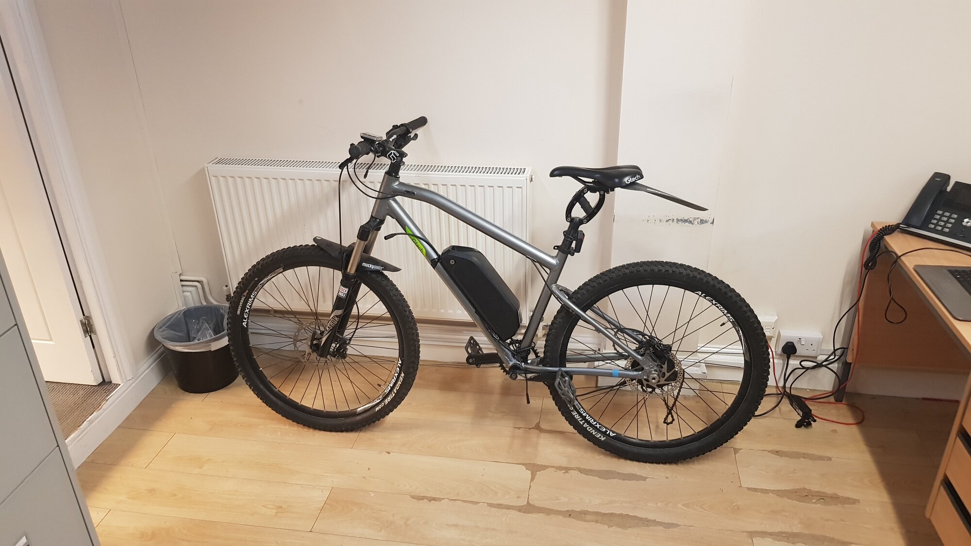

After 😀
The weight (considering the battery and controller have been replaced), roughly remains the same. So handling shouldn't be impeded.

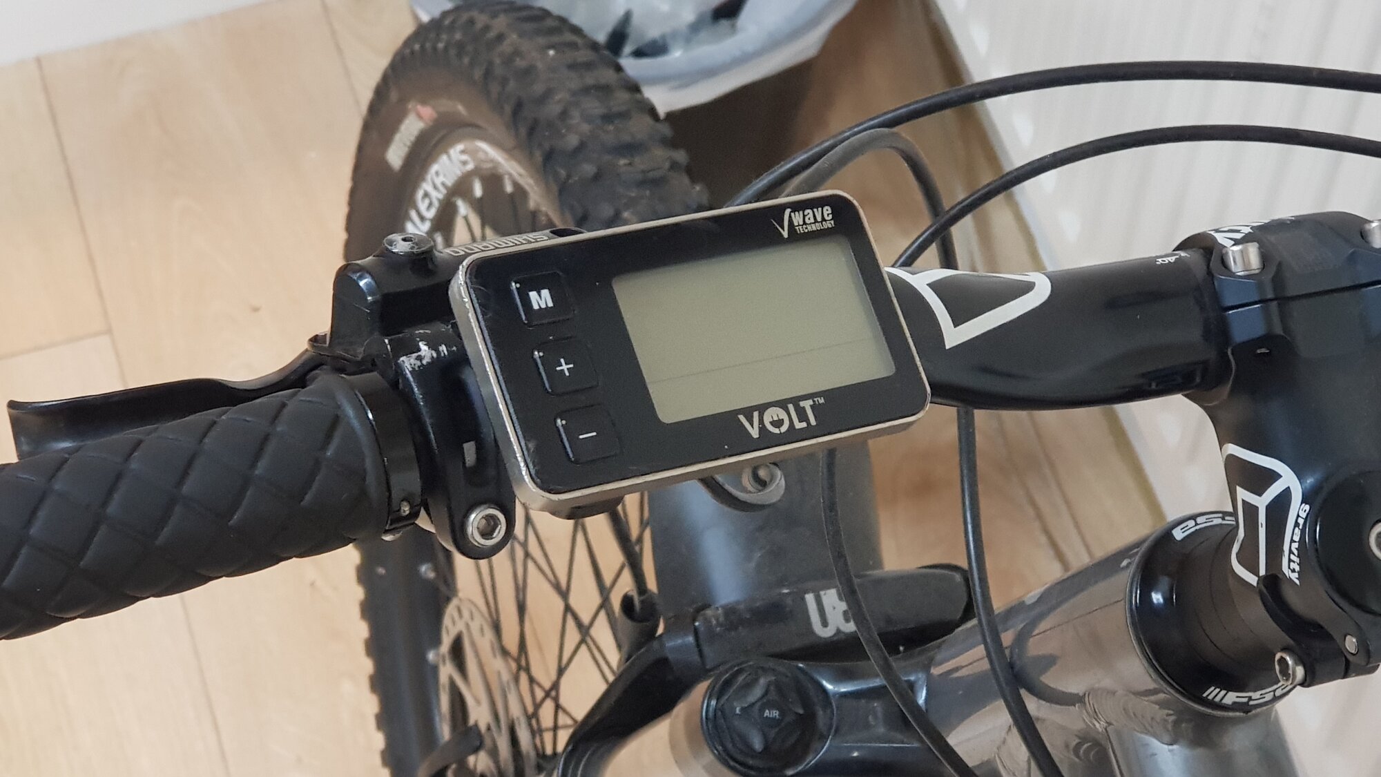

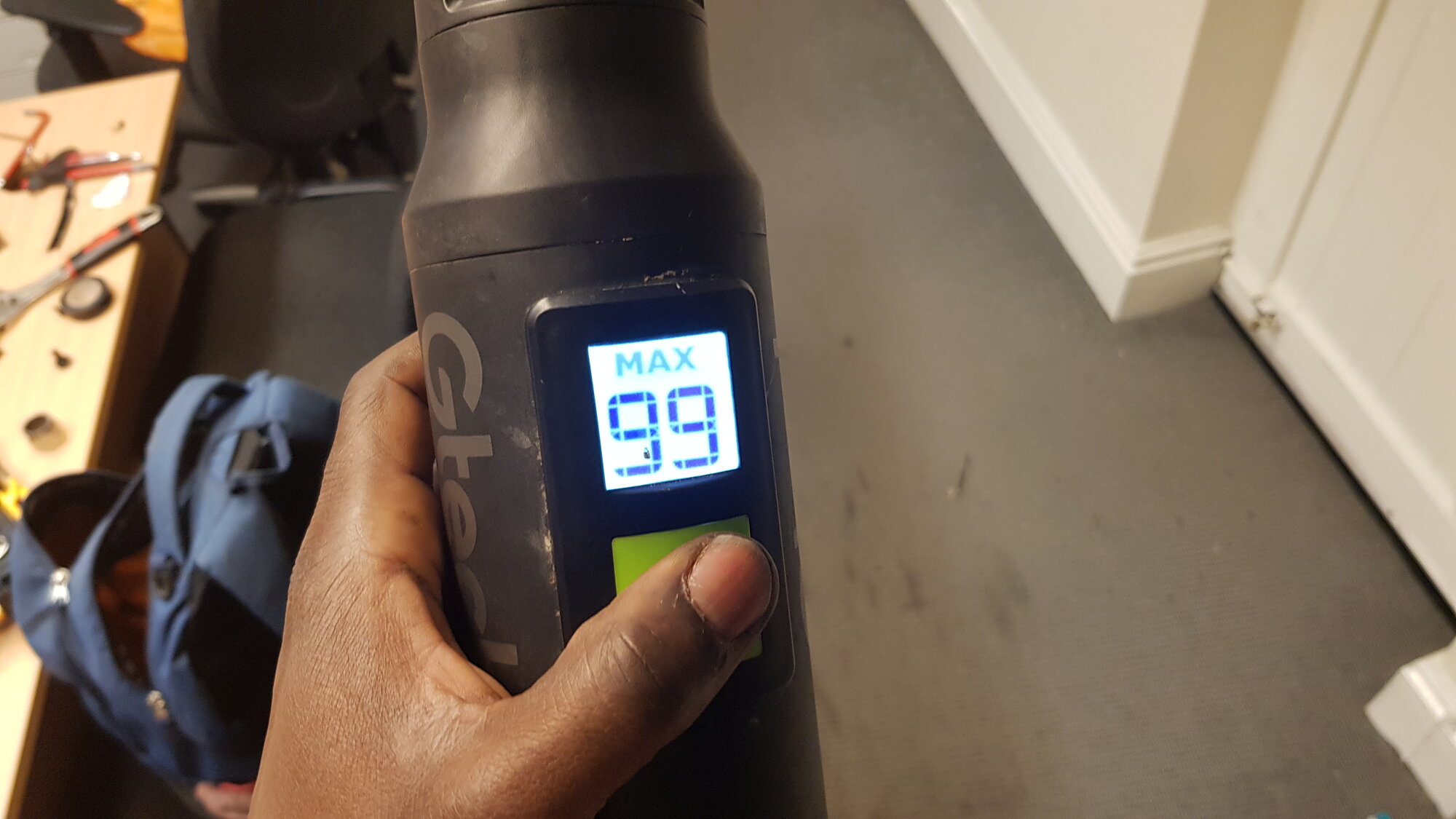

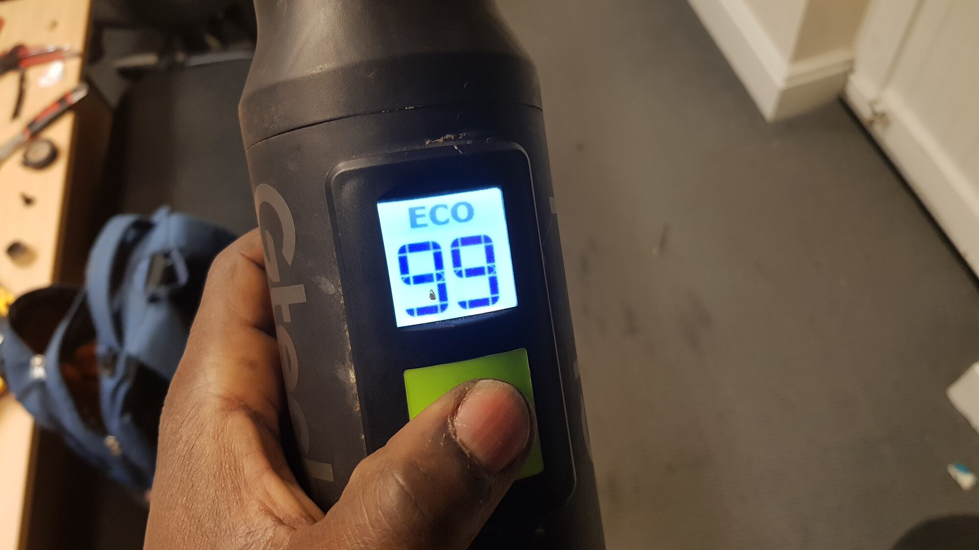

The G-Tech now has a display which allows the level of assist to be toggled via remote compared to toggling it via the battery.

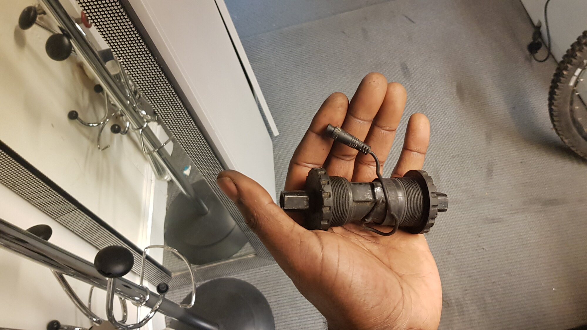

And the icing on the cake, I was able to retain the bottom bracket torque sensor 😄

Is that a front or rear hub motor? I'm guessing rear, because most folks do not put even small front hub motors on aluminum suspension forks, but just wanted to confirm. That thing is tiny!

Its a bafang rear hub motor. 500w. Ironically, this hub motor comes with a shimano freehub body compared to many which use a freewheel.
