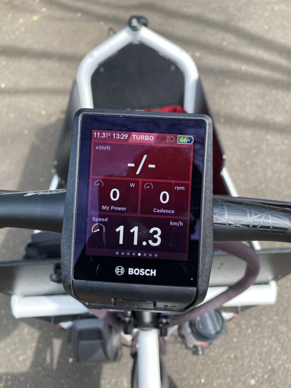

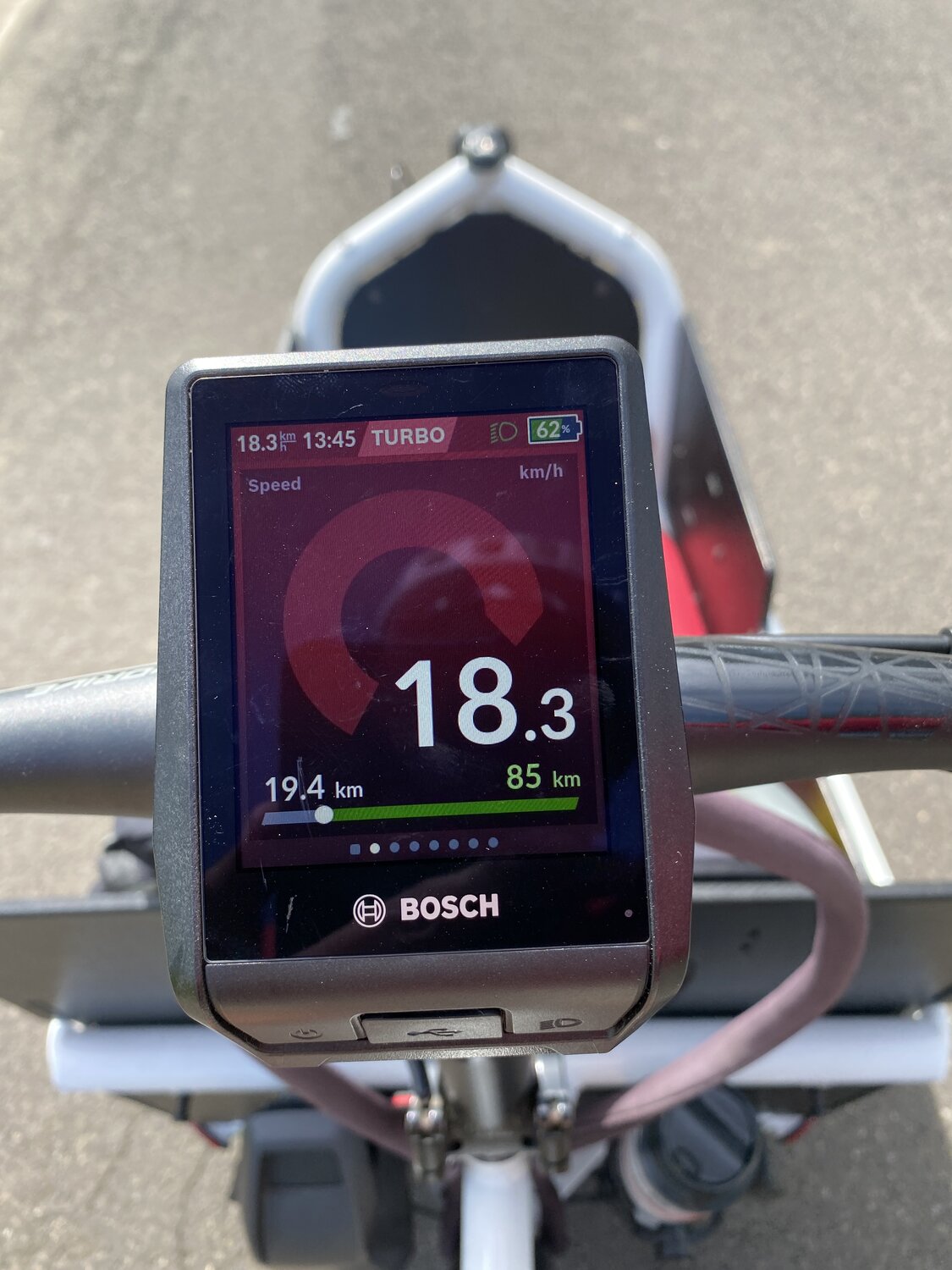

Unfortunately, despite us both hoping the problem would be fixed for good, I lost gear indication twice on the ride home, both mid ride (as in, ride normally, shifting, starting and stopping; gear indicator works then disappears). Pictures attached, but you'll see the gear indicator is missing on the main page and shows - / - on another custom page.
The eShift decided to randomly default to gear 1 once today. Also set off yesterday, with no drive at all, fixed by changing the assistance level then the motor kicks back in.
