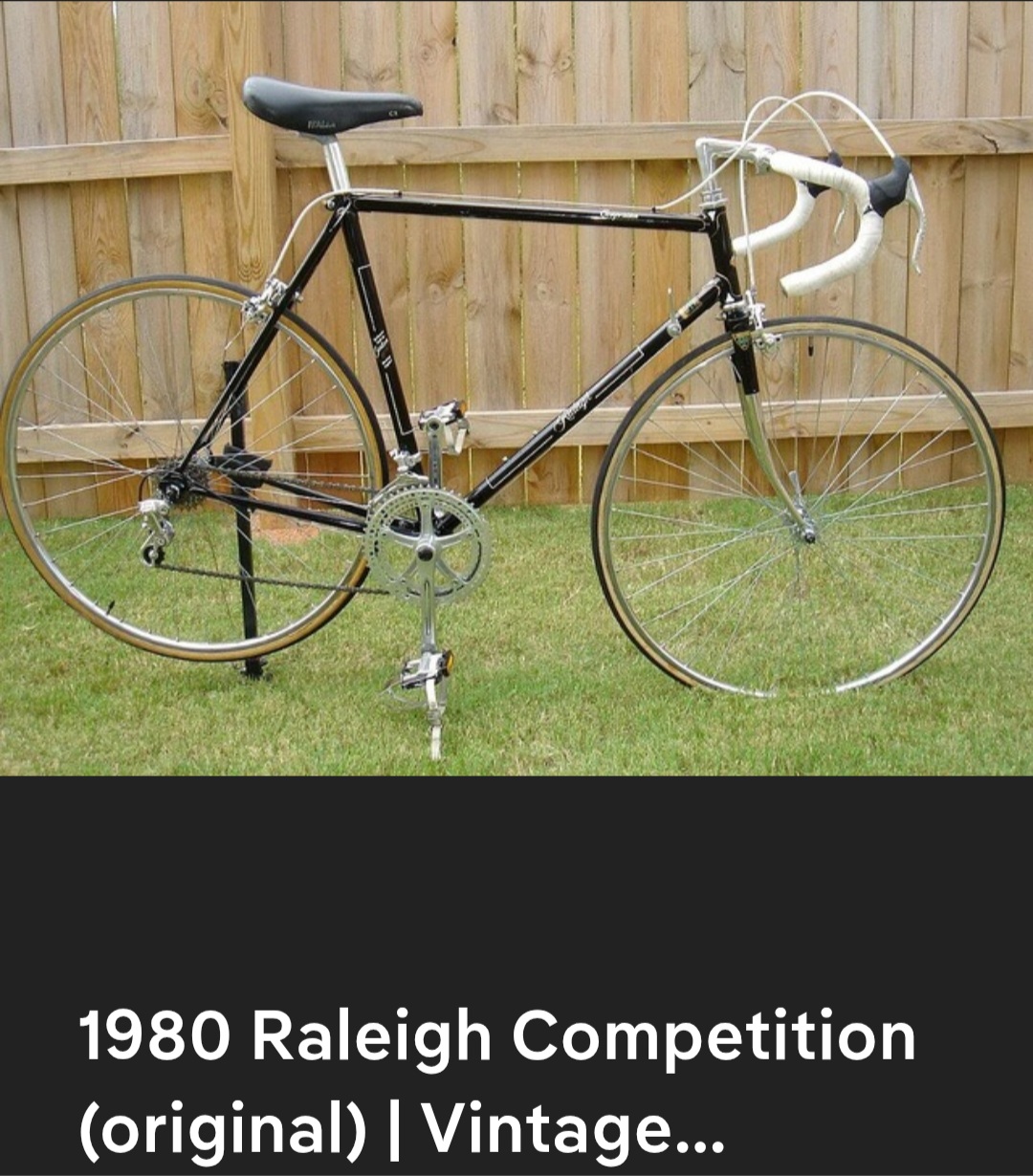

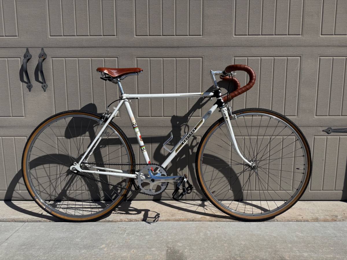

It's hard to compare road bike based e-bikes to bikes designed as e-bikes from the ground up. You just posted a bunch of pictures of road bikes, like the Peugeot and the Raleigh. For their era, the Peugeot had a "touring" geometry, and the Raleigh had a "race" geometry. Touring geometry today is mostly gone, with the exception of some products from Surly and Salsa and a few others. Gravel bikes these days have a geometry similar to the old touring bikes but with much more clearance for larger tires. My Pinarello is essentially an electric gravel bike with fenders and a rack.

I had a Raleigh 10-speed in the 80's that had a Very similar geometry to the bike @Marcela posted,..
My Raleigh was very similar to this, including the foot straps,..
I could easily ride it no-hands.

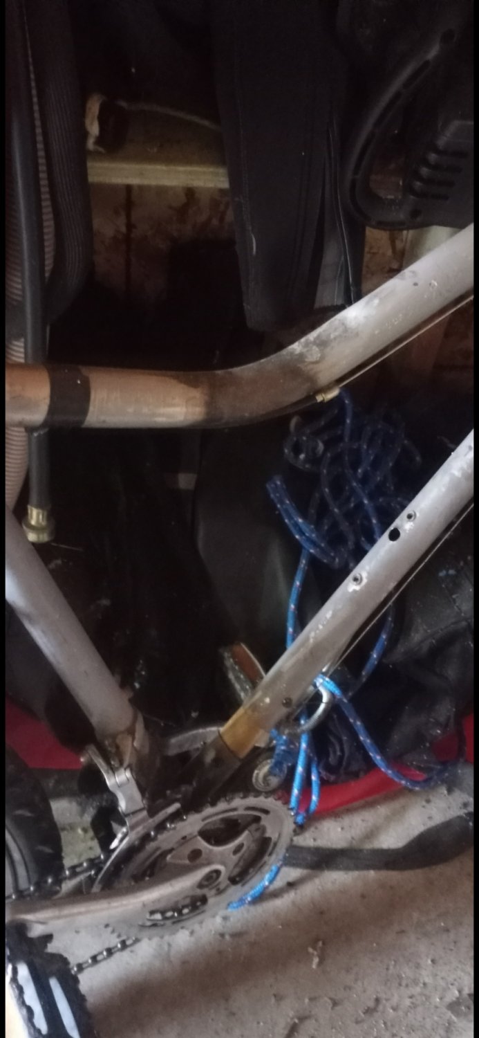

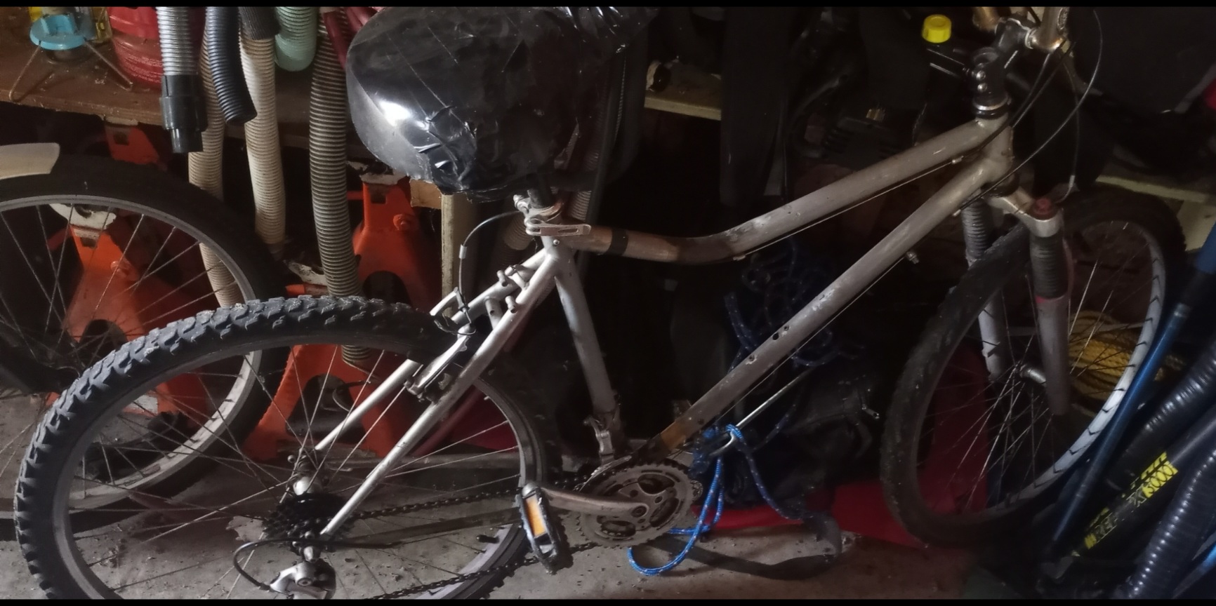

I bought a used Harrow mountain bike about 25 years ago that sucked to ride no-hands.
It was all twitchy because of that stupid "Quick Steer" crap.
About 10 years ago I decided to "fix" the quick steer problem by raking out my steerer tube.
I wanted to cut the steerer tube off, then weld it back on at a more appropriate angle, but I suck at welding.
So I cut the down tube, torched the top tube, and sledgehammered the top tube to rake it out,..
Then I reconnected the down tube with aluminum tubing bolted in place.
(That was a Harrow frame that already had a bent top tube. I just bent it more.)
So that's how much I Don't like today's geometry.

Those are the frames I like. The steel with that design fork with the forward bend. Not so sure about the mtb:), looks like something I'd do though.
