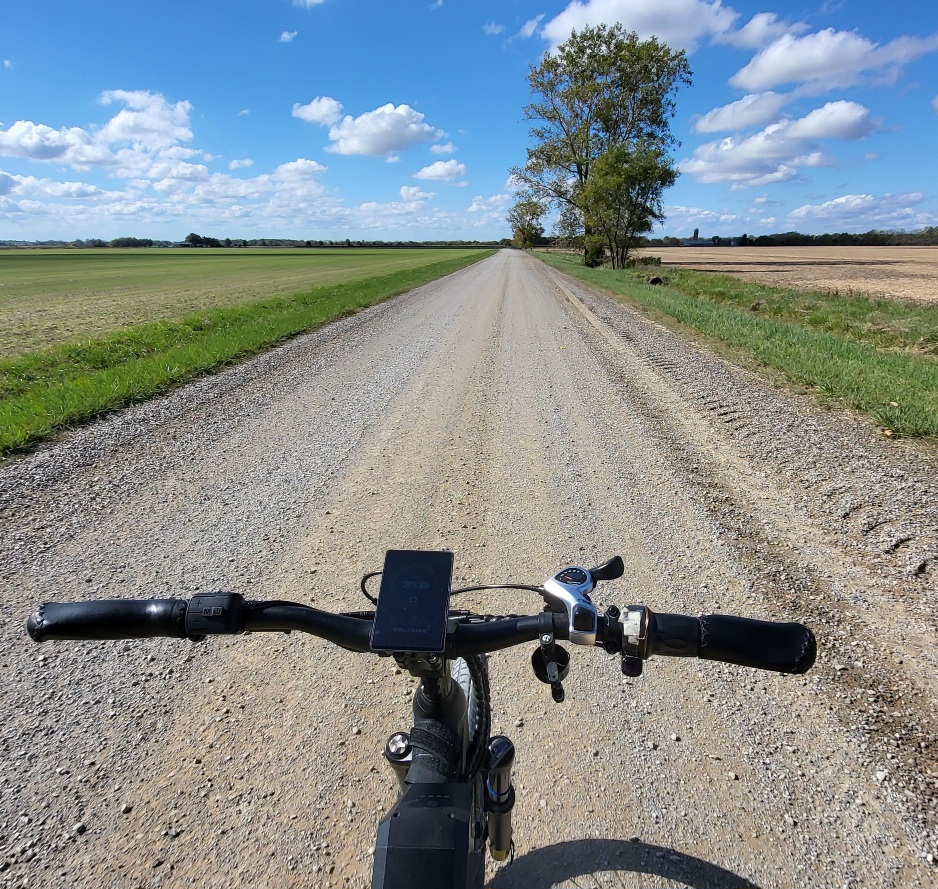

Seriously dude, I can teach you how to ride no-hands.
I know you like to lean on your handlebars but, is it possible to hover your hands over the grips without them holding you up?
If so, wrap your hands around your handlebar grips without touching the grips.
Hover your hands, ready to grab the grips if you have to.
Practice on flat level ground.
Practice alone.
You don't want to show off or embarrass yourself.
I was riding 32 kph when I took this picture.
No-hands
No audience.
