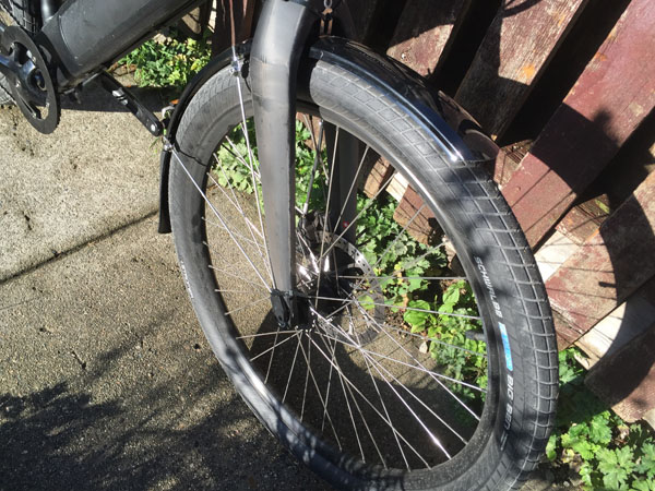

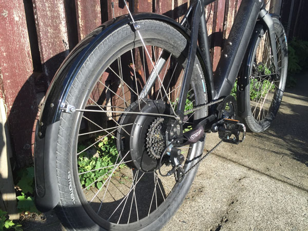

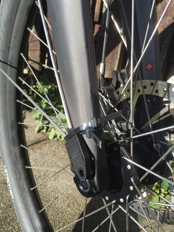

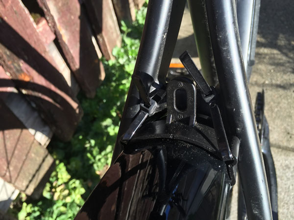

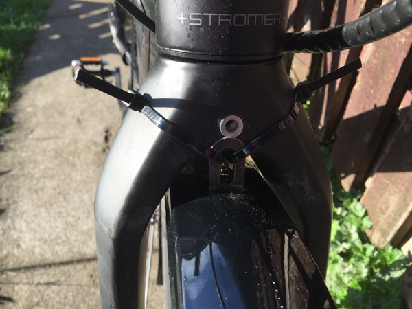

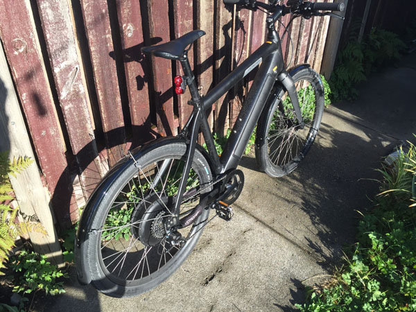

Hi, welcome to ebike s. I have same fenders on my hybrid and used zip ties also on front, My fender keeps rubbing tire so need to put a bolt to make more secure. When I charge my. St2 stromer I remove the battery . Don't know about bike plug in door on an St1, but if chargers plug is magnetic , I would get something to slide on plug end so you don't inadvertently touch poles of battery with something stuck on end. I love your city. Did you know Endless-sphere.com store is there ? Supposed to be lots of bike shop s near them. Went grocery shoppin with trailer yesterday. Rode great ! Saw at least 30 other bicyclist s! Austin has really got onboard.
Hi Robie, and thanks for the info. Never heard of "Endless-sphere", will look it up. The fenders work great, no rubbing at all. Mounted them with 2 screws in the back and 1 in the front, the rest is being held together with cable ties ;-)
