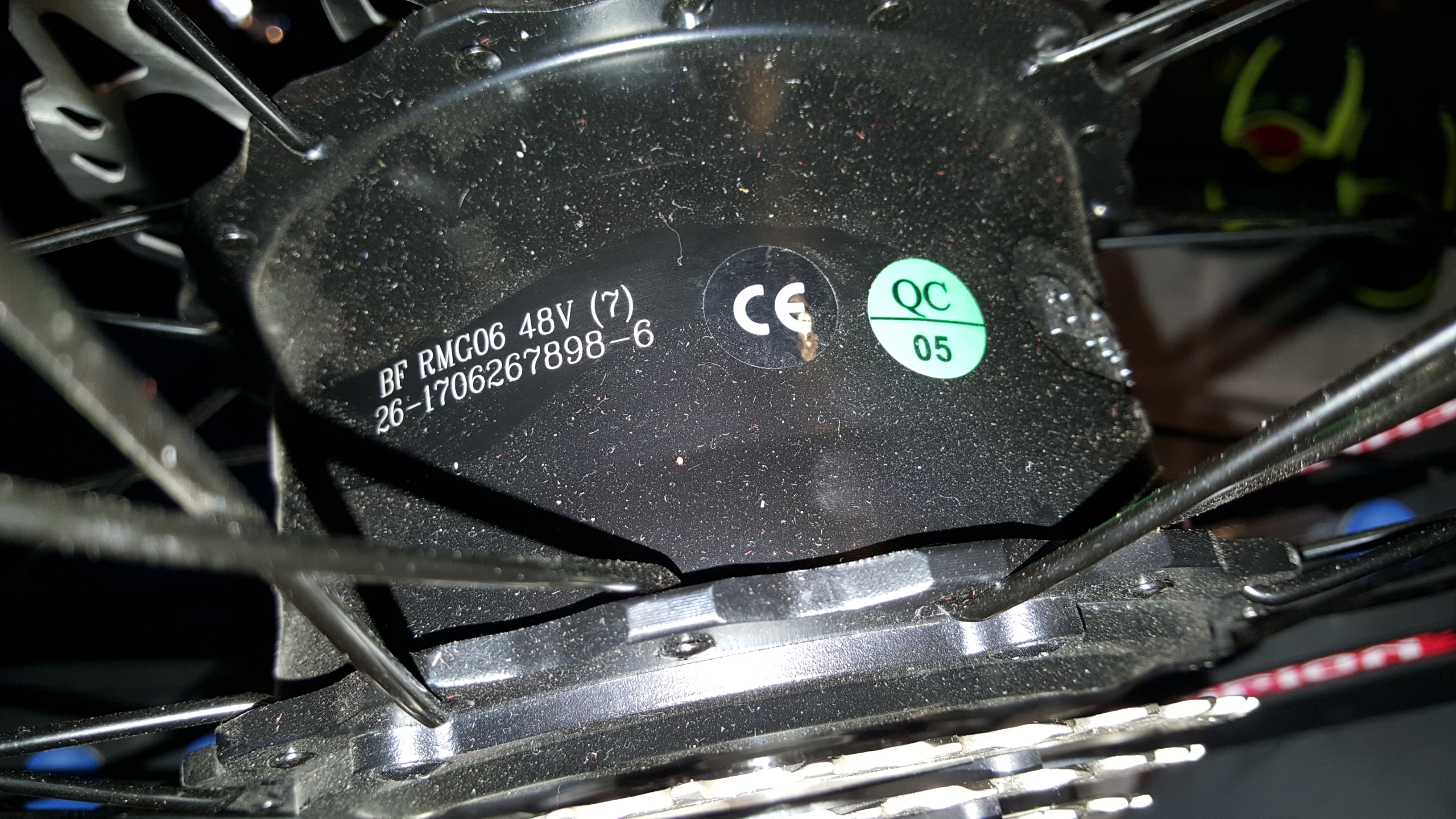

I just got my hub back from Bennoit, this is what I got. View attachment 19243 View attachment 19243I have a post asking if anyone else has gotten the 500 watt hubs? And are they going to return and get The proper hub!
The cable end is octagon shaped.
So Benoit did confirm you that was a 750watts motor?
Maybe @Jim Carroll you should look at the controller just to be sure! Then again you could just try your bike and if you can go on flat surface over 40km/h on full assist you may have a 750W mine will max at 37km/h.

I greatly appreciate the photos from everyone.Dan did you recieve the same hub refurbished or is the hub you recieved a totally different hub????

The receipt shows I ordered a 750 watt bike.When the bike arrived I looked the box over quite thorough to see if there was any designation for motor size and could not find any.
The only thing I could find was the motor number which appears to be a seriel number of sorts.
I tried emailing Benoit but it was after buisness hours hopefully I will hear from him tomorrow.
If not i will phone him.The fact that the number on my hub is so close to Dan's makes me feel a little better.

I am hoping it's missing the v750watt designation due to who bought/ordered the motor. mine does have the octagon shaped connector. Like the one listed on Amazon.

It is designated on the controller what the power rating is 500 watt or 750 watt.

Yeah I can find nothing deffinative that states this is a 750 watt set up?
Dan,after looking at the controller pics I posted they appear to be the same pic only the power rating has been photshopped or changed.
I will check Ali Express to see if I can find a pic of the controller you posted.
It would be nice if Benoit would chime in and set us straight.
Just received an email from Benoit reassurring me that the motor number is a 750 motor.
Chances are where our motor numbers are only a few digits off we both should be good.
