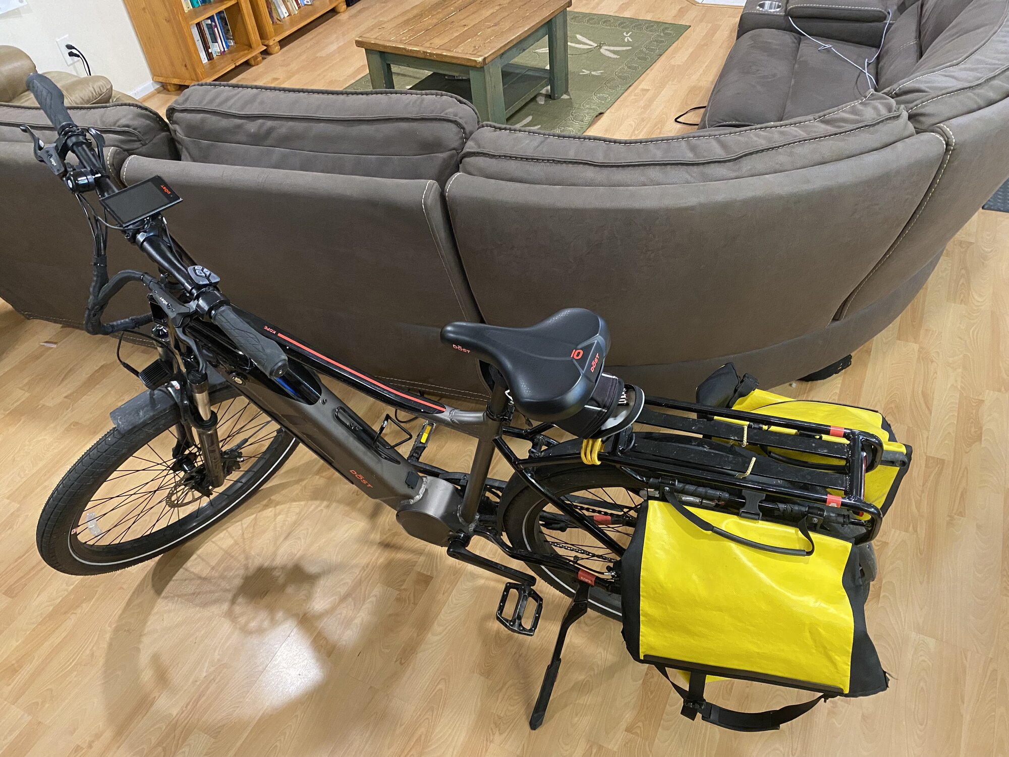

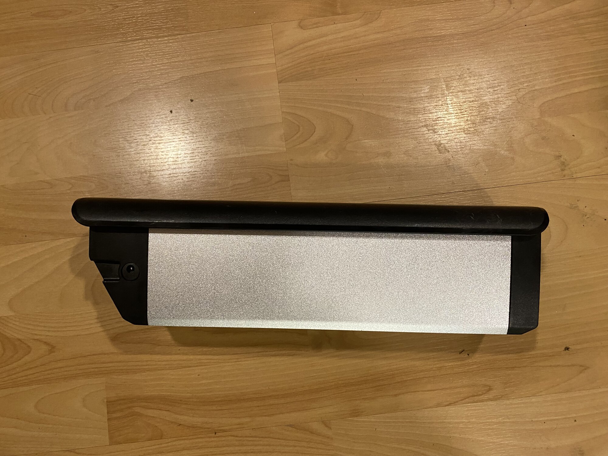

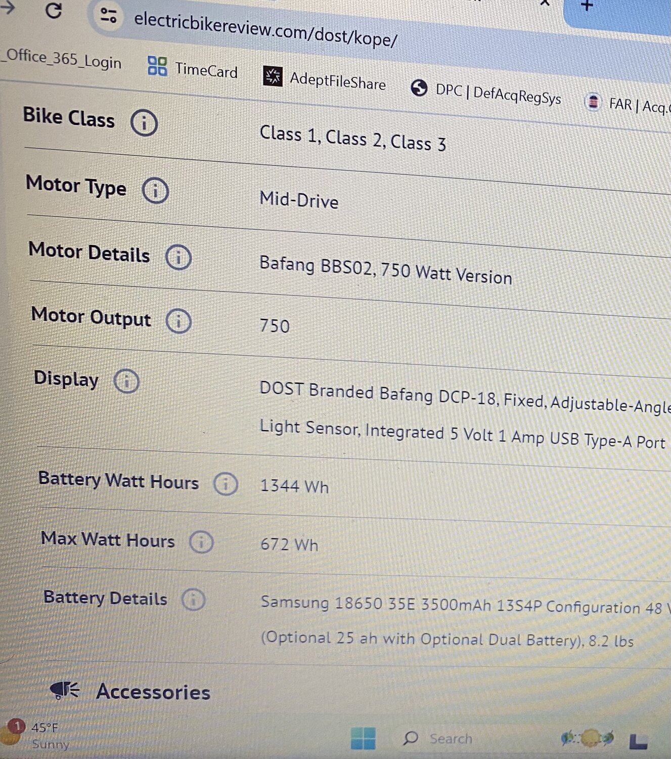

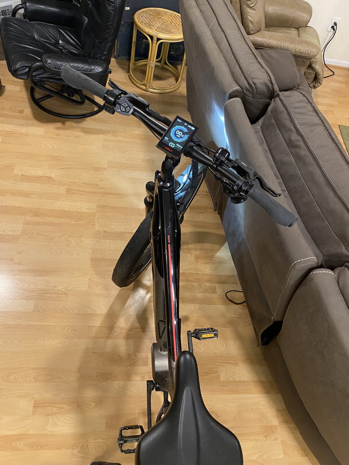

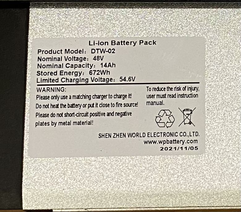

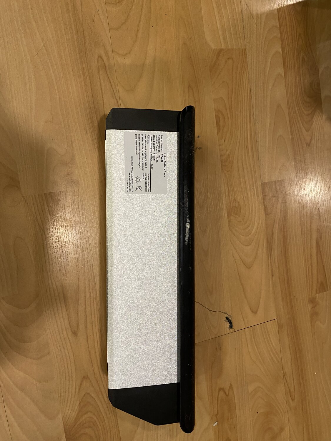

Thanks so much. I registered w/EBR much too late. Should have done it right after the bike delivery was delayed by several months. I’m in Northern Virginia. How can I tell if the connectors are proprietary? The battery is not. Some photos of the bike, specs, and battery attached.

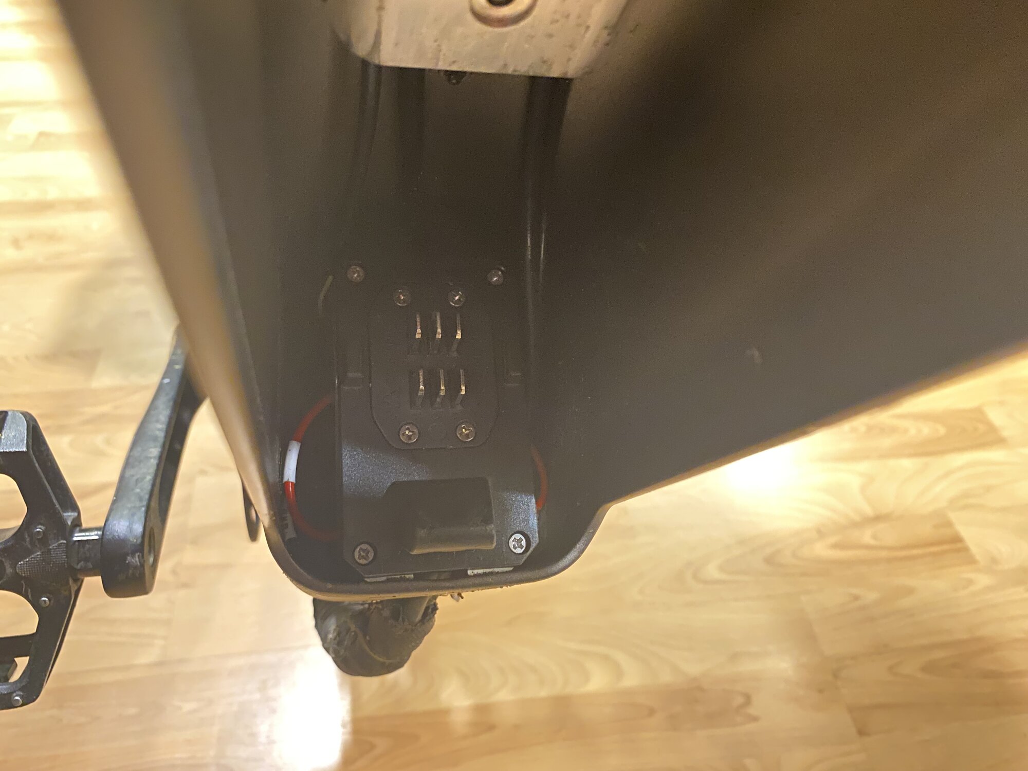

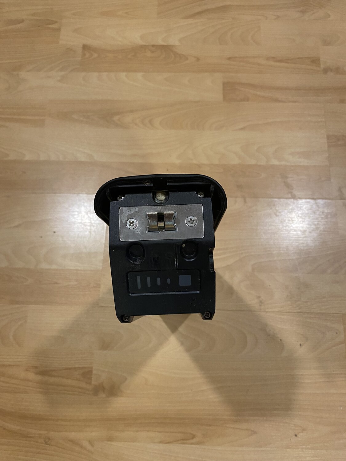

48 v 14 AH battery is nothing special. You picture of the battery does not show the connector. No sight, no guess. If the battery connects to a floppy connector on a wire, good. If the battery wedges into a socket on the frame and the battery contacts slide onto each other, likely a unique design. Bad. A picture of the slot on the frame would also be useful to the experienced. One label showed Dost Kope branding. Look at the Dost brand thread. https://forums.electricbikereview.com/forum/dost/

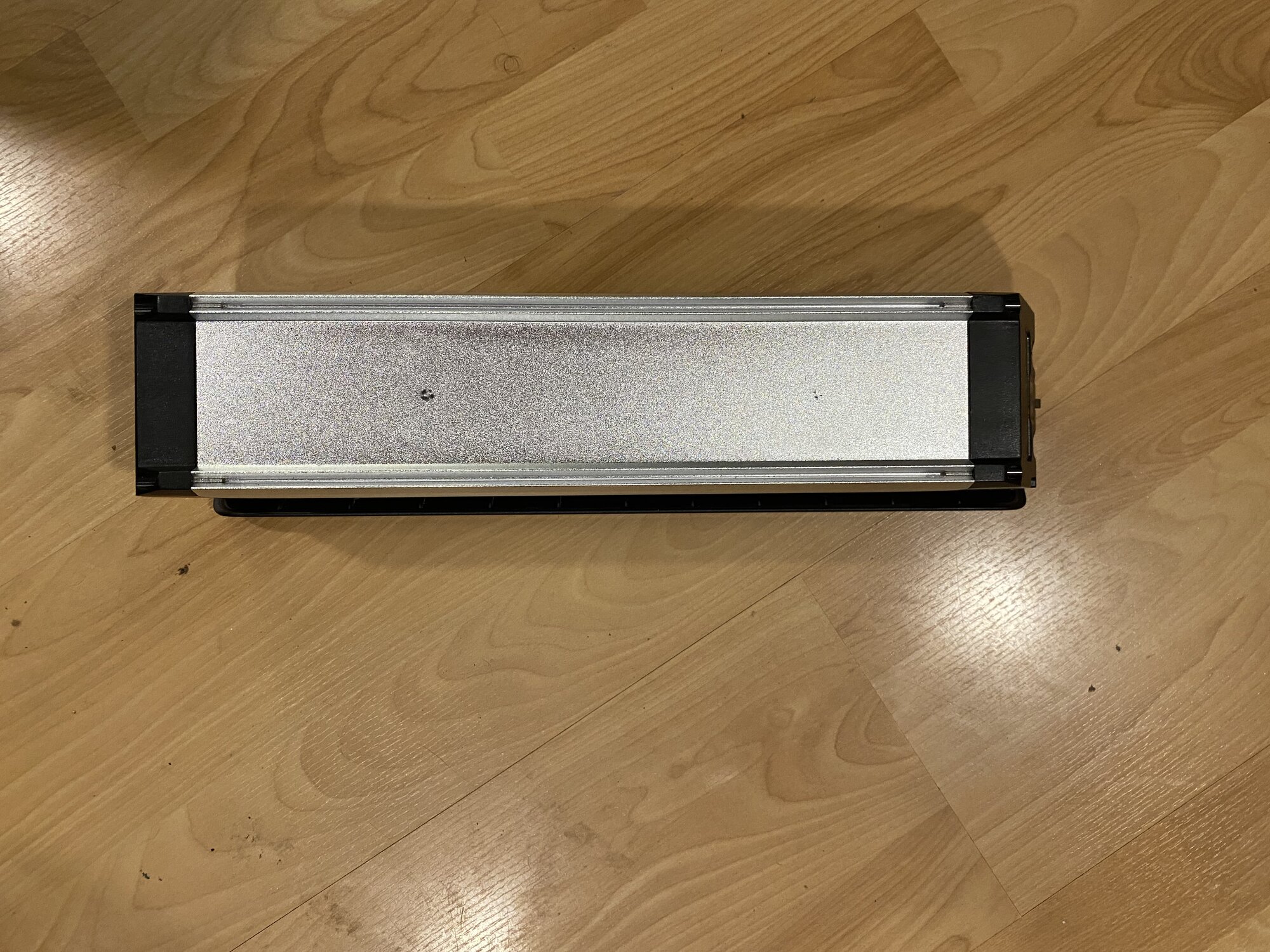

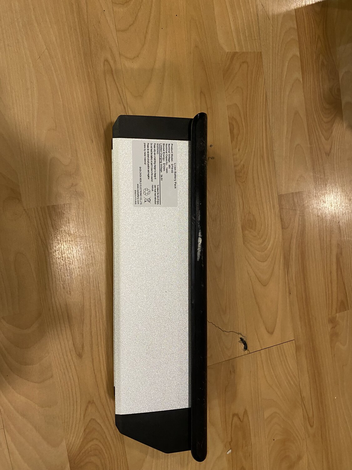

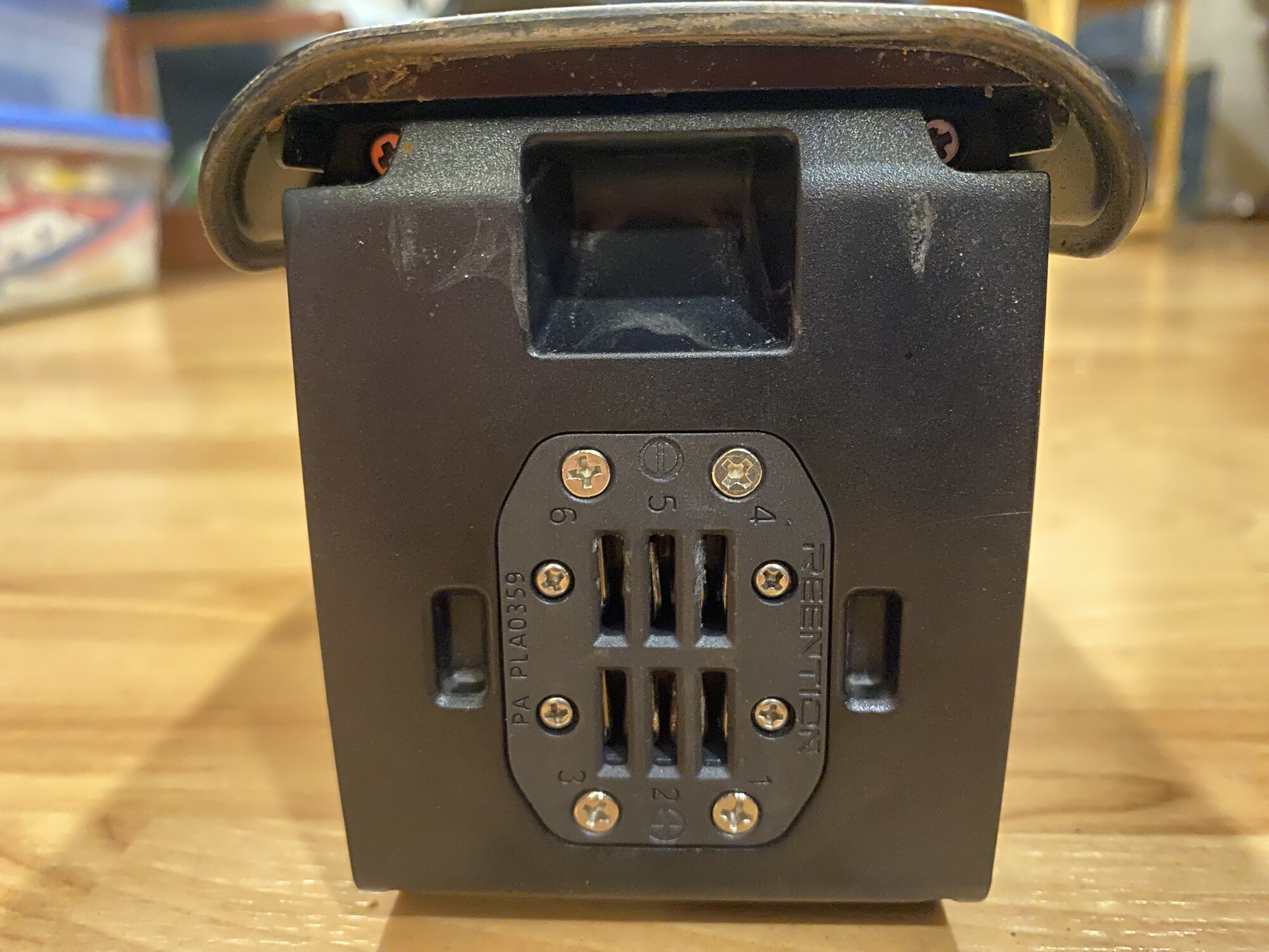

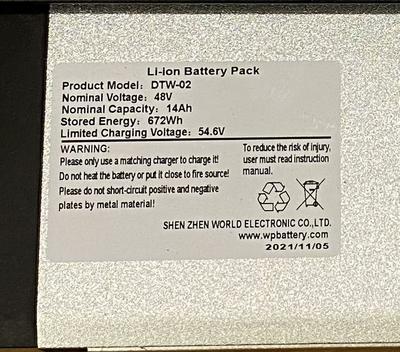

This is helpful. Looks like the battery is in the “Bad” category (see photos). In the Dost Forum someone suggested a battery repair shop ( https://www.hicbattery.com/) They provided an estimate. Another person showed a bike company w/a compatible battery. I’ll ping the Ohio source as well. Thanks again!

That battery is proprietary as hell. They lied about those cells. Cheapest generic, not Samsung as stated. That shows premeditated intent to defraud and then to go bankrupt. I will bet they never had any geo located verified user reviews on google maps. That is a must. Just their website which they could edit. The stated battery maker is considered counterfeit by my browser so I am blocked. Solution: Find a local reputable independent eBike builder. Have them install and splice in a high-quality external battery using premium cells, premium BMS (battery management chip) and to do it in cleanly, sealed from weather. In my neighborhood, I do this regularly. Sometime I help folks to order on their own a cheap battery just to sell a bike and move on. And I give them detailed instructions on how to do it cleanly and safely. That consultation is all in person and local. Ask your neighbors. The more local the better.

It's a Reention battery case which is a mainstream case maker. You should be able to find another battery builder that uses that particular one.

Why am I not surprised by a cheap counterfeit being installed. 😡 I’ll search for some local eBike builders. The frame and funky battery connectors look like the only unique parts of the bike. Everything else looks standard. Thanks!
