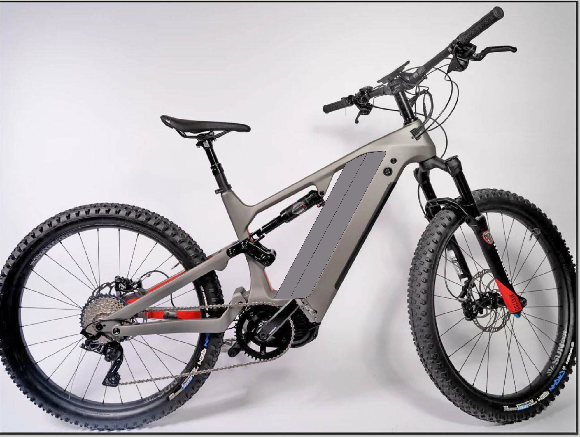

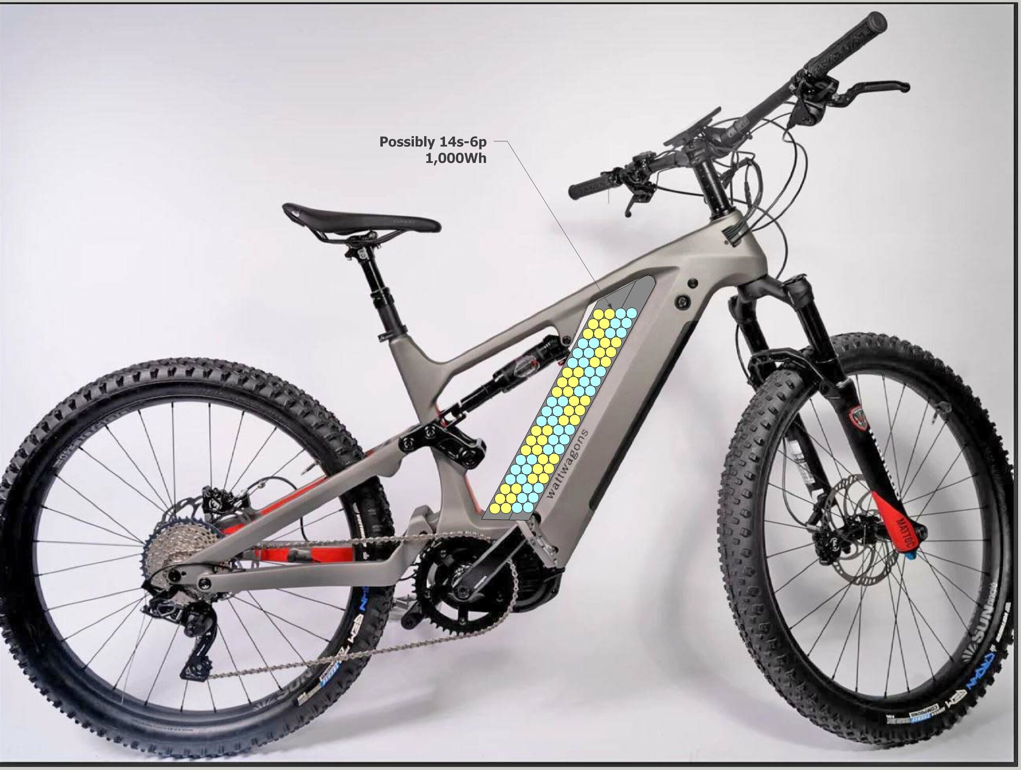

Regarding extended battery in the Hydra, I have been doing some mockup, and it may actually be possible to double the Current capacity in a nice looking package. I will need to confirm more of the downtube and frame dimension to be sure or try other configurations.
Below is what a secondary battery above the Downtube could look like

I like the separate battery on the inside of the triangle but as you probably know having 2 separate batteries and using them concurrently poses its own problems as well as charging.
You could mod the frame easily enough for the hook-up I guess but there is not much room above the motor for any additional wiring but not knowing this particular frame maybe there is additional space or void that would be great.
