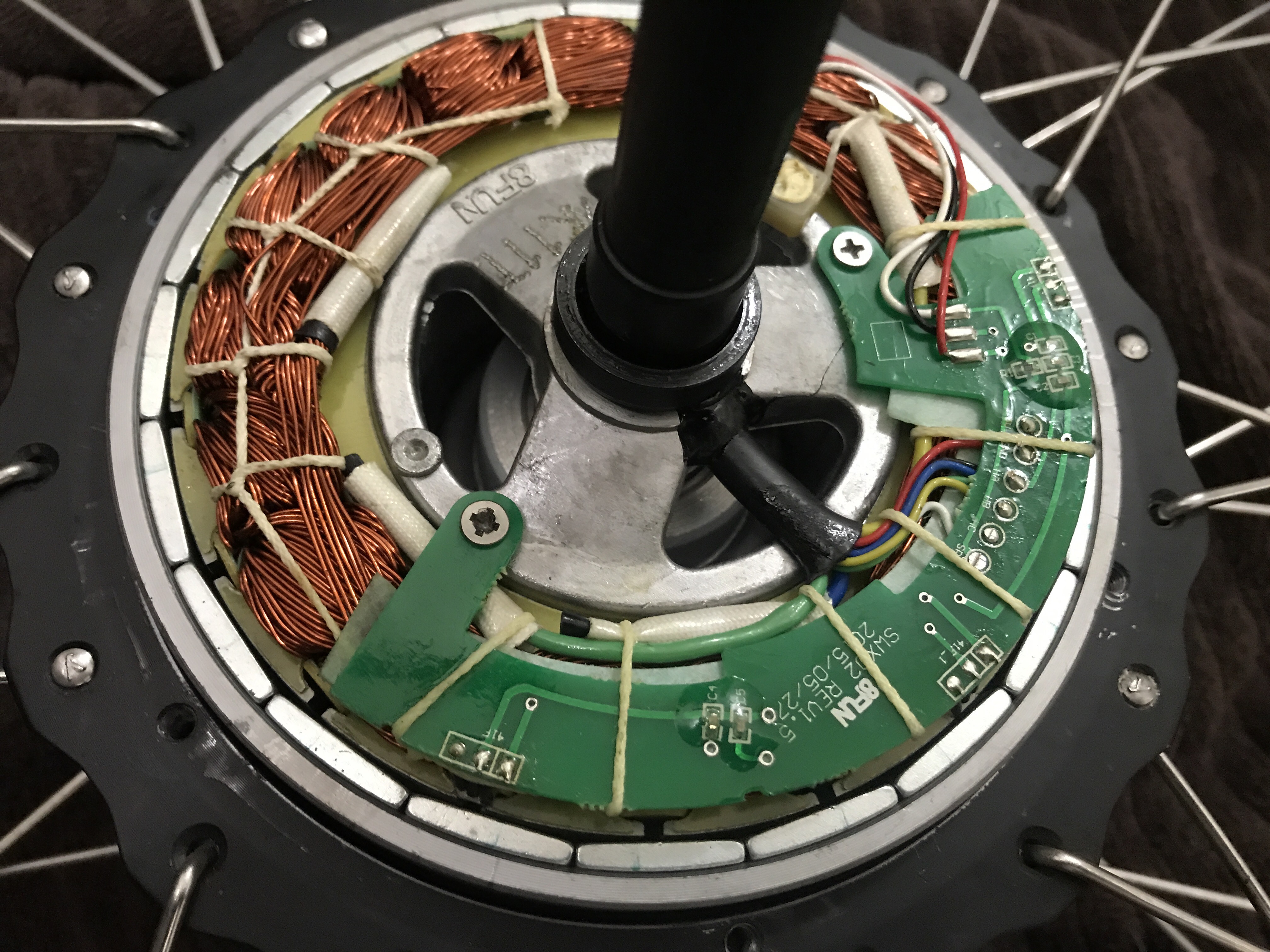

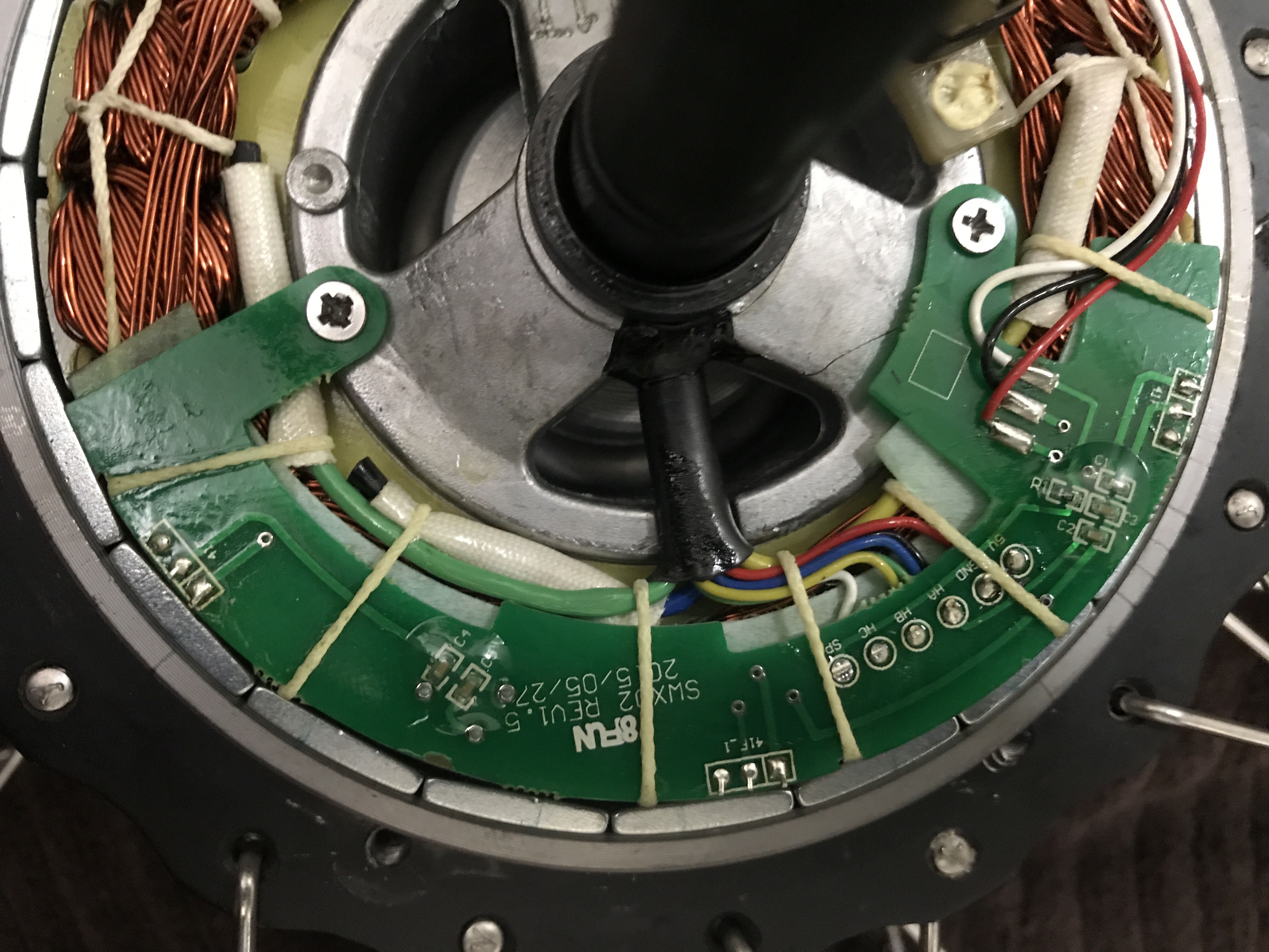

Fit like a glove. Here is a picture of the freewheel side of the motor. Unfortunately I did not take both sides off so I could not see the internal gears but I plan to swap the hall sensor as I'm not getting less than 4V when I measured them so I think they may be going bad. I will post some pics when I do that swap. They are more than likely a resin of some sort (PA66 maybe?).

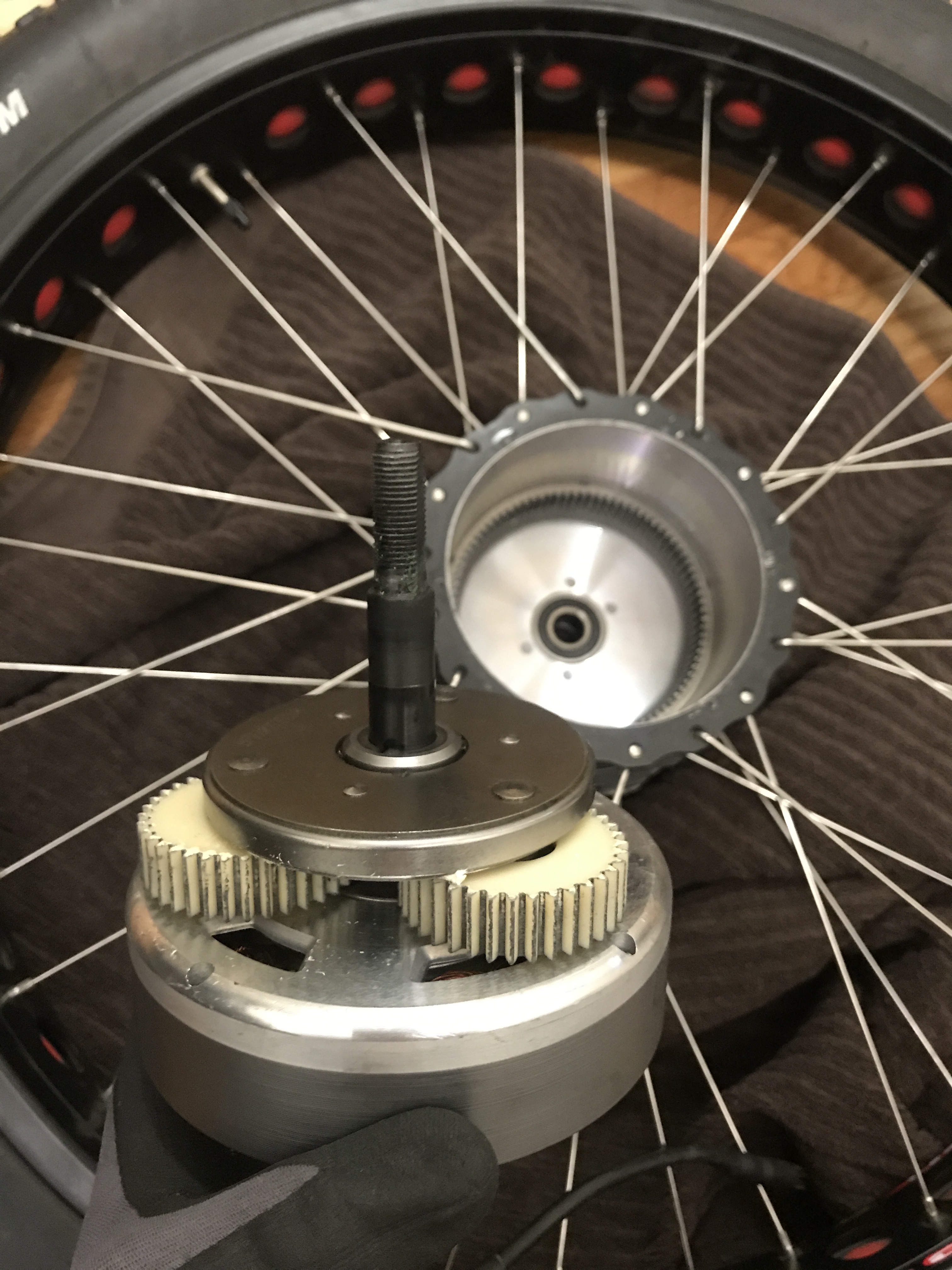

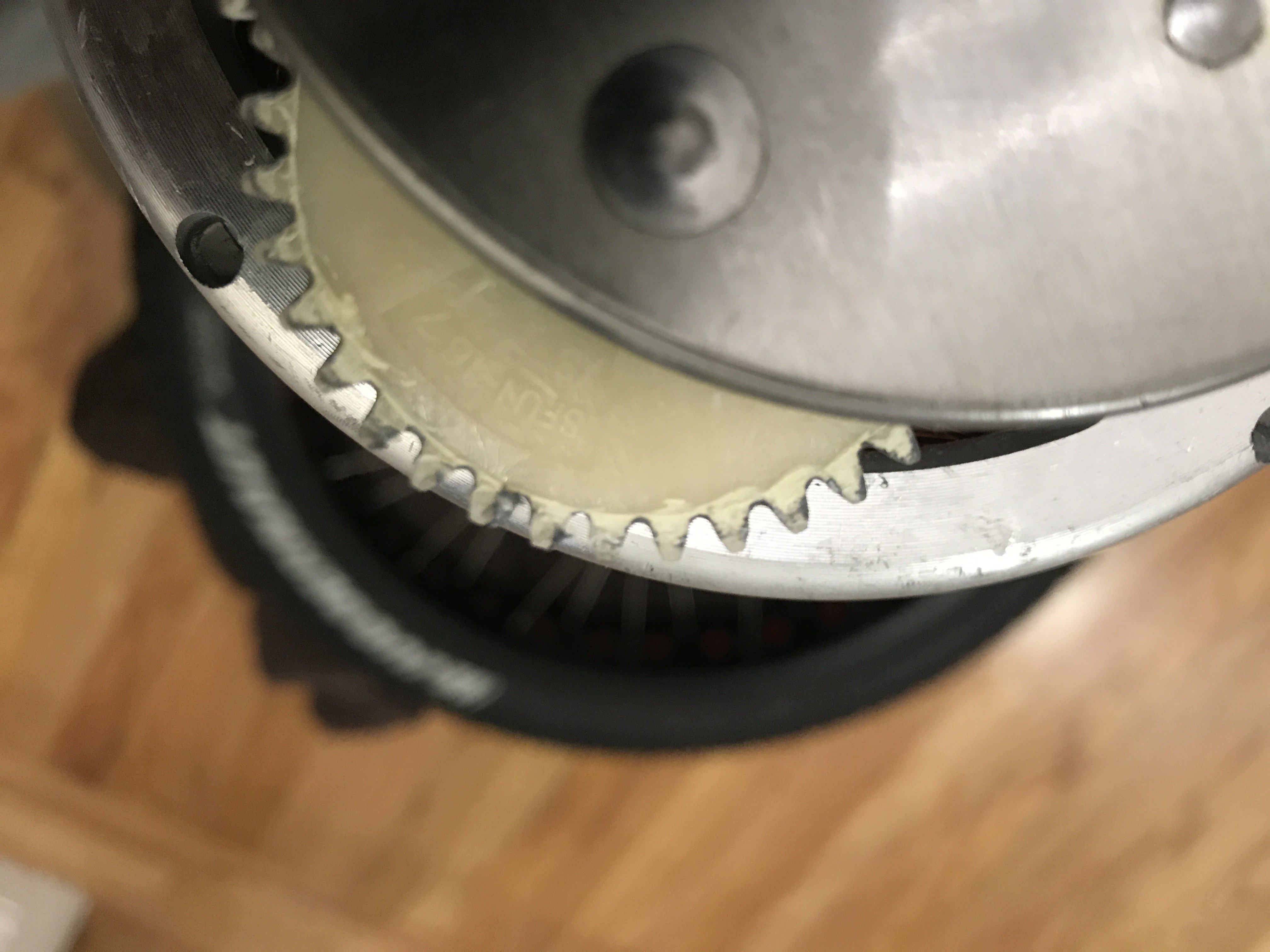

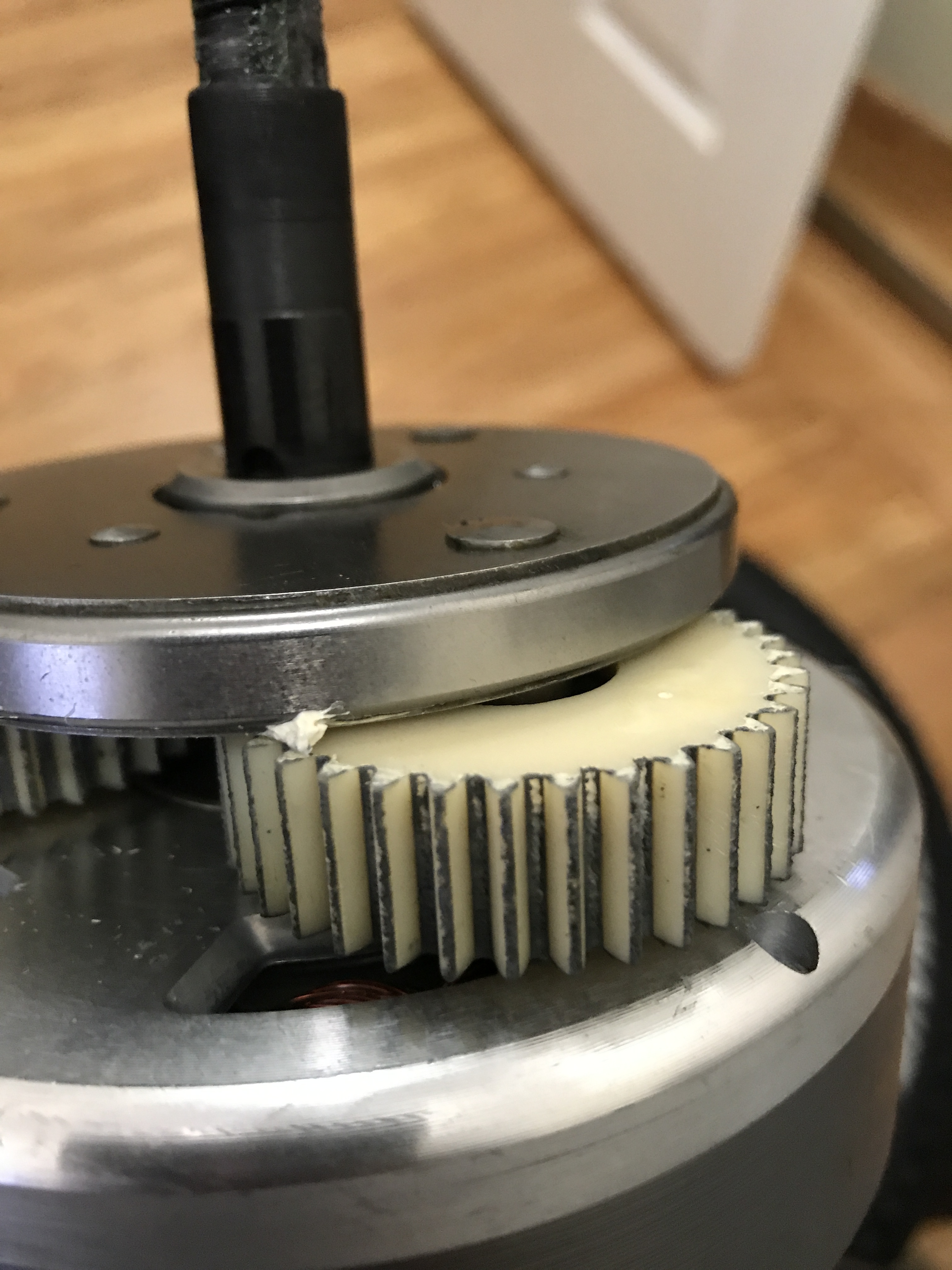

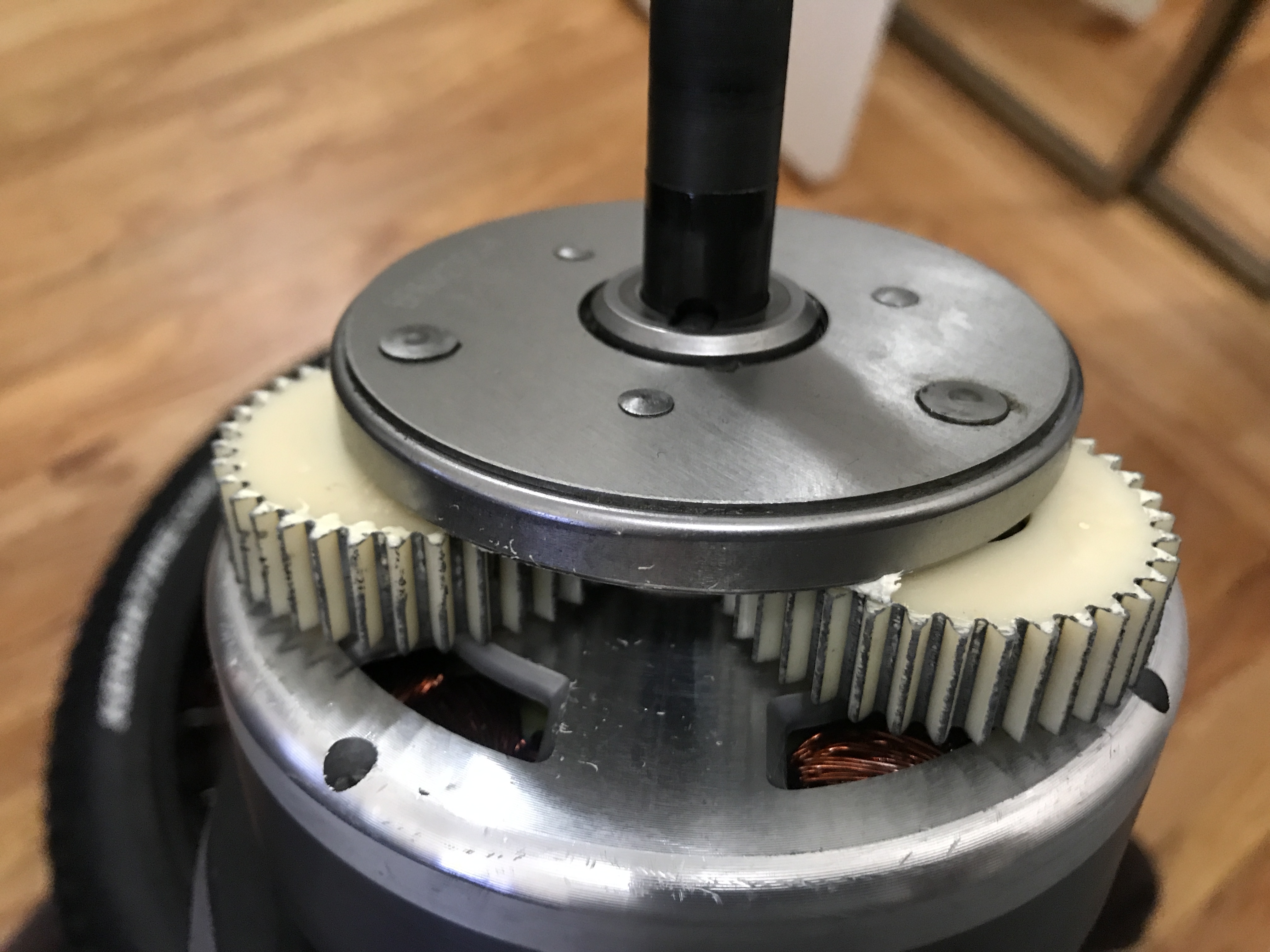

Here are some pics of the motor taken apart showing the plastic gears (looks like a PA66 material or similar). I had to fix another puncture in the rear tire so I decided to take a look while I had the rear wheel removed.
View attachment 17532 View attachment 17533 View attachment 17534 View attachment 17535 View attachment 17536 View attachment 17537
Thank you for those pictures, very much appreciated. I too was curious and did think the gears were made from some sort of composite material, nice.

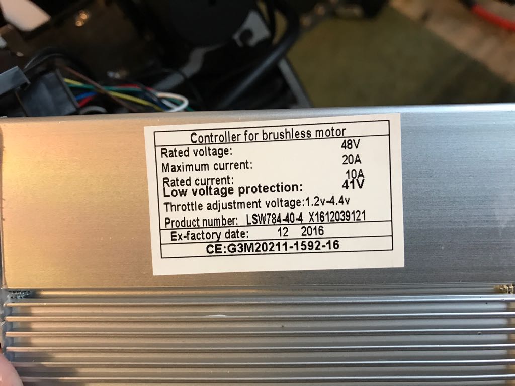

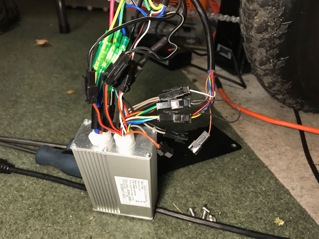

I have a Mariner and believe the controller is similar to the Yukon 750. Here's a photo of the Mariner controller. I was able to decipher/trace majority of the wires, but none that seems to be able to disable the speed limit. Perhaps it is wired inside the Hub motor?
Any insights by other members???
As far as I can decipher:
Thick Red/Black: Power to the controller
Thick Y/G/Blue: Power to the Hub Motor
Attached R/Blk/W: Some sort of signal relayed from the Hub Motor (most likely the throttle)
Controller R/Blk to Exterior Blk/Blk-w: Power to attached bike lights (on/off controlled by an unknown signal (wire) going into the controller)
Controller Light Blue/R/Blk: Cadence sensor (the 12 magnets disc)
Now here comes the fun part:
Exterior R/B/Blk/G/Y: This is the cable strip that connects to the LCD Controller (R, Blk: is most likely power; rest is most likely transmission of data)
Controller R/Blk/Green-Yw to Exterior Grey/Purple: ???? Unknown (My guess is brake lever cut-off sensor)
Controller Dual Grey/Blk to Exterior White: Unknown. I trial and error this wire hoping is the speed limit but unfortunately is not. If unplugged, then brake lever motor cut-off would not function. If plugged to the Single Grey/Blk connector, appears to make no difference - both brake lever motor cut-off still works.
Controller Single Grey/Blk: Unplugged. Unknown
Controller Grey/Red *male: Unplugged. Unknown - some how the plug appears reversed, controller plugs mostly female.......so my deduction is this is some sort of power feeding to bike accessories just like the bike lights plugs????
Exterior Brown *female: Unplugged. Unknown. Based on the manual simplified wiring diagram, the bike lights is labeled "Brown". So my deduction is this wire is to control brake light if the bike is equipped???
The Blk wire loop: This loops one ground to another. Probably has nothing to do with speed.
