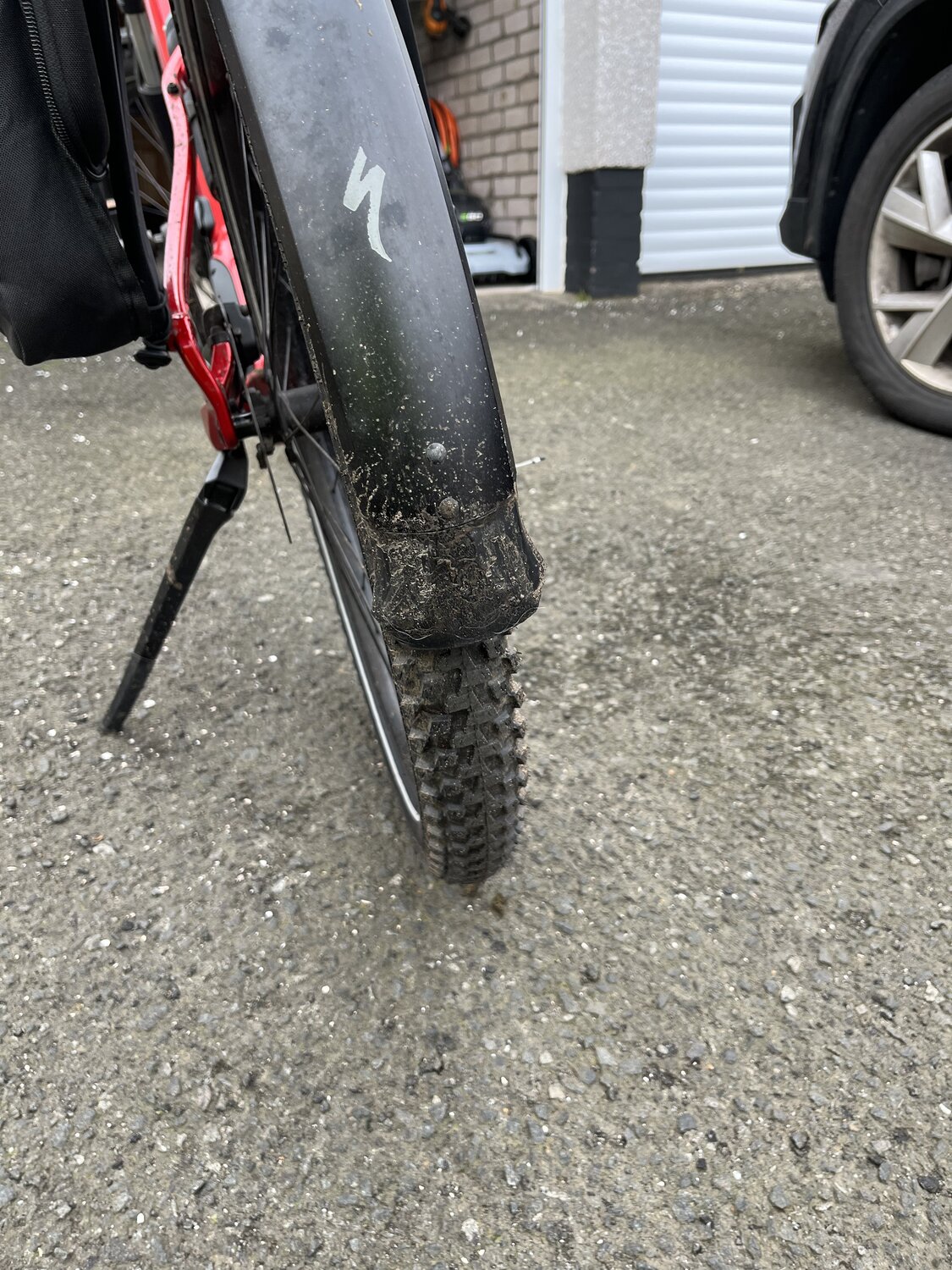

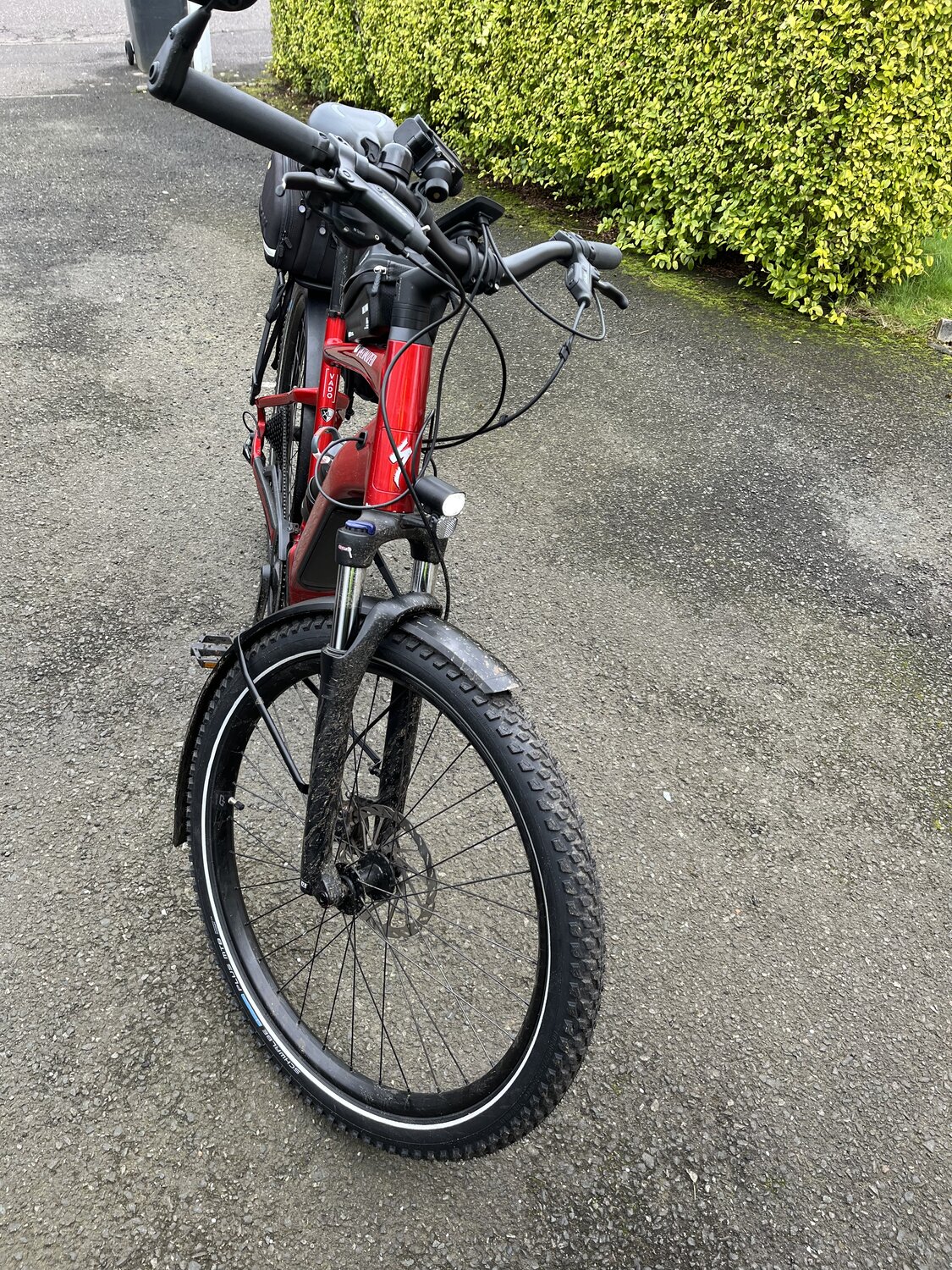

Well, after a couple of punctures recently in my Pathfinder tyres I decided it was time to experiment with some new an hopefully more robust tyres. It’s just NO fun trying to change a tube in the Scottish winter weather, and even though I had slime in the tubes I still go the punctures. Both times right in the smooth centre of the tyre, a tiny thorn barely big enough to see and damned difficult to get out. There is so much debris about just now that I found myself slaloming down the paths.
I decided to go for a MTB tyre and liked the look of the Schwalbe Marathon plus MTB tyre….not cheap but they looked good so I bought a couple of 27.5 x 2.35. Heres a review of how I found them…
  1. They look great on the bike I think.
  2. they are a good fit for the bike.
  3. Tricky to fit…you need to make sure the tire is fully in the centre grrove of the wheel. The front one was a nightmare but the back one went on fine.
  4. They are super quiet….it’s hard to believe they are MTB tires.
  5. Very smooth and I think they feel more nimble
  6. they felt more secure in soft stuff….light mud and rotted leaves on the paths
  7. Didnt get a puncture…Phew!
Performance…I really expected them to perform less well than the Pathfinder, but No, quite the opposite. I did the exact same trail with the old and the new tires, conditions similar, and used the App to Log the peformance.
MeasurementPathfinderSchwalbe Marathon plus MTB
Distance30.11 miles30.32 miles
Moving Time2:30:332:29:37
Avg speed12 mph12.2 mpg
Battery used62%59%
Max speed27.2 mph26.8
Cal burned551584
Avg motor power157w154w
So, all in all I am delighted with these tires and hopefully look forward to (hopefully!) many more puncture free rides!😊
Here’s a couple of photos…sorry hadn’t got round to cleaning the bike yet!
