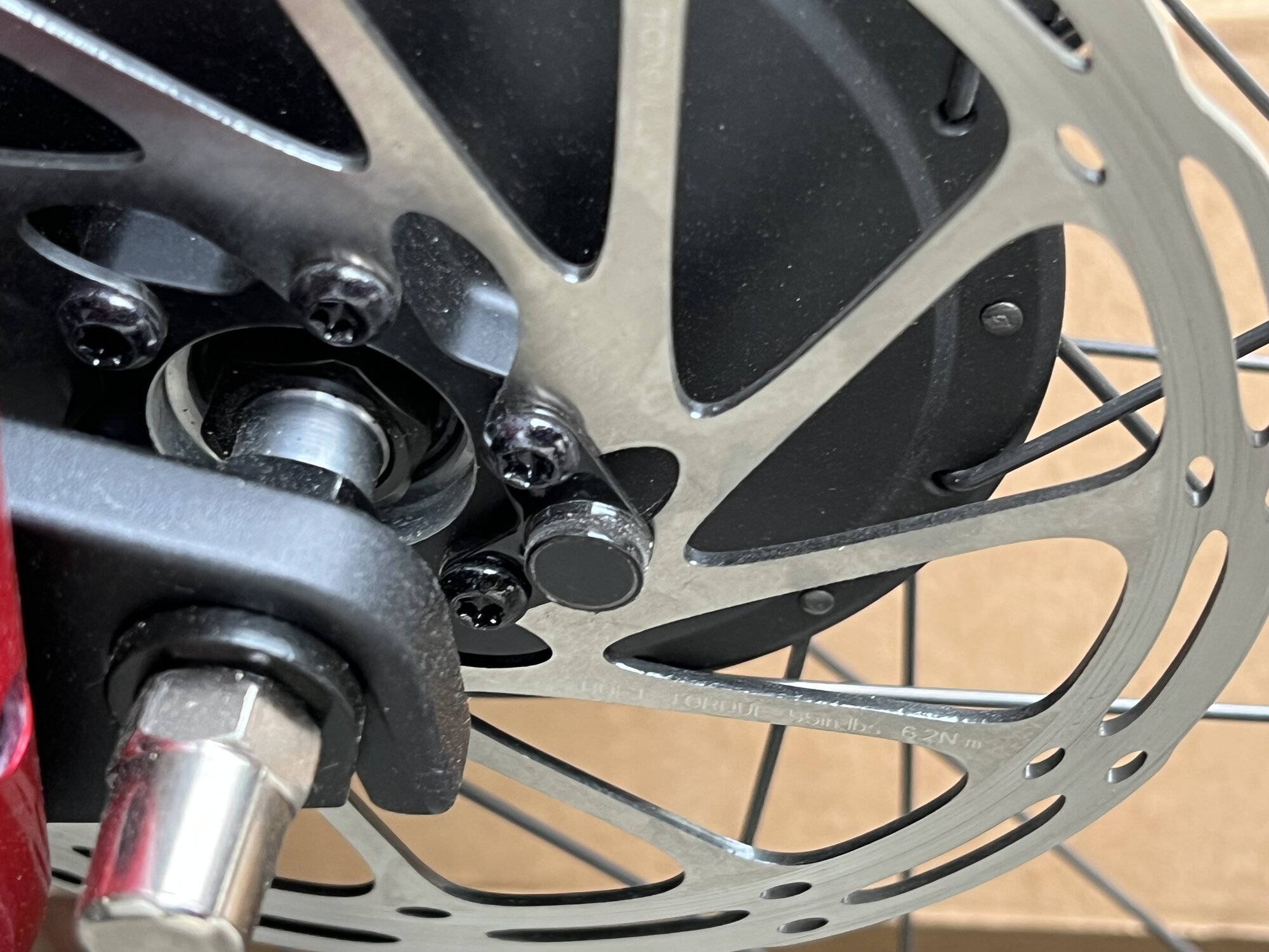

On my SL the magnet is flush to the assembly. On new it sticks out a bit. Not sure if that matters but being a proximity sensor - might.
I have given there as much technical info as I got - the magnet and sensor were on the rear wheel. The distance between them was the issue - it was a difference of mm, and before they adjusted it, I understood that the motor wasn’t usable for riding. They identified this during the build, so I never experienced it, and the info I’m giving here was what they described to me as they were working on it and when they delivered it. The magnet they showed me was a small round black one on the inside of the back wheel. I believe the image I attached shows it.
ah, that’s more like what the levo has; a magnet holder attached to the rotor itself. sensor must be in a different position on the frame too.
