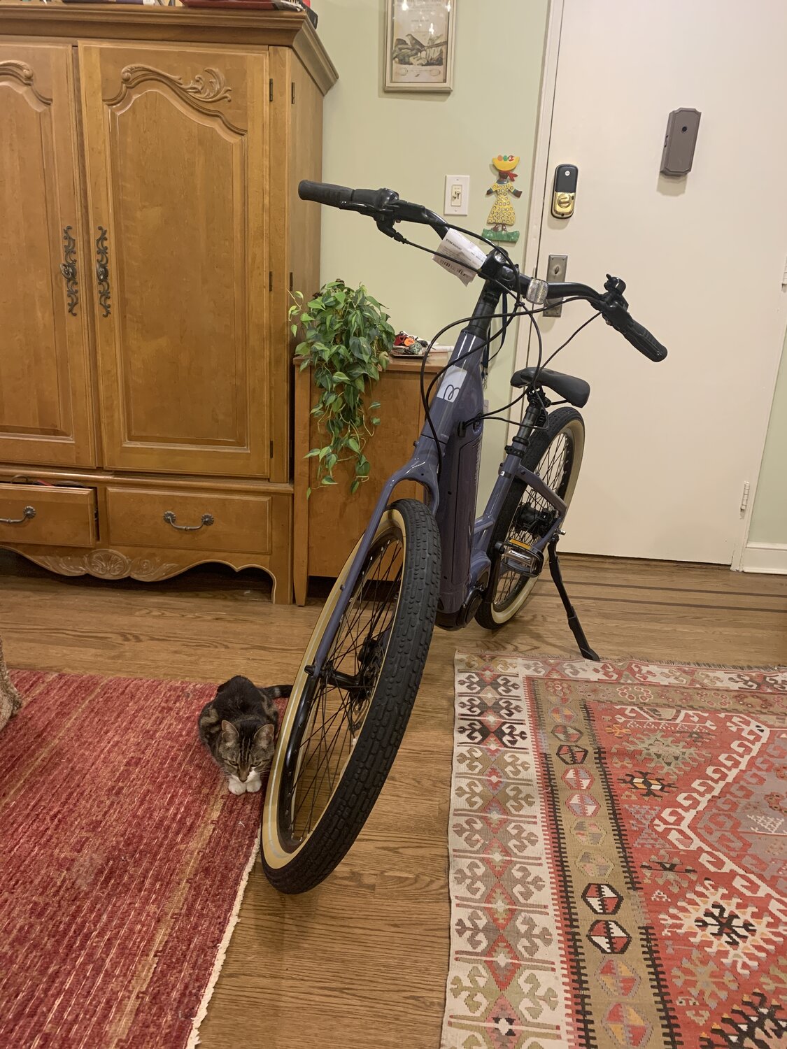

Very interesting. The bike pictured with 53 lbs is 2021 I have 2022 and I’m not sure if I have the same specs on motor and battery. Hope so but idk. Also the manual on your link is not the vida. Not sure why no vida Manual on momentum website. Odd!!!
And the on off etc button config is totally different. Not the best pic but all I have on my phone rn. And I did check my hi policy and yes no coverage for ebike. I’ll have to add. Lots to think about. Ty 🐨😃 my
