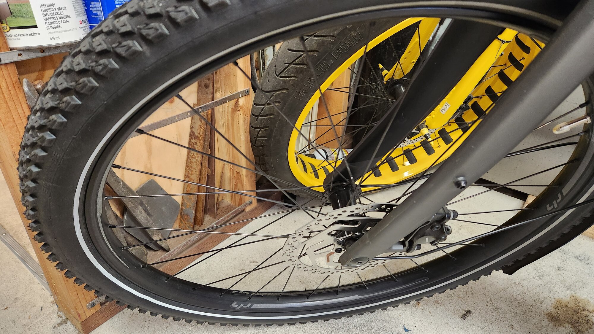

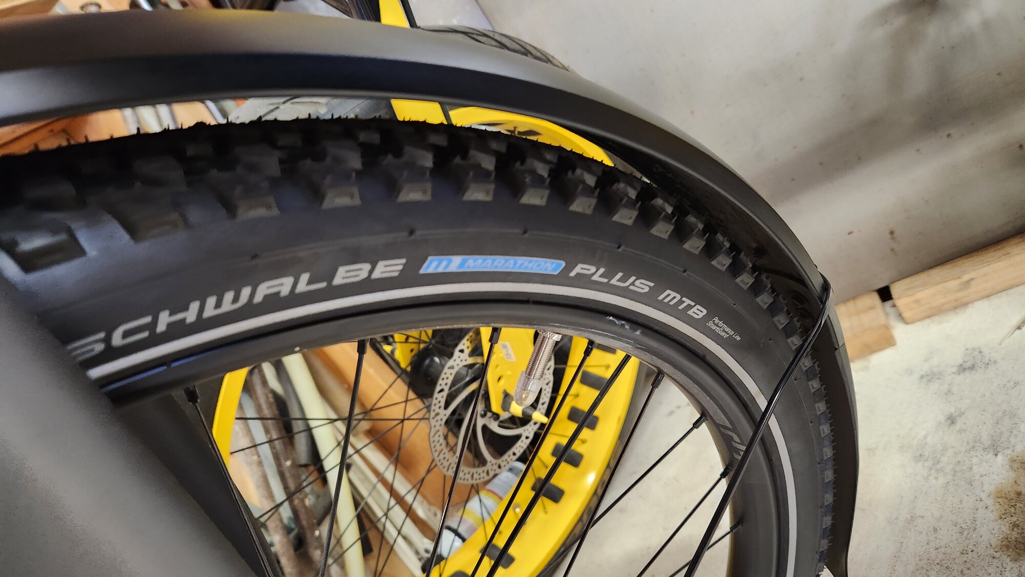

I haven't been around for awhile-still riding regularly though. My Como hit 2,000 miles yesterday and I was thinking about the new Schwalbe Marathon Plus MTB tires that I've had hanging in the garage since early Spring waiting for a flat to swap them. About 30 min later, on my way home, the rear tire gave out!
So today I installed the Schwalbes with new Air Plus tubes. They were extremely difficult to mount and I was forced to use zip ties and levers at the end. The rear gave me fits as it would not center on the rim, I tried deflating and massaging, over inflating, riding it while low, finally what worked was deflating and lubing it all the way around with Windex then inflating quickly.
I inflated to 45 PSI and I like the way they ride. They are a bit more square on the edges than the OEM Nimbus Sport 2.3s and I can feel that when cornering but it feels very grippy. That surprised me because they are knobby and the OEM are pretty smooth, I always thought a smooth tire was more grippy on dry pavement. I may try 40 tomorrow but I do weigh 215 and the tires are 2.25" (57mm) so I do think 45 PSI is appropriate.
Now to decide if I should add any goop. The main reason for these was the thorn protection they offer and the ride is better not having to use thorn resistant tubes. I am thinking the goop will only prolong the inevitable and you never know exactly where you will be when that happens. Fortunately for me my last 3 flats have been right near the end of my ride within a short walking distance of home.
Also took the opportunity to clean and lube the chain and cassette etc. and straighten a very slightly bent rotor that was starting to scrape.

So a dozen rides and tested at 45PSI and 40PSI, these tires definitely roll easier. I've beat my regular time and my average speed on every ride by quite a noticeable amount. Going from 45 to 40 didn't change anything except soften the bumps on the front. Here are my thoughts, 45 PSI is in the recommended ball park for my weight but I am thinking why not go with 45PSI in the rear and 40 in front? I could go 45 in both but it does make the front harsh enough to rattle the fender. The majority of my weight is on the back.
I also like a firmer tire in the back. No suspension.
I have Schwalbe Marathon (NOT plus) front and back, both 40 psi, but larger size in the rear.
26x1.75 front, 26x2.0 rear.
When I had 26x1.75 on both I ran 40 front, 45 rear.
