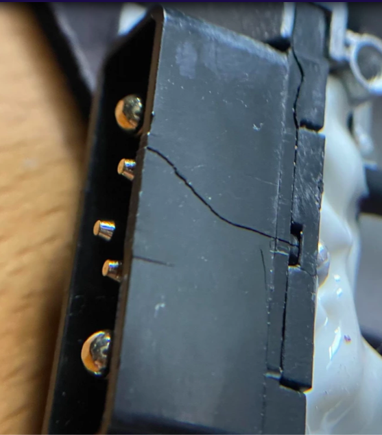

The battery connector is also broken, as you'll see in the pictures below.

  • The battery connector is to be replaced, right? (seller accept to send another one but with a $10 shipping fee)
Yes, it should be replaced but unless you can show box damage or some proof it's on them, you've discovered the disadvantage of buying from an Alirexpress reseller. However, if you're timely you should be able to make a claim with Aliexpress, PayPal, or whatever card you used. In the meantime, I'd seal it up on the outside with some silicon or epaxy paste and ride if lubing with silicon and oiling the freewheel quiets all down.

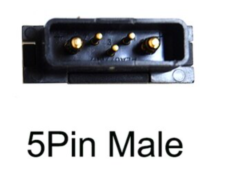

Grin, ebikes.ca in Canada, may have the part you need. Although it appears the 5 pin is now 6 pins and you'd have to replace both sides, or wait for China. https://ebikes.ca/con-dt-silvblt.html
They're all over eBay for about $10
It appears to be what some call a Hailong battery connector.
