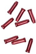

I just did red outer end caps crimps tips ferrules (60 for $9) and a crimp tool ($12) on Amazon.

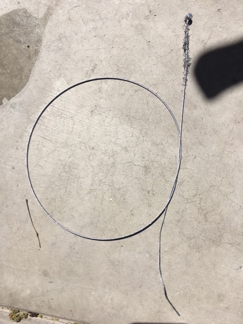

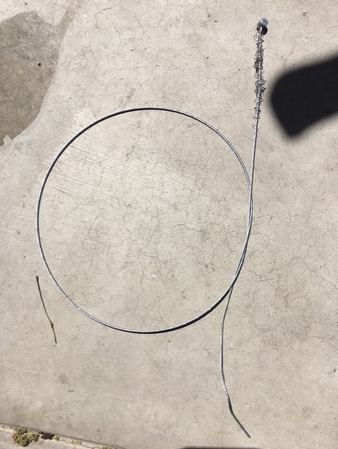

This is what my Rad brake cable looked like once I started to break strands from all my brake adjustments. The broken strands started to bunch up within the brake handle and acted like a spring. The brake handle wouldn't return to the normal position sometimes and engaged the motor cut off. All those strands were squeezed into a space between the barrel end and brake cable tension adjustment knob on the handle.

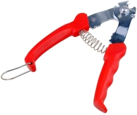

Do those cable cutters also have the crimp function?
Yes, the inside metal area next to spring are for crimping. You can probably do the same thing with regular wire cutters and pilers.
Crimp in this area:
I had exactly the same thing happen , the lever made a weird noise . At first I just thought it needed some grease.
