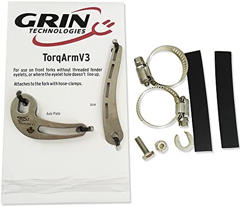

I've put front hub motors on 1. a huffy savannah from 1990? and 2. A 2017 yuba bodaboda (shown in avatar). Both front forks were steel. Neither was a problem on front fork durability. I've got ~8000 miles on the bodaboda. I had to grind out the slot a little on the savannah. Use safety glasses using power tools. I made torque arms 3" long clamped to the fork with a 1" strip of box fan shell. Use a worm hose clamp on torque arm at a risk of twisting your wire off. Torque arms were 1" bed frame rail stock drilled & filed to fit the flats on the shaft. I double nut the motor to keep it from working loose.

An aluminum force with stout torque arms can be a workable conversion. But I’d limit the motor size. That said my pal has a aluminum fork and 750W MXUS direct drive hub motor with two eBikes.ca torque arms.
5 years of city riding issue free.
