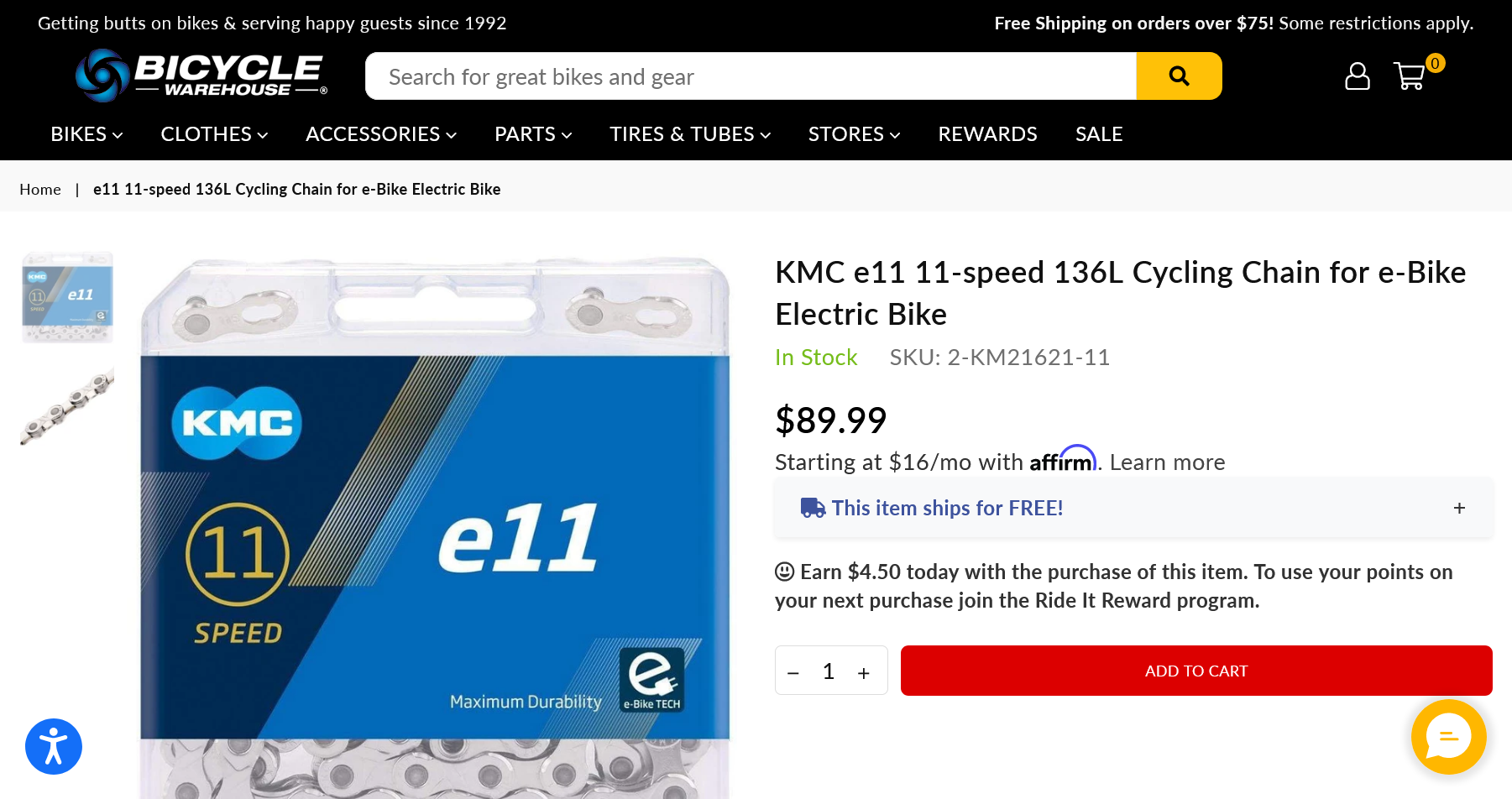

The OEM chain is a KMC e11 Turbo - so far the cheapest I've found is AUD$140...but I'll keep looking...
I get that eBike chains cop a harder flogging that acoustic chains, and I'm happy to replace chains sooner rather than later...
...any recommendations for 11 speed chains for ebikes?

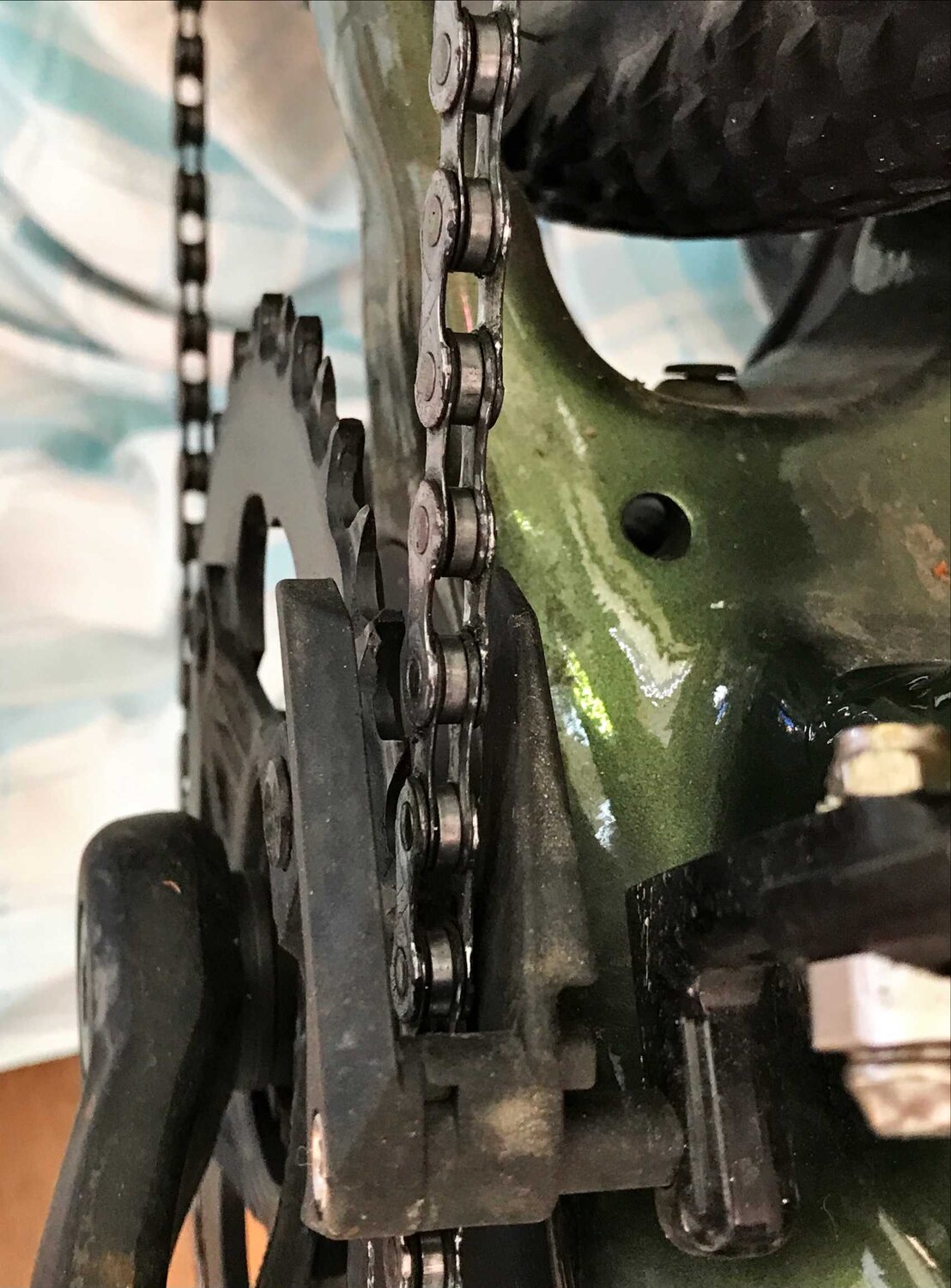

My current OEM chain ring is an FSA Megatooth 1X BCD104 42T narrow/wide chain ring.
I find on the commuting I do I'm always in the bottom half of the cogs on my rear cassette - so I'm looking to purchase a bigger front chain ring on my 1X setup to "share the wear" on the cassette...
...with each new replacement chain I would swap the front chain ring between the OEM 42T chain ring and a larger chain ring.
FSA supposedly make them in 44, 46 and 48 teeth - but with COVID etc they're hard to source of any size :(
There appears to be ample clearance on the chain stay to fit any size chain ring, and I can adjust/remove the OEM chain catcher...it's not required on a commuter bike with a wide/narrow chain ring :)
The only limitation I can see is if the new chain isn't long enough for a bigger chain ring - which would be unlikely.
The new chain I just ordered is 122 links long - I haven't counted the links in my OEM chain, but hopefully shorter.

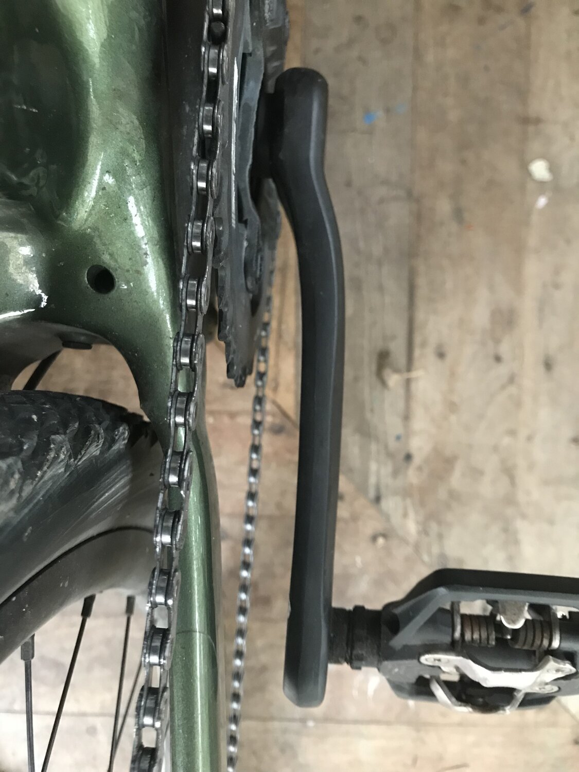

I managed to take a tumble off the bike yesterday in the wet :(
The usual bark off, but I'm OK otherwise...I felt a bump on the head, so time for a new helmet!
Riding away after picking myself up, I could feel something wasn't right with the left side pedal/crank...and after swapping the pedal today it was still wonky...
...and on closer inspection I've bent the left crank arm...
Attached are photos comparing left side with right side.
Left - note the continuous arc :(
Right
They're OEM FSA 170mm cranks - code: CK-745/IS, to fit onto my Giant Revolt '20 e-bike with a Yamaha PW-X2 motor.
Every Giant store I spoke with just wanted me to bring the bike in, unable to give any advice on sourcing a crank over the phone.
The FSA US site "appears" to have them but they're listed as a Bosch Gen 4 crankset, and all but the 165mm option is sold out https://shop.fullspeedahead.com/en/discipline/e-bike/crankarm/e-bike/fsa-ck-745-is-gen4-armset

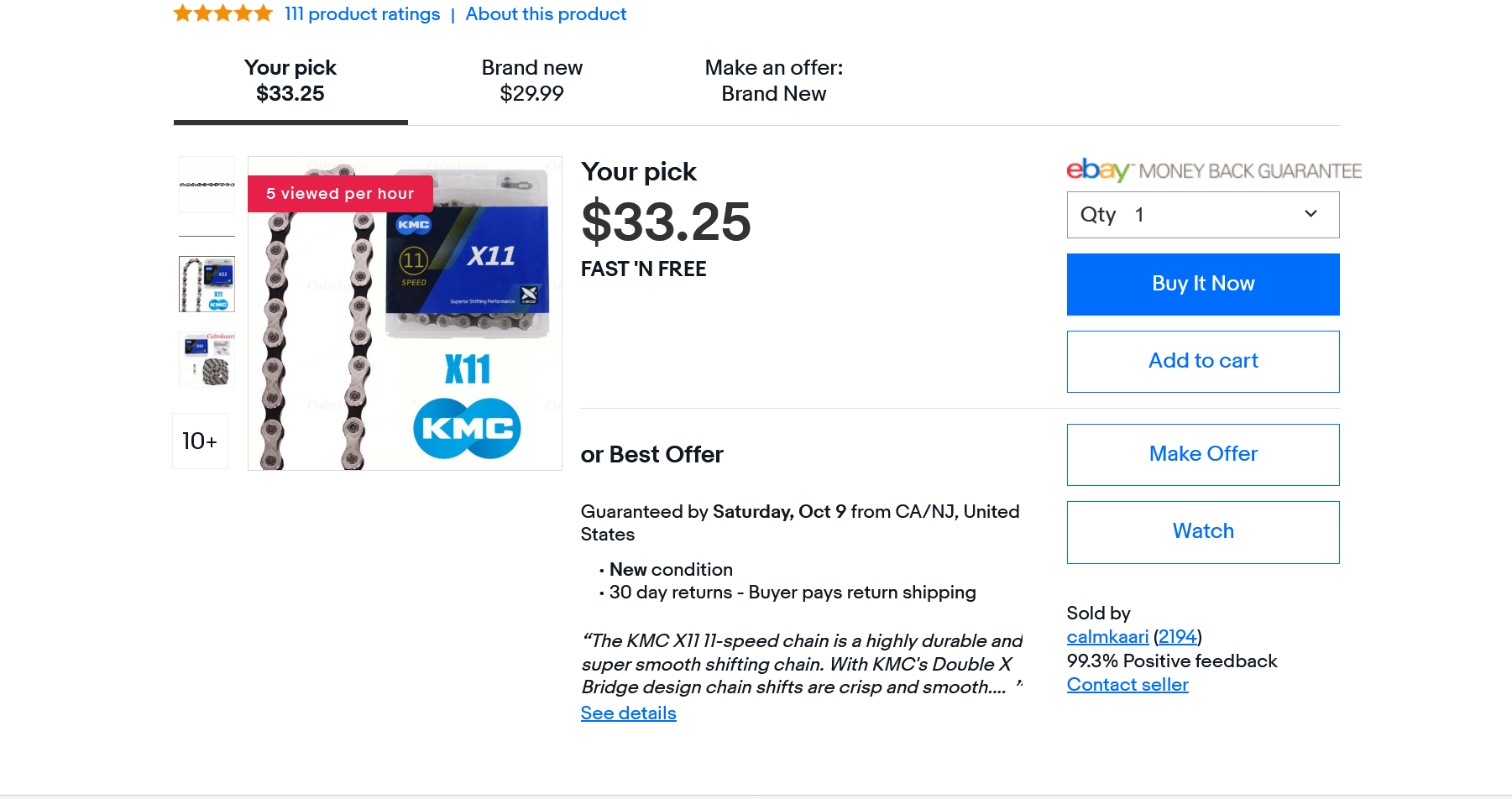

I've found an e-bay link in Europe https://www.ebay.com.au/itm/265371944319?hash=item3dc966857f:g:MOMAAOSwv5JiKimZ that says "FSA E-Bike Crankarms CK 745 B 170mm Isis Brose Bosch Cx Haibike Yamaha Cranks"...I've asked the seller what the CK745 B means...but encouraging that they seem to fit multiple brand e-bikes.
I'm fine to get both left and right cranks - hey I've bent one side, a crash on the other side could bend the other.
Any suggestions on sourcing a new crank or crankset that fits?
...I didn't crash that hard, so I'm a bit surprised I managed to bend the FSA crank...but I get that large forces are involved in a bingle...
...I'm happy to stay with FSA or change...I just need a crank/cranks that fit!
cheers
Mike
