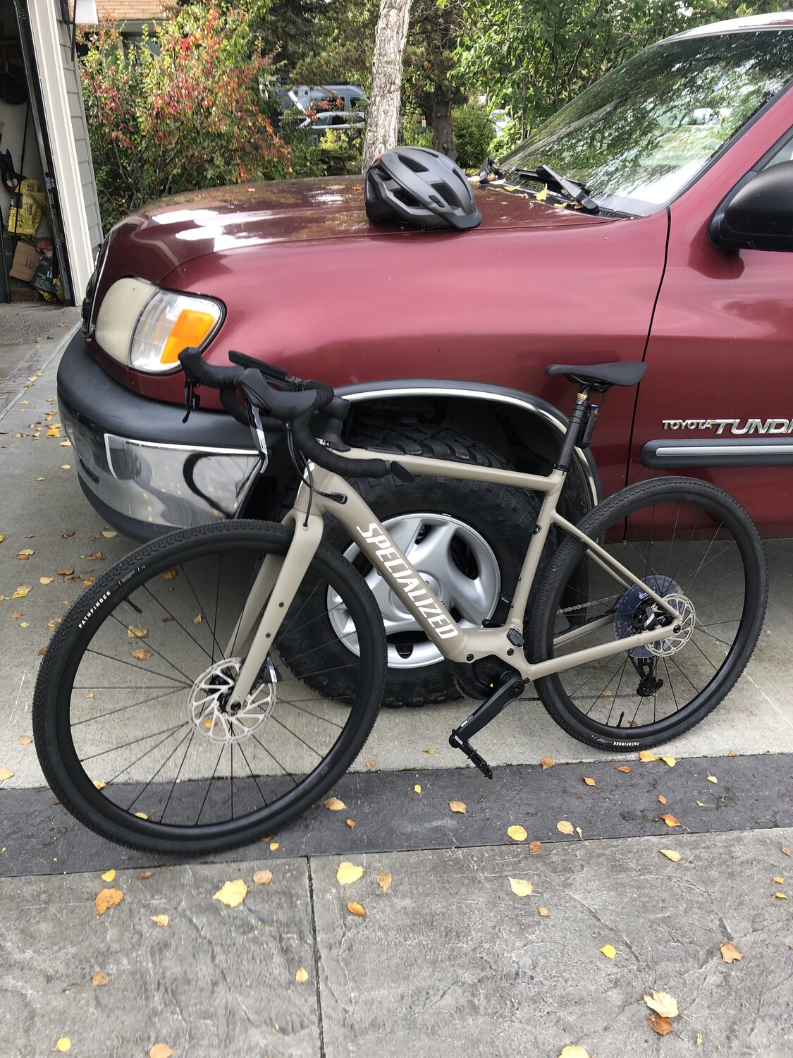

A few photos of my new Creo2 that I have had for a few weeks. I have not ridden a drop bar bike much in the last 20 years so it has taken me a few rides to get used to it again. I love the light weight and power of this bike, I was a little concerned with my muscle issues that I would struggle on the hills but so far I‘ve not had to use turbo mode at all. Battery burn is better than I had anticipated, did a 34 mile ride and used 56% of the battery, but that ride only had 700 ft of elevation gain. Unfortunately our season will be coming to an end in about 3 weeks, already had frost a couple of mornings, normally have snow about October 15. But it will sure be pretty to stare at all winter😄
I have not posted pictures before so I’m not sure how sizing will work out.

Gorgeous bike! If the Creo 2 Comp came with flat bars, I would have bought one instead of the Vado SL 5.0. Hope you get in lots of rides before the weather turns.

Thank you Jeremy, yes I too would prefer a flat bar bike, but the 15 nm difference was the deciding factor with my diminished physical condition. I'm sure Specialized will eventually put the 1.2 motor in the Vado SL, but unfortunately my timeline doesn't offer the luxury of waiting for this.
I will probably put some Speedrocker fenders on this winter and possibly an Ortleib Quick Rack (thank you Stefan) The LBS set up the tires tubeless for me at no charge, they roll great at 40 psi. I will also install a Redshift seat post this winter also. This bike was not my favorite color, but it was the only one available so had to roll with it.
Overall, I'm still buzzing on the new bike high like yourself:)

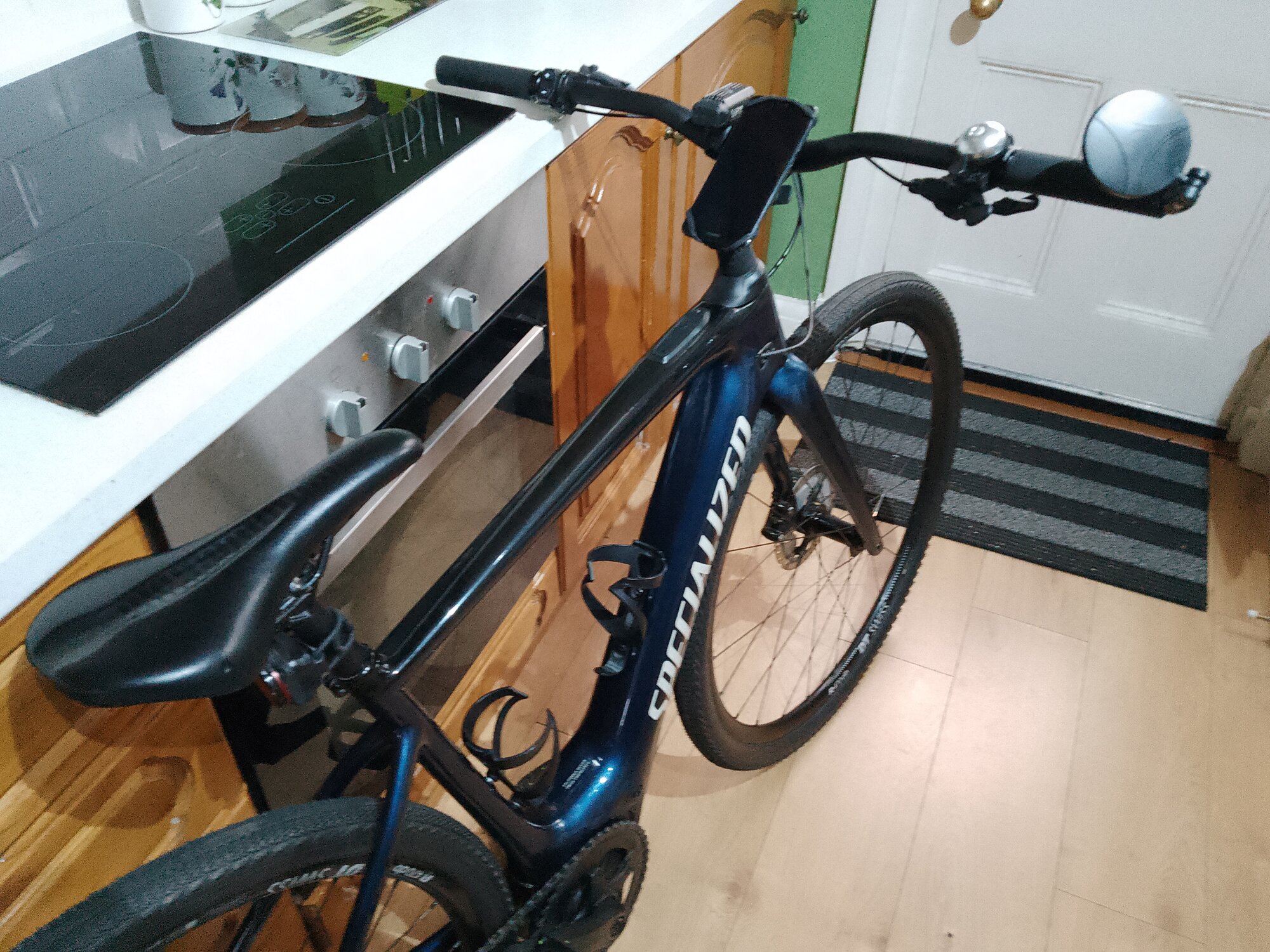

Just do a flat bar conversion like I did on my mark 1 Creo.
Yes I have considered doing this, brakes and shifters look easy enough, but not sure how to address the power assist selector, looks like you used one from a Vado?
I have a Creo SL Expert with 14000 miles and just got a Creo 2 E5 now with about 400 miles. I have the the fit set up the same as much as possible between the two but the E5 is still a little more upright. The Creo 2 E5 has slightly different geometry than a carbon Creo 2 and will be easy to convert a flat bar. The rear derailieur is X-shift so just need to add a lever shifter instead of replacing everthing. The Specialized SL system is modular so the swich from a Vado SL will plug into a Creo. It's currently one of the best values in their lineup.
Yes Vado assist selector on mine and XT brake levers which work perfectly with grx calipers. I have just converted a Pinarello to flat bar as well, I just find lightweight nimble short wheel based bikes so much better to ride.
Thanks for the information on the conversion Allan. I thought the 1.2 was slightly different physically (maybe wiring harnesses also) from the 1.1, so Vado remote may not be compatible. Although I think the Levo SL uses the 1.2 so maybe that remote might be plug and play if the wiring is long enough. Did you end up having to cut brake hoses or install new ones?

I did a little more involved mechanical to eTap conversion not a flat bar. SRAM is more compatible between flat bar and drop bar components than Shimano, so 'all' you would need is a left shifter, flat bar, a couple of brake levers (only come with calipers) and a S216800019 Specialized E-Bike Trail Remote 2. Looks like the SRAM S-300 flat bar levers with calipers are the same as the Apex so you may want to just switch the shifters. I don't know if the hoses will need to be altered for too short or too long. I use a Cirrus Kinnect seat post on both bikes. The aluminum frame is not quite as compliant as the carbon frame version but with the suspension seat post and 48mm tires I don't really notice it.
I looked at the link for the remote and it shows compatibility with the Creo SL but doesn't show Creo 2, might fit, i'd have to check with LBS if I decide to go flat bar. Thank you Allan for sharing your experience and suggestions.
If you pull the trigger, I'd love to hear what the conversion ends up costing you all told — and what did and didn't have to be replaced in the end.
The service manager at the LBS where I bought my Vado SL guessed $500 or so to convert the Creo 2 Comp, parts and labor. But gotchas always come up, and it's only a question of how bad the cost overrun will be.
