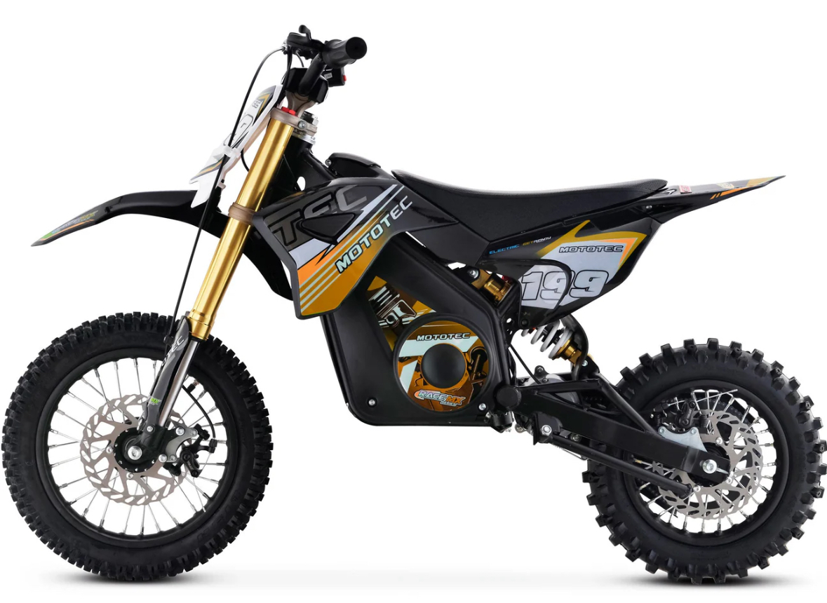

Hi folks, I’ve got my kids electric dirt bike and it came with a 36V 1000mAh battery which started to die out on us. I recently upgraded the battery to a brand new 36V and 1400mAh. I wired it all together, shows full power on the battery, sit on it and start to get it throttle and it begins to go but then suddenly and completely dies. Zero power, no lights on the throttle handle, nothing. Turn the key off/on and still nothing. However the second I plug in the charger to the battery then it will start back to full power (shows full bars on the battery power indicator). I go through the same thing over and over. I’ve fully charged the battery overnight, unhooking/rehooking back up the batter. If I lift the back of the bike and give it throttle it will be fine and I can twist it wide open with zero issues, however the minute I sit on it (or my kid), it dies after it starts to take off. What could be the issue?

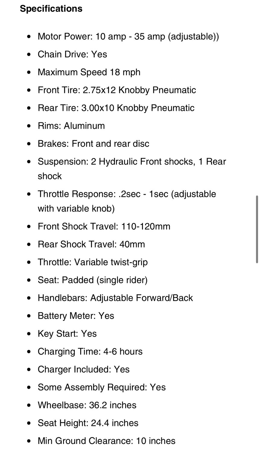

Thank you for the reply. Attached are pics of the bikes & the specs.
It has adjustable power knob and if the knob is kept on the lowest setting then it will work but the bike is slow. While I am riding it I can slightly increase the power too much then it dies(say power range is 1-10, I can turn it up to about a level 3 but then it dies). I haven’t touched any of the wiring in the bike, only connected the new battery.

I see your kid's bike can draw 10-35A. The battery probably can deliver only 10-12A, That's good enough for people with 250W Ancheer bikes, and those are the users giving it good reviews. In the bad reviews, two users said it only delivered half the advertised capacity.
To sum up, a mediocre battery and not powerful enough for 35A. You want a seller to tell you he's got a 36V battery capable of 30A discharge, That's going to require premium cells,
