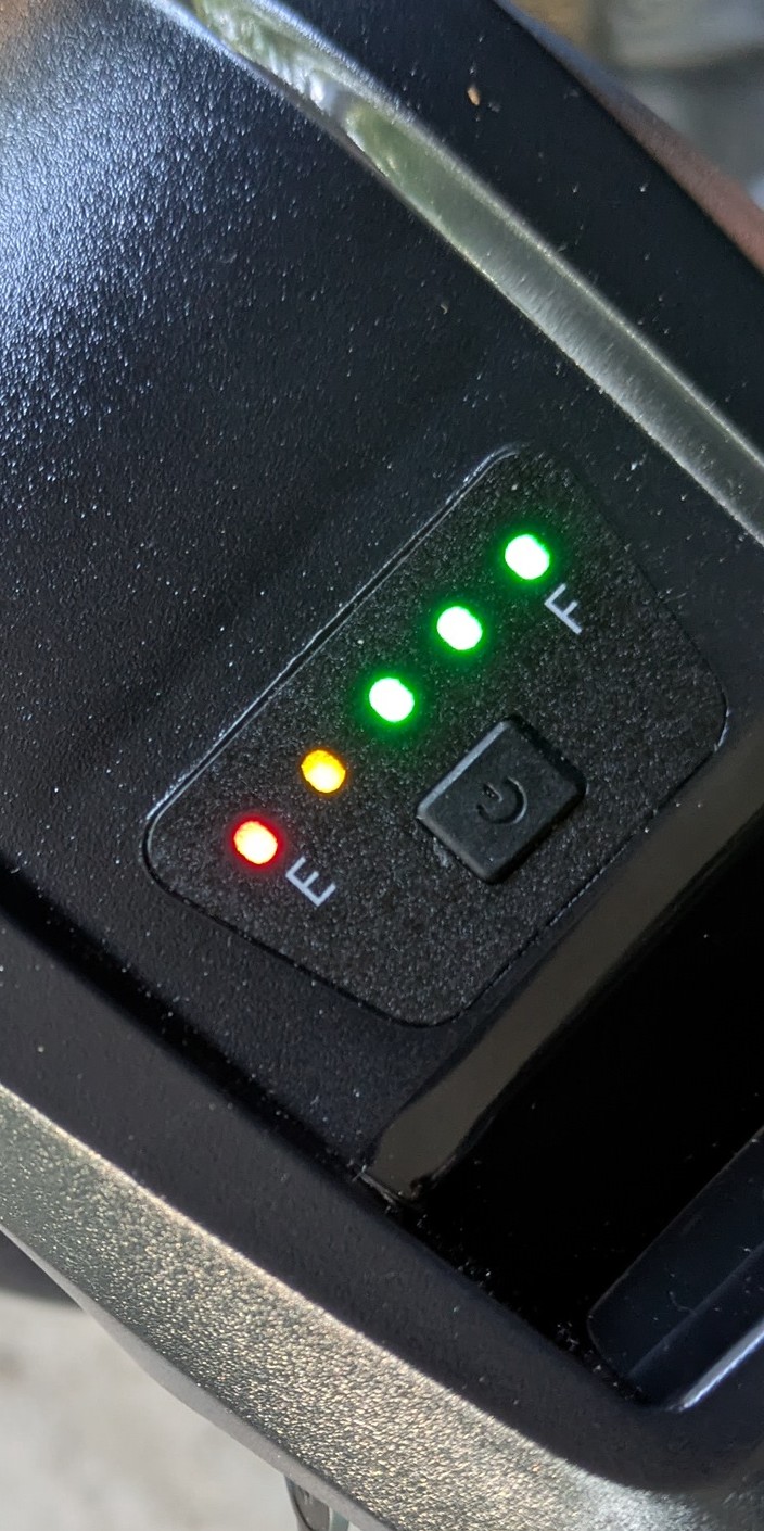

NOW ...When I charge the battery the green light on the battery cord shows green meaning the battery should be fully charged, but when I put the battery in the bike it shows three blocks of green lights from the full one block of yellow and one block of red on the Empty. I'm very upset because I haven't even riden the bike one time and the bike won't even start up because it doesn't seem like the battery is working correctly. I'm following the instructions correctly and the bike won't even start up. The LED screen won't even come on. Can anyone give me some advice on what to do? Thank you

There is an on/off switch on the right side of the battery, Hard to miss, but maybe you missed it, You got the battery seated so it can lock?

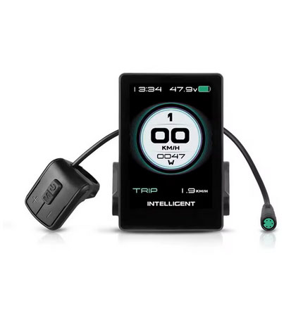

Pedaluma is talking about a round connector on the display cable. Follow the cable out of the display and it should have a connector like the green one in the picture. Make sure it's fully seated, It's a common issue on bikes.
It happens all the time. The bar comes in the box usually strapped to the right side of the fork and the display wire gets pulled open slightly. I am going to be honest with this and it is what I would say to a close friend. This bike is a waste of money at any price (unless you are staging one new scene for a new Jackass movie, that could be funny). There are always exceptions to every rule!

I finally got it started. Thank you
I finally got the bike started. Thank you
