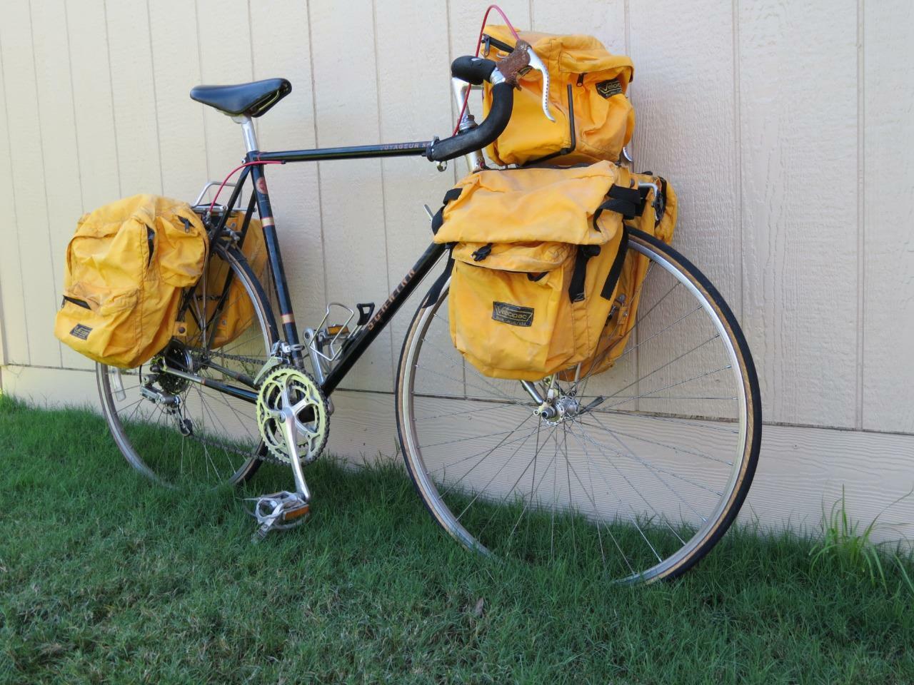

Take it to the next level and combine a front transmission with a low-range derailleur and rear cluster and now you've got a 21st century touring cycle.

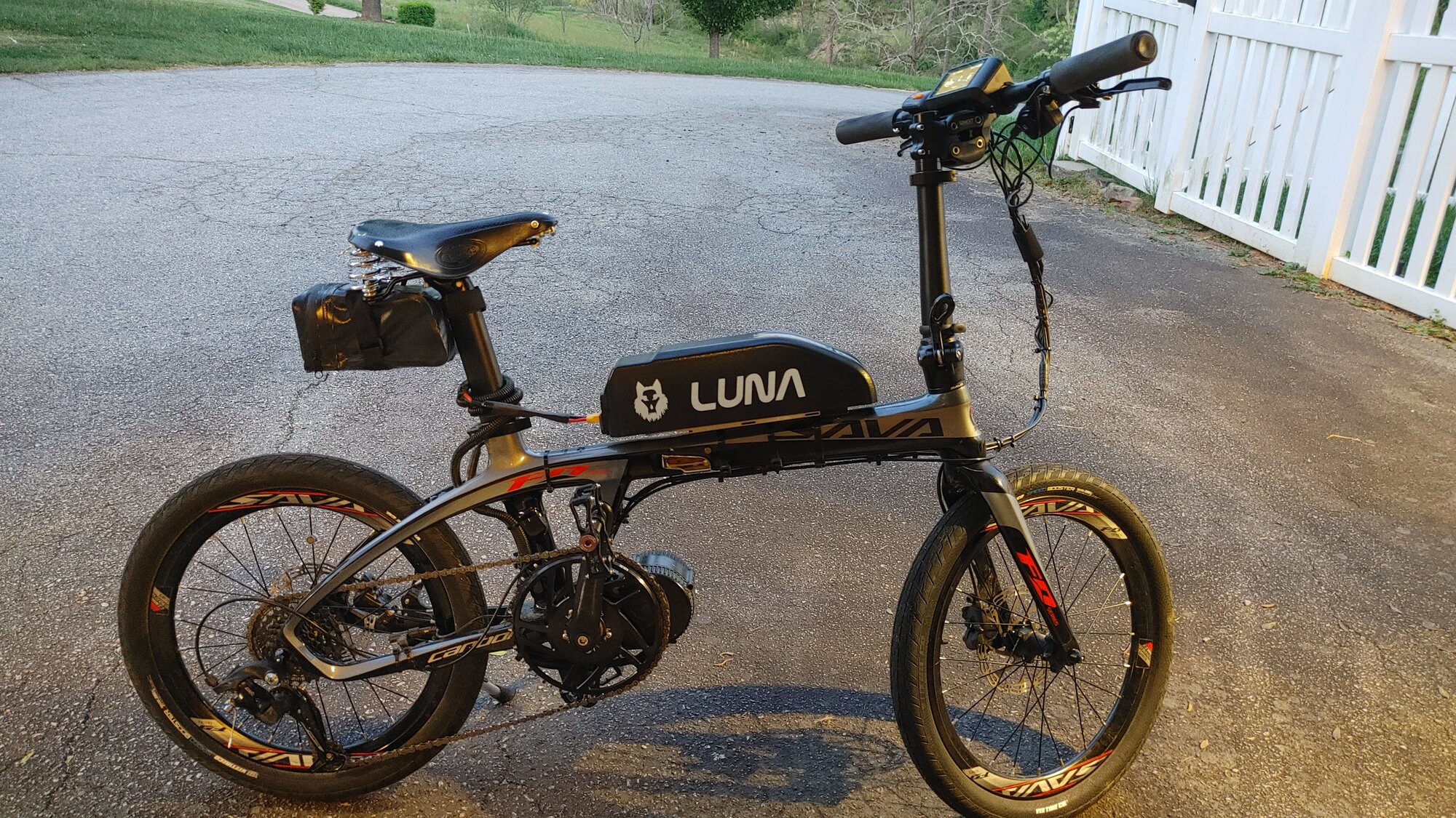

I had to run the chain-line with the smallest cog on my e-bike build. This eliminated all cog slippage on every gear. This goes against the standard middle cog chain-line on non motorized bicycles. Before that I had slippage on the 11 tooth cog even on flat roads under throttle power. After the chain-line was dialed in, it never slipped again. Even in extreme conditions, that I wouldn't recommend, was climbing hills under load using the smallest cog, it didn't slip at all.
My dream build would be a high end geared rear hub like a Rohloff style that was capable of handling the 120-160nm of torque of mid-drives. Then you could run a perfect straight line chain/belt off the front chain-ring. I ran a 52T front Lekkie BBSHD chain-ring modified to fit a BBS02 motor. I had to use 4 spacers as well to bring the chain-line out far enough. Then I ran the chain-line to nearly a direct line over the 11th tooth smallest.
Note* This is a custom bike and not a LUNA bike. The only part from LUNA is the battery. I've since painted over the annoying LUNA logo.

For exactly the same reason double- or triple-front chainrings have been used on road bikes more or less forever. In many if not most cycling circles 1x drivetrains are new kids on the block - and red-headed stepchildren at that - when compared to a traditional front derailleur and multiple front chainrings.
Doing a transmission on a mid drive would give back the range a bike loses with a 1x front ring, but we could keep the crazy-wide 1x rear cluster if desired. That opens up huge possibilities for configuration. Like for instance going completely in the other direction and bring back the straight block.
