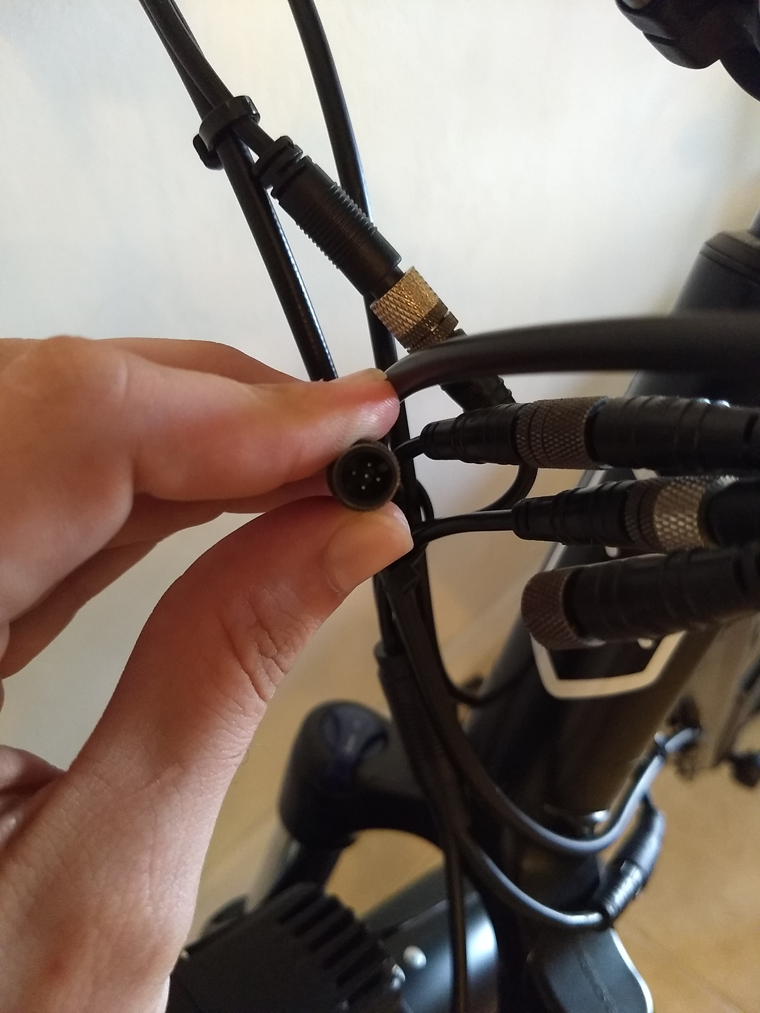

I think the pins on the display wire are different than the connectors on the plug. The Juiced display cable is 5 pins but in a shape of a 5 on a dice ( one pin in top left, bottom let, top right, bottom right, and center)
I THINK the wire there might be the 5 pin connector that is more rounded in the pin placement. If that makes any sense, I don't know the proper terms.

Take a peek at the connector from your bike and compare the pins to the one thats on the programming cable. They're not the same orientation.
This is what the connectors of the Bafang programming cable look like (picture 1 with the USB other end). Since I don't have a juiced bike, the LCD display should have 2 cables coming out. One for the controller and one for the throttle. The picture 1 below is the female connector end. When you disconnect the cable from the LCD display it should have a male part like the green one in the 2nd picture (the one that has 4 connectors 3 yellow and a green). Maybe if you take a picture of the juiced bike LCD display connector I can help more. In any case, even if they don't have the exact same connector, they certainly have 5 pins and since they use a bafang motor those signals should be the same. So in the extreme case we'll just need a connector adapter. But just post a picture so that I'll know what you are talking about.
Show me a picture of the female part (the other end than the one you are holding) of that connector to make sure it goes to the LCD display and not something else. By the way, that 5 pin connector is still a Bafang connector that combines many of the signals you need. I just never seen it on an LCD display that's why I need to make sure that is connected to the LCD display and ONLY the LCD display. Thanks.
this is the cable going to the LCD on the RCS. If you need a better pic ...
