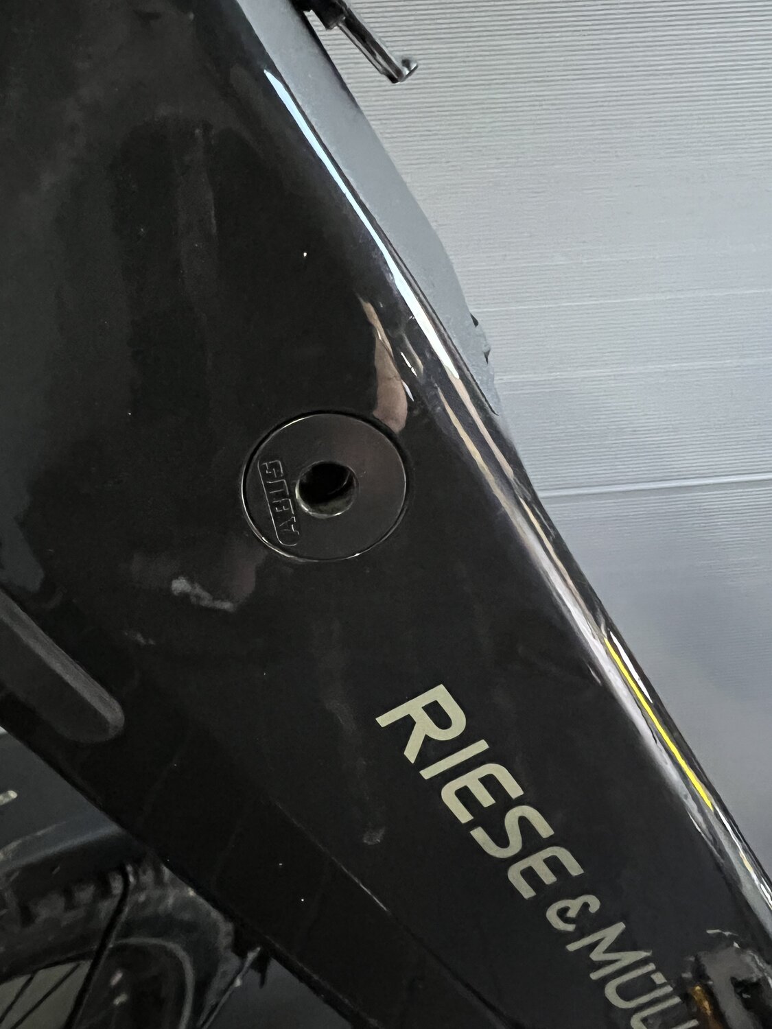

Can anyone advise as to remove the Nevo 3 battery lock for the Bosch PowerTube battery.
My Apple AirTag has got stuck behind the lock, the battery has gone flat and I can’t get to it.
Many thanks.

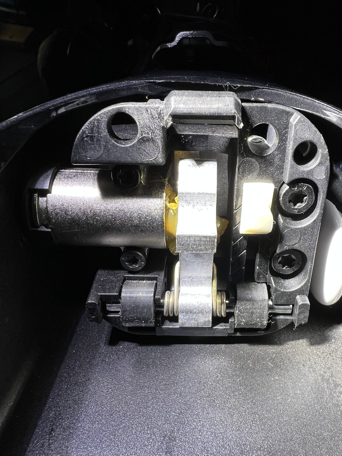

All done.
Lock out.
AirTag retrieved.
Lock re-fitted.
AirTag relocated.
DG…
they must use a different lock then most bosch batteries. those need some fiddling to make it right or a jig.
It was fairly straightforward, once I used the correct screws.
This is what it looks like.
The two big Torx head screws on the right are what holds the lock in place and they only fit one way, with no means of adjustment.
