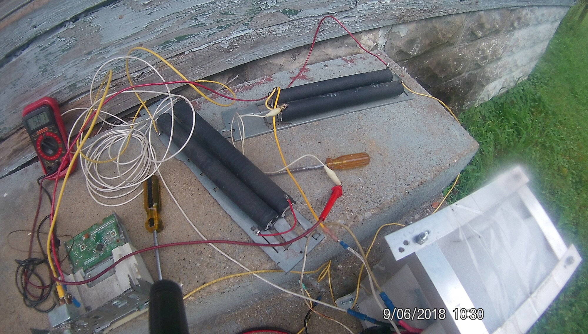

You can test your battery with a 15 ohm 750 W resistor some alligator clip leads and a DVM. Charge up, put resistor on. Battery should produce 3 amps for hours. 10 ohm will test at 5 amps. 5 ohm will test at 10 amps but 750 watt resistor will seriously heat up.
Log resistors come from newark, digikey, or sometimes cheaper, electronicsurplus.com surplussales.com or apexjr.com I bought a bunch of 5 ohm 250 w dale resistors for $5 each plus freight, years ago. For audio amplifier testing.
The green computer board in the picture just mounts a 20 A on off switch. THe battery in aluminum angle in the picture was garbage. Didn't get my money back from e-bay; took more than 31 days to prove it was the battery, not the motor or controller. Had to transport battery 27 miles to town in a bad headwind to where I had test resistors clip leads DVM & switch.
