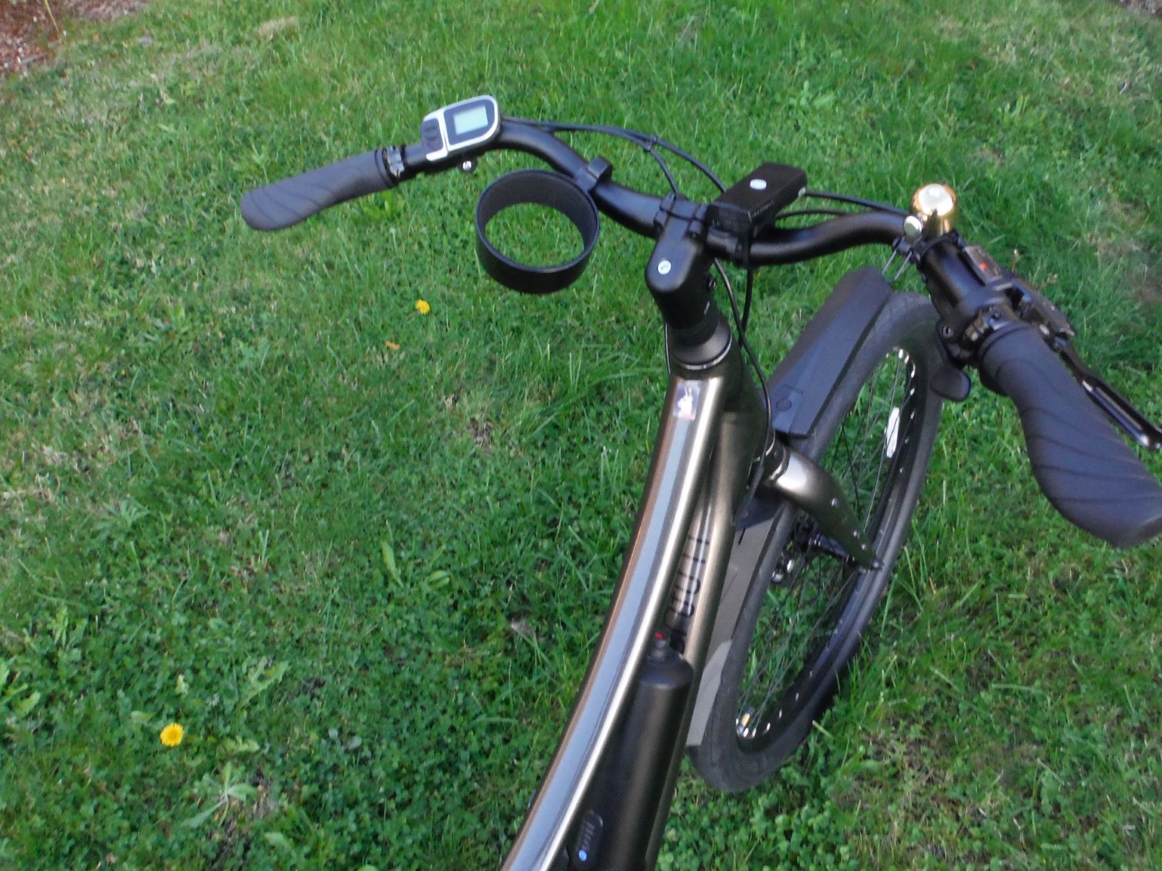

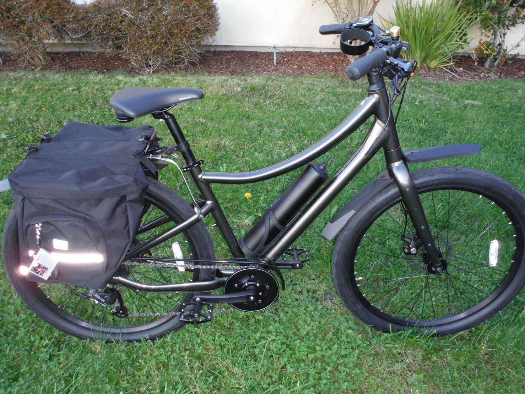

I like how in Eugene all adjacent parking lots are interconnected. In places like LA there are chain-link and other barriers between parking lots. You are forced to drive from one to the next. In Eugene you can just ride thru all the parking lots, avoiding traffic. Or park at one place and walk to four. It is weird for a Californian that I am not qualified to pump my own gas in OR. At least I can charge my own battery. Here is a bike I just put a comfort bar on, rack and panniers. It is 750W with a torque sensor, and a 90Nm dual clutch cargo grade mid-drive. Today we have those little yellow flowers that others dislike.
