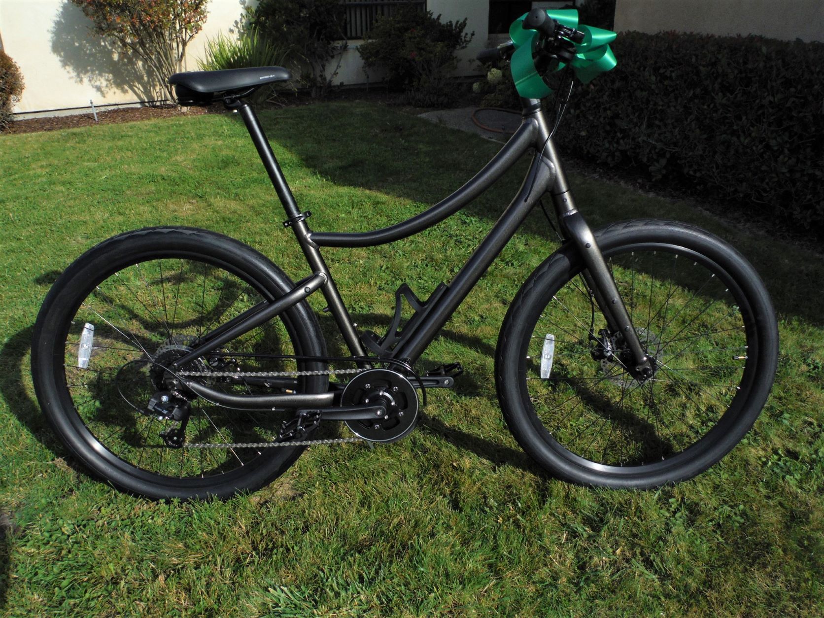

Ask @tomjasz and @M@Roberson. 750W is legal. And can prevent over stress. Torque sensor systems have much more feel than Cadence only. I happen to do this locally only, daily. Mid-drives kick A5S. Here is a recent build with a cargo, twin clutch motor on a comfort comuter bike. It is getting a rack, paniers, and relaxed HB this week. The battery fits in the 'water bottle' cage. Non-proprietary! That is what eBikes look like. Not much. The starter bike was a Giant Vida. Fat has big downsides. Don't go there.

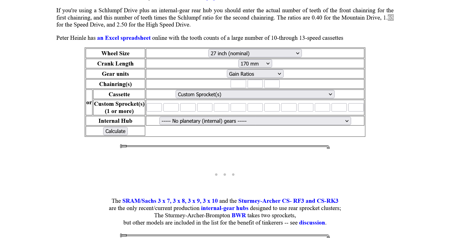

Is there a site where a person can learn about changing the crank/cassette gears/ratios?

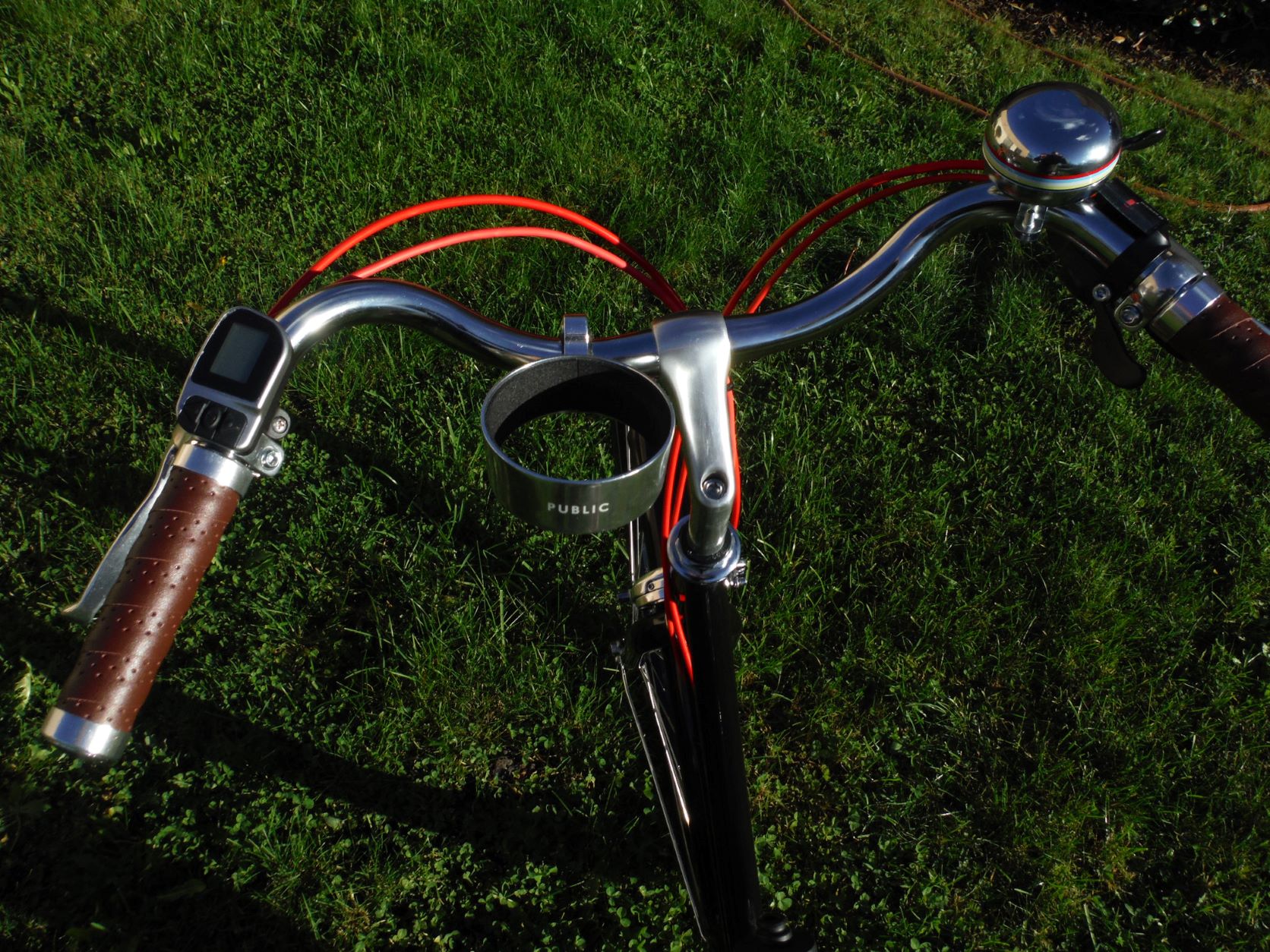

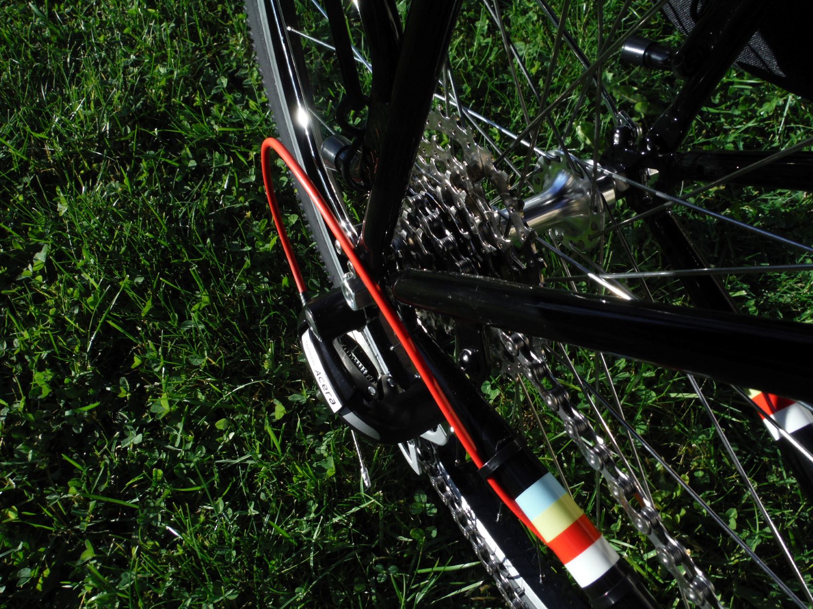

Thanks Kevin! I purchased this bike late last week for $449 new. Now it is a 36V 350W with 85Nm of torque. Was 7-sp, now 9.

I have seen those bikes. A generic cluster of gears in the 11-34, 36 range is something like $35 on Amazon. A generic long cage derailleur is $32ish. Stick with a 36 ring or even 42 to get a 10mm offset so you can hit first gear without dropping the chain. Otherwise it will be cross chained and won't climb.
