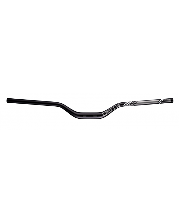

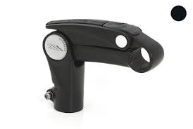

I used a similar approach to reduce my wrist discomfort. In my case, I used these products:
31WeU5NCxcL.jpg Hi rise BMX bars with a 15 degree backsweep
31q0nU6bIxL.jpg 6" stem riser

I rode with straight bars on my MTB for years before discovering that swept back bars are more comfortable. I tried the cruiser type and found the 45 degree back sweep just made the problem worse. I settled on the BMX style with a 15 degree back and 3 degree down sweep. Personally, I think a 20 degree back sweep would be ideal but so far, I haven't found a bar with that configuration that is wide enough for all the e-bike controls.
Raising the bar height transferred some of my weight from bar to seat which also helped.
