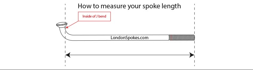

Never got a new wheel, but I did replace a few rear spokes over the past few years. A good source for me was wheelbuilder.com for spokes. Really easy to replace a spoke.I have the ride 1up Roadster V2 for 11 months now, did anyone find a rear wheel seller, looking through the forums, just noticed one off my spokes is broken.
